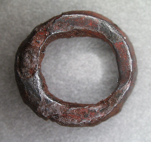

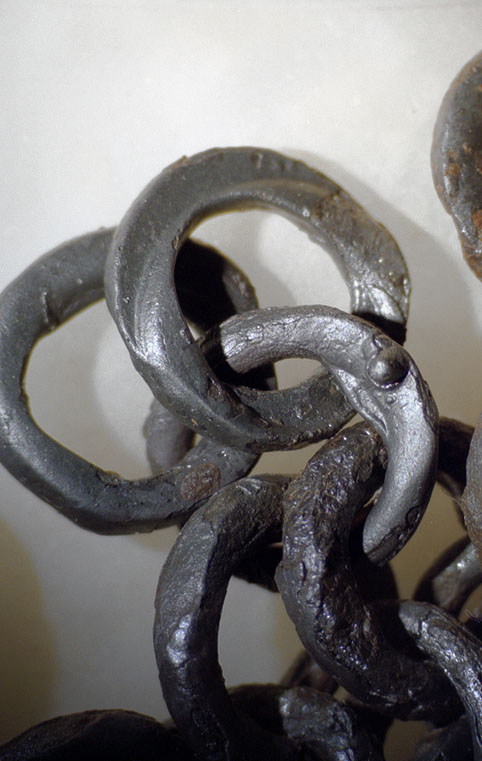

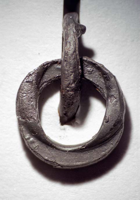

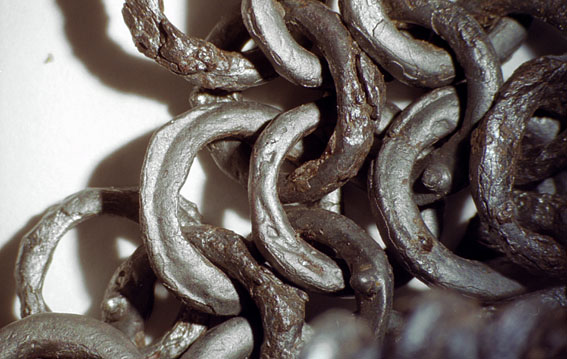

You have done good work developing the punched ring prosess for the gjermundbu mail Johan. Interesting to see the presentation here. There is one detail of the process that I was not aware of when i wrote my little paper "Brynjevev/Ring weave". I discovered it during later studies. I will share it with you here shortly so that you have the opportunety to perfect the prosess.
Andris Auzins wrote: | Johan Gemvik wrote: |
One new detail Niclas got from Vegard was that the rivet dome has a double bulb, one on top of the other......
.....Incidentally I found several of my own riveted links have the same shape. I've been trying to work that off them, but clearly I shouldn't. In fact when I make my next riveting plier set I'll make two, one with a large dome for first stage crimping and another second one with a smaller recess for second stage to shape the top bulb. |
I don't get it - what is so special about the double bulb? I believe it happens when the dome created by piercing the ring differs from the depression in the rivet setting pliers. I also get this effect constantly when I use my older pliers that have some wear in them. |
I agree with you Andris, there may have been a misunderstanding. The double dome is not the result of setting the rivet twice with two different sized peening depressions. It is the result of the hole for punching/drifting beeing slightly larger in diameter than the depression for the peening of the rivet. The rivets used for the gjermundbu mail is almost round in cross section (and somewhat conical in shape). The hole for punching/drifting has therefore also been round.
There are also other interesting toolmarks on the rings. They are not present on all the rings (that includes the double dome), and are not equally common, but they can be found frequently on the best preserved riveted rings from the gjermundbu grave find. (By the way. Notice the backside of the rivet area. The rivet is flush with the ring material, and there is no visible transition between the metal of the ring and the rivet. This quality is quite common on period mail as I can remember, but few are able to reproduce this today, so we are doing something wrong).
Attachment: 133.38 KB
Toolmarks on riveted mail rings from the gjermundbu mail [ Download ]
Attachment: 207.55 KB
Riveted rings, gjermundbu mail [ Download ]

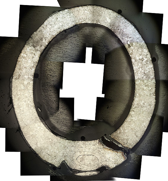

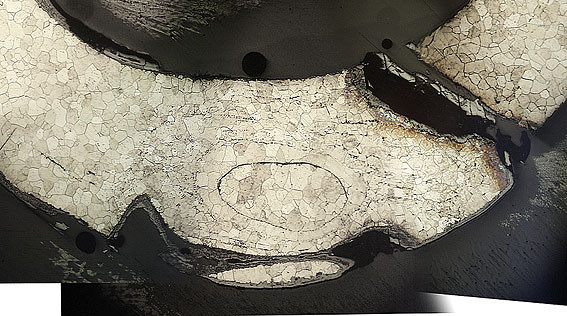

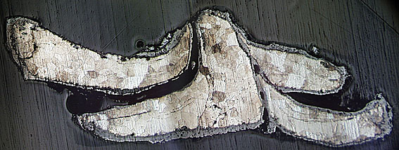

Here is a picture of a riveted ring from gjermundbu that I made a section of, then a closeup of the rivet on the same ring. The third picture is a tangential section of the rivet area of another ring. As mentioned before the rivets are slightly conical in shape, almost round in cross section.
Attachment: 128.64 KB
Section of riveted ring, gjermundbu mail
Attachment: 95.32 KB
Closeup of rivet area, plane section of riveted ring, gjermundbu mail
Attachment: 75.09 KB
Tangential section of riveted ring, gjermundbu mail
Dan Howard
Posted: Sun 28 Aug, 2011 3:31 pm Post subject: |
Oh that is wonderful Vegard, many thanks for sharing.

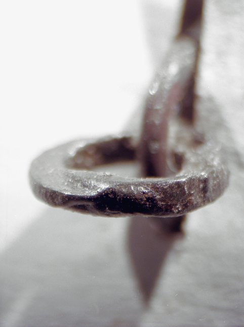

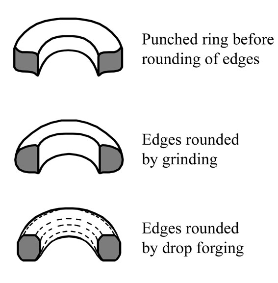

Then on to the punched rings. The rounding of the edges on mail rings after the punching generally may have been done by grinding them down as you have described doing Johan. Arne Jouttijärvi, myself and probably others have come to that conclusion, and have refered to the illustration of the ringmaker from the year 1425 in Das Hausbuch der Mendelschen Zwölfbrüderstiftung zu Nürnberg. The ringmaker seems to be a general ringmaker, and not spesifically a mail ringmaker, so it is open to discussion though.
After writing my paper on the metallografic studie of three mail finds, I took a closer look at the gjermundbu mail, and found out that the rings had not been grinded, but where instead rehaped after the punching by a sort of dropforging. What gave it away was some faulty rings, especially one in particular, that had been put a squew into the shaping/dropforging tool. I think I have to give you an illustration of this, and in addition som pictures of the faulty ring, hopefully it will explain it.
Attachment: 61.91 KB
Rounding of edges on a punched ring
Attachment: 66.02 KB
Punched ring of standard form, note the rounded shape of the edges both on the inside and outside.
Attachment: 84.5 KB
The faulty ring
Attachment: 52.53 KB
The faulty ring. Closeup.
Attachment: 176.1 KB
The faulty ring, seen from the edge.
Attachment: 81.3 KB
More faulty rings.
Attachment: 73.09 KB
Punching and reshaping/dropforging [ Download ]

I'll also try to make a plier or similar tool that actually gives the #5 mark at the rivet overlap. I have a leatherworkers plier that I can easily adapt as it has a removable joint screw. Much easier to get at those inner surfaces that way and it's hand forged so it looks nice already. I'm also thinking the plier jaw surfaces may need to be flat bottom and slightly concave top to get the right look as seen in the photos.
I'll give it a try and see how that turns out.
Could the #4 mark be from the rivet pressing tool? I don't see it on all riveted rings just some and so I'm guessing it could be the second pressing that sometimes does it if it's a little misaligned and the edge of it touches the ring.
