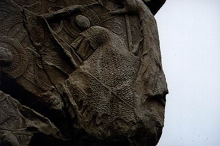

It is childishly simple to find evidence of mail dating before 300AD. The trick is pinning down when it was first used. Nobody who has done any research at all on this subject can reasonably claim that mail didn't exist before 350AD. On top of the extant examples mentioned by Erik there is a multitude of iconographical evidence.
This particular one dates to the first century BC.
http://rubens.anu.edu.au/student.projects97/a...e/MA1.html
This was the hamata found at Arbeia
http://www.romanhideout.com/images/UK/SouthSh...Hamata.jpg
How about Trajan's Column. Most sensible people acknowledge that it was commissioned before 300AD.
