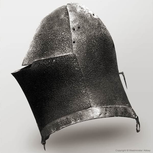

Hi Folk`s
Has anybody got an idea were i might be able to source views of the Henry v froggy ?(besides going to the museum )
I`ve got the usual profile photo`s, but nothing that would give me a definitive idea of the top .
I also need info on the actual beak ,I.e. does it have an internal fold back on the top edge like later Froggy`s ?
This is my first post on this forum ,please be gentle with me Wink

Jerry,
The helm does have a small rather curious plate at the top. I say curious, because it is so crude that it almost seems to have been done almost as an afterthought. Though other helms have this plate as your picture shows, this one is quite small and extremely crudely attached.
Unfortunately, I do not remember if the front top is turned back or not. However, the helmet does have an additional piece attached to the front, this is not readily apparent in your picture, but it is obvious from the other side.
If you speak or write to the picture librarian at the Abbey they can sell you prints of the helmet...... at a price!

Russ,
The last resort was to contact the Museum curator .
I`ve never had much luck with these museum requests .You ask but they just ignore .....I suppose there far to busy !
I had noticed the reinforcing plate .There is a distinct line on the other profile .Quite interesting that it only comes half way on the right side and covers completely on the impact side ( by the looks of things)
Russ ,the other thing is the small plate on the top ? Maybe a repair at a later date? You also hafto remember it was mostly covered with a crest tied on through the bullet holes around the top ,sorry i should re fraise that ,The Pick holes ,after all it was the 15th century .

Jerry,
There are others like this that only have the reinforcing plate covering part of the front, see the Prankh helm for instance. Of course for the joust only the left side really needs to be reinforced anyway. The helm is rather heavy anyway, so they needed to cut down weight wherever possible. It is about 1cm thick on the front left , and weighs some 17lbs!
I had thought about the possibility of a repair. It seems a good possibility, especially when you see the inside of the helm and how it was done. Possibly it was a damaged helm anyway, and of no further use and was repaired just to hang over the tomb - if it ever originally hung over the tomb? As a precedent for the use of repairs and tricks like this in funeral achievements, the crest of the Black Prince helmet in Canturbury Cathedral, Kent, the cap of maintenance supporting the crest was entirely made out of tiny little scraps of leather sewn together. Possibly someone thought that they could save a bit of money by doing this. The labour was the cheap bit, not the leather. And he was dead anyway, so he was unlikely to complain! This little trick was not discovered until the replicas were made in 1952.
By the way, there is no actual evidence that it in fact was Henry V's helm, but it was however hanging there in the 1950's. There is no evidence that the sword was his either, unfortunately.
The Abbey are very protective of the helm, so it is quite doubtful that you would get to examine it. David Edge told me that it took him ages just to get permission to use the picture of it for his book! It is many years since I got to examine the helmet, but at that time only A.V.B.Norman, and Howard Blackmore had been able to examine it in living memory. Possibly others have done so since, but not that I know of.
As a little aside, 'Nick' Norman told me that when he examined the helmet he in fact couldn't resist "very unpfofessionally" putting it on. He swore that he could see the fields of France through the eye slit! Laughing Out Loud

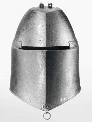

Ha Ha I was right .thank you so much Doug .
Russ ,my conclusion of the really bad patch up job on the top plate !
This is of course all subjective and only a thought .Maybe i should highlight that statement lol
The hawberk helm gives the clues away .
Same era helm ,infact i would go as far as to say modeled of the Kings helm (possibly) not having any other views of the Hawberk helm .i'm surmising its the same shape .
The manufacturer of the Hawberk helm made the facial section out of one piece of heavier materials so as to not hafto need the reinforce .Each helm also has the same series of punch holes around the bottom edge for affixing the lining .Same pattern of crest lacing holes around the top area .
The top of the Henry helm "maybe" originally had similar crest mounting knobs as the Hawberk helm .
At Henrys funeral his crest would have been still mounted on the helm .This we are of no doubt.
At some later date the crest was removed ,maybe because it was looking very tatty who knows .Maybe the helm had fallen from its mounting place at some point and the crest and its mountings damaged .Instead of repairing it it was just discarded along with the bent /damaged mounting knobs/top plate .
The helm was rehung and at this stage the top was dogedly replaced and the iron hook at the back affixed .
I have read ,The Hawberk helm is in the Armouries and a copy is at Cobham church .Any idea who made the copy ? and if it was ever published .

Here is a larger view of the Hawberk helm, on loan to the Royal Armouries (as is the Baybrook helm):
From our article Spotlight: The Great Helm.
I hadn't heard that a copy of the Hawberk helm existed. I'd love info on it and pictures if anyone has them.
