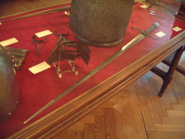

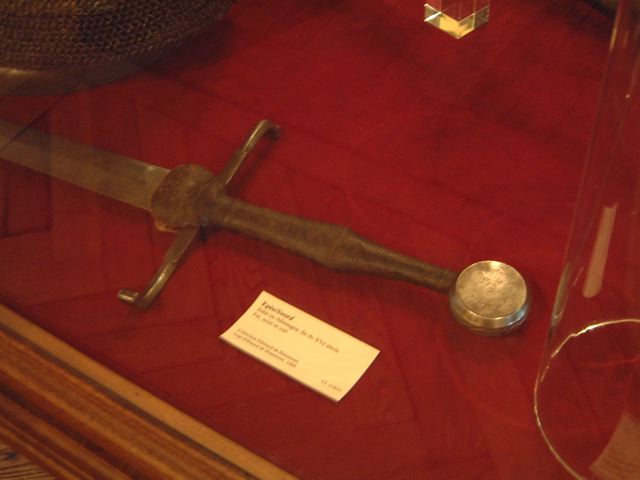

Anybody know any information about the sword in this picture?
Supposedly it is in the Museum Cluny, Paris, France. I'm trying to find out more about its background; construction, who it belonged too, stats, more photos and all of that. It made it into a museum and appears to be in good shape so I'm thinking it might have a bit of a tale to tell and I'm curious whether anybody knows anything about it around here.

I zoomed in on the card next to the sword and I can read: Italian or German sword 15th century in French.
Smaller and almost impossible to read I can see something about what collection it's from but can't quite make it out.

BTW...I got the photo from the ARMA Bohemia website.
Not sure where they got it from.

I took this picture several years ago. It ended up on Arma Bohemia through the Company of Saynt George mailing-list. The sword is in the National Medieval museum aka "Hotel de Cluny" in Paris.
There is not much more to tell about it. I can give you the name of the collector who owned it before giving it to the museum.

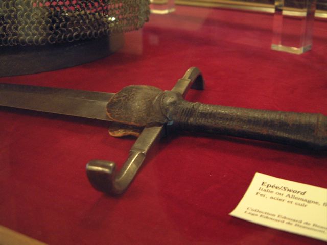

It is quite an anonymous sword, nothing particular about it apart from the fact that it is very well preserved. The handle is in very good shape, very interesting especially it shows how the "rainguard" is connected to the grip. BTW, the rainguard has been most certainly cut and repaired.
The blade is a very norrow and thick type XVa blade. The cross is faceted on only one side, as it is usual for this type.
I believe it is certainly German as many sword of this type are visible on German art and in German musuem.

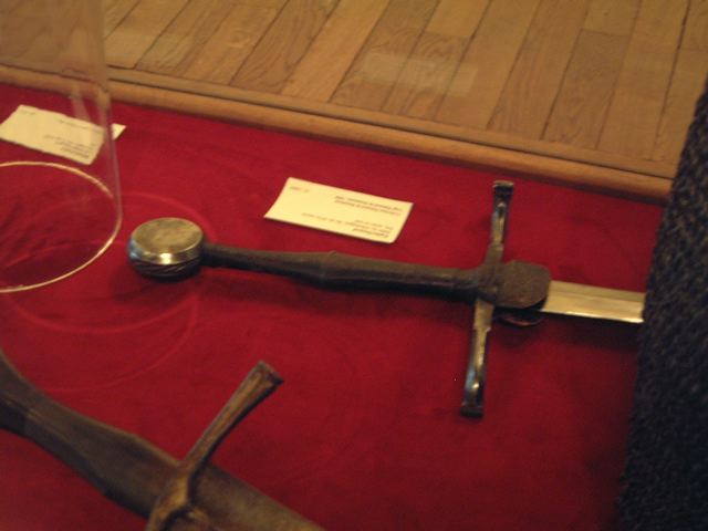

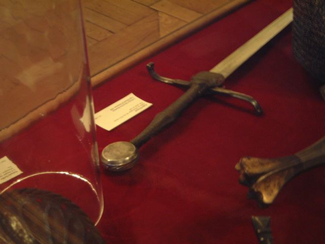

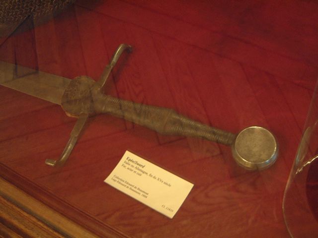

Here are most of the picture of the sword. Sorry, some are blurry, particularly the ones showing the full sword. The pictures were made in 2000 and the camera wasn't the best.
I hope you will find what you are looking for. If you are looking for something specific, let me know. I go to the musuem regularly and I might take other pictures if you need.

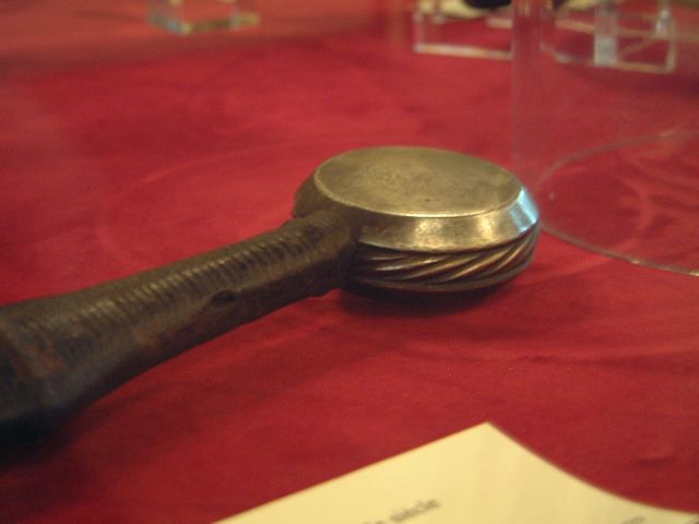

And a picture of the pommel that Peter Johnsson took as inspiration for the Albion Burgundian.

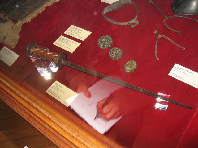

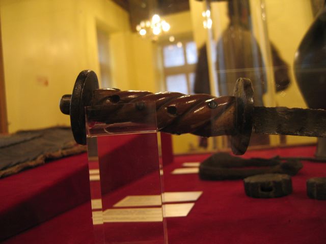

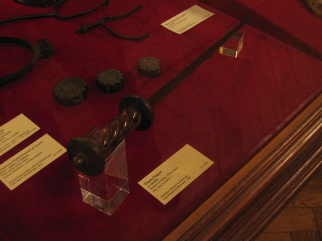

And for those you like rondel daggers. It is off-topic t since the dagger is half a meter away from the sword…
The dagger is said to be 14th century by the musuem, but when compared with period artwork it is clearly 15th century. Many burgundian piece of art show such dagger: the tapestry in Bern and above all the portrait of Charles the Bols by Van der Weyden.

I wasn't really able to swing the sword around too much, as I was under close scrutiny from the curator (though I hope to make amend for that soon), but I can tell you that just from picking it up, it really is a treat ! I had too little time to study it from any closer, unfortunately. But it certainly works as fine when held one-handed than two-handed. Point response was immediate even one handed, and yet you could feel the strength and stiffness in the blade. A very fine example of an early XVIth century sword (or very late XVth).
The dagger is equally interesting. The back of the blade is flat, and its sides are hollow-ground, making it in addition of the cylindrical roundels a really light weapon, yet still feeling quite effective.
