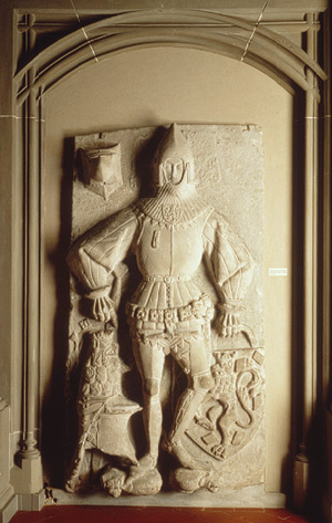

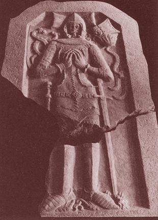

The seventh and last image is a knightly grave slab. I believe it's Hungarian, but I can't remember where I found this image. It's labelled as "Garai tombstone 1380-85". Notice the hourglass gauntlets and belt of plaques, typical of the late 14th century. Note also the coat armour or jupon laced down the centre.
Edit: I found the site where I originally found the Garai tombstone. The slab is in Janus Pannonius Museum, Pécs.
Here's the web site where I found it:
http://www.hung-art.hu/index-e.html

 Attachment: 28.42 KB

Hello again!
Just to show more variety, here's the effigy of Walter von Hohenklingen, in an image again from the Metropolitan Museum of Art. The original is in the Swiss National Museum.
Here's the museum's description:
Metropolitan Museum of Art wrote:
Swiss National Museum, Zurich
Tomb effigy of Walter von Hohenklingen, ca. 1386
Courtesy of the Swiss National Museum, Zurich (AG-125)
The effigy of Walter von Hohenklingen, an imperial knight killed at the battle of Sempach, depicts in minute detail the mixture of protective materials worn at the end of the fourteenth century. Note especially the following features: the mail shirt protruding from under the padded jupon, the mail neck protection (aventail) under a similarly padded cover, and the pieces of plate armor (breastplate, gauntlets, and strapped-on leg defenses), as well as the detached visor belonging to his helmet (bascinet) and the reinforcing plate strapped in front of his tournament helm (Stechhelm).
Note the ubiquitous bascinet, as well as the typical belt of plaques of the late 14th century and the hourglass gauntlets. Note also that this knight wore a breastplate over his padded coat armour/jupon.

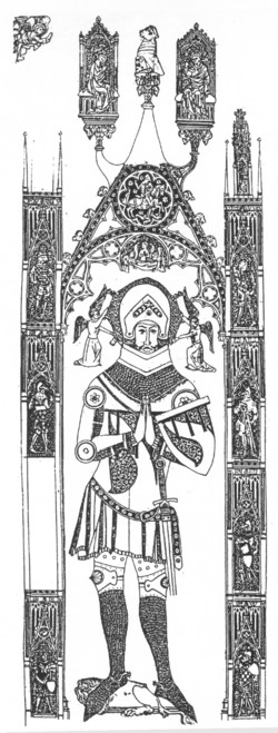

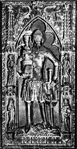

PostPosted: Sun 28 Jan, 2007 8:10 pm    Post subject: English brasses 14th century         Reply with quote
Hello again!
Here's a small collection of English monumental brasses from the mid to late14th century, plus an incised slab from the early 14th century for comparison (plus I thought this one was interesting).
All are from this web site:
http://www.mbs-brasses.co.uk/
The first is the incised slab of John de Botiler from St Brides Major, Glamorgan, Wales, circa 1335. Notice the simple cervelliere or early bascinet on his head, and the long surcoat over the mail. The sword is also interesting, almost Viking in appearance, with it's very short, curved cross. The pommel is hard to make out, but it may even be lobed.
The second is from the Hasting's Brass of 1347 in Elsing, Norfolk, and depicts Sir Hugh Hastings. Note the shortened surcoat, unusual early appearance of a gorget, the gutter-shaped plates on the arms, and the splinted or brigandine cuisses on the thighs.
The third is the brass of Sir Robert Bardolf, 1395, in Mapledurham, Oxfordshire. Note the tight fitting "coat armour", also known as a "jupon" over the knight's torso, covering the cuirass beneath. Note also the plate on the limbs, and the knightly belt around his waist. This armour is roughly similar to that depicted on the Black Prince's effigy in Canterbury Cathedral.
The fourth and final image is that of the brass of Sir John Bettesthorne, 1398, in Mere, Wiltshire. There are some stylistic details that differ, but the armour is basically similar to that shown on the Bardoff brass. Charles Henry Ashdown called this period of 1360-1410 the "Camail and Jupon" period for the almost ubiquitous nature of the jupon and mail aventail (or camail) on the English brasses of the time.
By the way, Charles Henry Ashdown's work European Arms & Armor is a good source for accurate drawings of the English medieval brasses, although his text is rather outdated. Still, the line drawings, which match the brasses almost exactly, are a useful resource for what the armour of the time (mostly English) looked like.
I hope this was of interest!

Hello again!
I found a couple images of German armour of the mid 14th century. Sorry for the small size of these; the originals were awfully small.
The first is the tomb effigy of Gunther von Schwarzburg, circa 1349. It's hard to make out the details, but von Schwarzburg wears "studded and splinted" defences on his limbs. He has a knee-length surcoat, with the skirts looser than the body. A flap of mail or a plate nosepiece hangs over his aventail. This would attach to a stud on his bascinet. This feature, of doubtful protective value, appears on some German and Italian effigies of the time.
The second is from the later 14th century. It is the effigy of Burkhard von Steinberg, died 1397. Von Steinberg also wears "studded and splinted" armour on his arms, but he has greaves made up of several large plates strapped together. He has a breastplate that almost mimics a muscle cuirass, with a laminated fauld over the abdomen. His hauberk comes to a point in the groin area. The most typically-late 14th century parts of his harness are his belt of plaques, bascinet, and hourglass gauntlets, although the cuffs may be a bit short.
I hope these images aren't too small.
Stay safe!
 Attachment: 26.83 KB
 Attachment: 15.03 KB

PostPosted: Mon 29 Jan, 2007 12:40 am    Post subject:         Reply with quote
Richard,
John de Botiler looks like some pretty antiquated armour for the time period. Are they sure his effigy is contemporary with his date? By that decade in the 14th most english effigies have more..... armour. It is of course possible to have been mainly in mail but I would imagine most knights would have more armour by the inventoires I have seen from the opening of the 14th.
It may be worth looking at the gothic eye website has fantastic archive or effigies from this era.

PostPosted: Mon 29 Jan, 2007 1:39 am    Post subject:         Reply with quote
@Richard
You are a veritable master of historical image finding! Thanks--that's been a great help in getting a better understanding of typical trends of the period. There's a lot more plate floating around than I would have guessed. I think that I was probably mistaking surcoats over breastplates for coat-of-plates.
