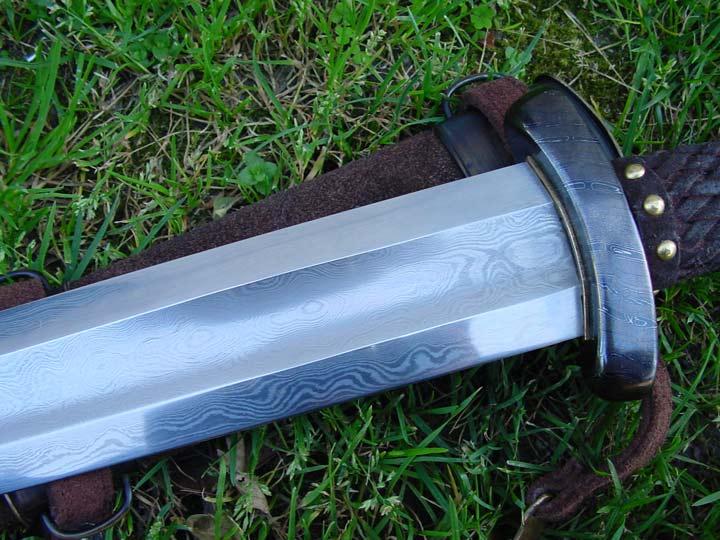

The blade of Hanwei Saxon is a Geibig type 1:
http://www.myArmoury.com/view.html?features/pic_geibig05.jpg
It's a blade type made until about 800AD so it is cerainly not a blade that would be made new for the type L hilt, but of course it's quite usual for the viking age sword to have much older blades rehilted with new and fashionable hilt types. So this blade might have been made anytime from 500 to 800AD and rehilted many times before finally getting the type L hilt in the second half of the 9th century with which we might unearth it somewhere in the North.
The package
I never remember to picture the box and packing before the opening so you won't see them. Standard Hanwei box inside a bigger box and padded with a lot thick, brown paper. The box and the sword inside was shipped to Croatia undamaged.
The blade
The blade is, as I already wrote, Geibig type 1, caractheristic for almost parallel edges with very little profile and distal taper. Hanwei blade also has very little distal and profile taper but is thicker and heavier than period blades which were thin and flexible. Geibig 1 blades either have no fuller or a wide shallow fuller. Hanwei blade is the second variation with wide, relatively shallow but well defined fuller. The tip is wide and short, but the tip is pointy at the end. The blade is quite thick and very stiff. In the fuller you can see the pattern welding pattern of the core. It is made of three twisted rods which are probably made of two steels already so there is probably six rods mixed in the core. The pattern is made with parts of rods being twisted or left straight to achieve the contrast between the parallel rods. You can see the weld lines and I believe the core really is pattern welded, but the darker color of one of the materials in the core can relatively easily be removed with a sand paper so I assume the steels used in the core are quite similar or the same so just etching them for a contrast is not enough and Hanwei used some kind of bluing substance to enhance the pattern. It is durable finish enough so that it won't fade away in use unless you let the sword rust so that you will have to use some aggresive abrasives to remove the rust. With that you would probably remove the contrast between the steels in the core and you would probably still see the lines between layers and you would see the blade is pattern welded, but the nice color contast would be lost and I'm not sure what would be the easiest way to return it. I would love to see a smith playing a bit with this blade and hear what he would say about the pattern and the materials of the core and in what ways the contrast between them could be achieved.
The edges are made of 1095 regular steel. I don't know what is the steel of the rods in the core. I sent an email to Hanwei and if get a reply, I will update the review. Blade length is 26 3/4" and overall length 33 7/8” according to Hanwei, but 70cm (27.5”) blade and 86cm (33 7/8”) overall. The thing is that Hanwei measured to the curved end of the guard and I measured to the real base of the blade. The sharpening of the blade varies from very nice almost apple-sead age to slight secondary bevel, but it’s not really sharp anywhere. But it shouldn’t be problem to sharpen it.
Fittings
The fittings are well shaped and quite accurate in shape to the original, decoration is not bad, but the original would be much more glorious looking, so I would prefer non decorated and well shaped fittings, but that's just me. Wink Black finish on undecorated parts look a lot like a black paint like on their Cromwell backsword and I would prefer naked steel like on the original. Grip is leather with five metal bands and 4“ long. The tang is peened and didn't loosen after the cutting.
Look at this Barta hilt for an example of what decoration should look like. But I don't know why Patrick Barta too used black finish on undecorated hilt parts. When I think about it, Hanwei probably used the black paint because they saw black finish on the Barta sword.

Hi guys, I usually lurk, but decided to add a bit to this review. I got my Saxon today. Overall, I'm satisfied, with some small niggling complaints.
My calipers are saying I've got a 5.5 mm base at the thickest part of the ricasso. The blade doesn't seem to distally taper until about halfway down. Before the point I've got 4.5 mm. Then, of course, the tip shape causes an abrupt change in thickness. Tip seems stout enough, enough meat on the very point for me. Unless the temper is bad, or you hit concrete/tree trunk this should be enough stability for anyone. I flexed the blade just enough to witness it springing back to true. Normally I would flex something out of line several inches at least once, but as the reviewer said, this is a thick blade. I have confidence in what I saw enough to say it has minimum spring- at this point I'm not going to push it. Give me a couple of weeks until the novelty wears off!
It does seem to be pattern welded. Initial impression upon seeing it was a good one, but it does try and trick you into thinking the whole pattern is painted/silk-screened on at some point. My wife ran her fingernail over it and was convinced it was a paint-job. No. She was detecting the difference between relatively smooth bright steel and the much rougher dark patterning. It is possible they etched it and then applied bluing to it which adhered primarily to the rougher "mystery metal".
I am thankful that the grip is constructed the way they did it. Instead of affixing the metal bands OVER a full leather wrap, the bands seem to be glued directly to bare handle beneath, and there are unstitched leather bands glued in between them. These bands might hold in place, and if I want/need to replace the leather parts of the grip it should be easy.

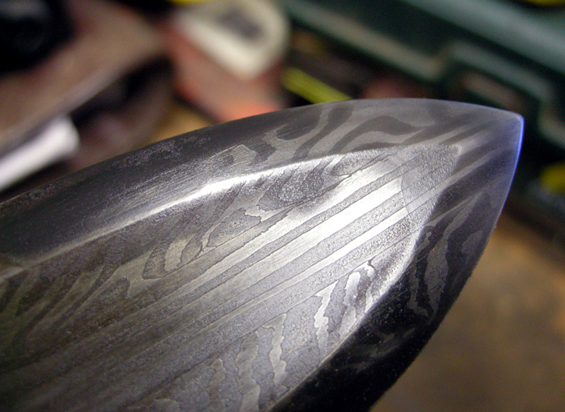

Forumnaut Aaron Justice had polished out and etched one of the Godfred blades. The result was actually fairly pleasing and a less harsh presentation of the folded steels. I am forgetting whether it was a saga or monk recollection of the sword's pattern being only visible when caught by the light in a certain way. Serpent in the blade stuff.
The harsh contrast shown in etched pattern welding is usually a matter of the polish itself revealing the shiny while leaving the softer darker.
GC
 Attachment: 83.42 KB
Aaron Justice polished and re-etched Godfred

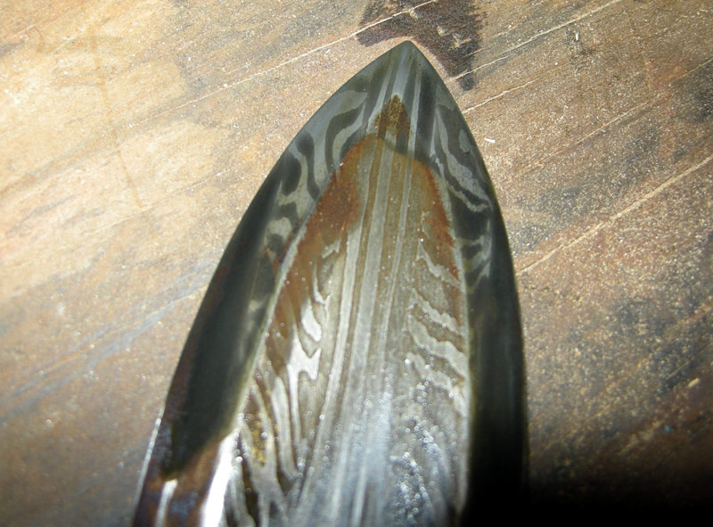

Hanwei has been doing production torsion pattern-welded blades for awhile. (I’m not sure if anyone else is). I have one of their pattern-welded William Marshall swords. I got at a very good price second hand. Even without etching the flats along the edges, it is clear that the torsion pattern-welded “core” billets go to the edges. In other words, it is all core, so to speak, the edge flats beyond the fuller were just left unetched.. There are no monosteel edges welded to the core… In the picture you can see the different steels of the torsion pattern welding peaking through near the ink marks outside the fuller.
ks
 Attachment: 121.2 KB

On first seeing the Hanwei Saxon Sword, it was clear to me that the core was truly three billets of torsion pattern-welding alternating straight and twisted sections offset from each other across the blade. It was not just selective etching of the surface. The twist patterns match on both sides of the blade and are in reversed angles. Also slight undulations in the weld seams between billets appear on both sides of the blade in the same positions.
I was curious if the new Hanwei Saxon Sword was the same as the William Marshall in the edge treatment. I was not sure if it edges were monosteel or like the William Marshall Sword, just left unetched. So, like Donald, I decided to etch the forte with ferric chloride. And the etching shows it does have monosteel edges welded onto the core.
ks
 Attachment: 142.59 KB
 Attachment: 134.32 KB

Also like Donald, I wanted to see if the core ran out the end of the sword and it just looked like the edge wrapped around because they left the tip outside the fuller unetched or if it really did have welded on monosteel edges that wrapped around the point. So I also etched the tip. It is clear that the monosteel edge does NOT wrap around the tip. Rather the torsion pattern-weld runs out of the tip.
You can see in the pictures I posted of the etched tip that the dark coloring is something that occurs in the etching process. So I don’t think it is a paint or even a bluing substance.
With just one etch in 28% ferric chloride (Radioshack circuit board etchant) at room temperature for about 15 minutes you can see a little bit of topography on the surface (see oblique image of the tip etch). So I suspect that if the etchant was warm you could get a better cut and more topography, especially with a longer etch.
I also noticed that the core is the same width at the forte as it is at the tip (1 inch). So it appears that the elements are welded together as a long bar which is cut off in sections and ground to shape with no forging and drawing out. A much faster and cheaper process than making each blade separately and welding the edges around the tip.
If this is the process they use and if enough people purchase the Saxon Sword then Hanwei may be encouraged to make longer blades (just cut the blades longer to begin with). And maybe even different patterns. And that would provide more kit material for me Wink
