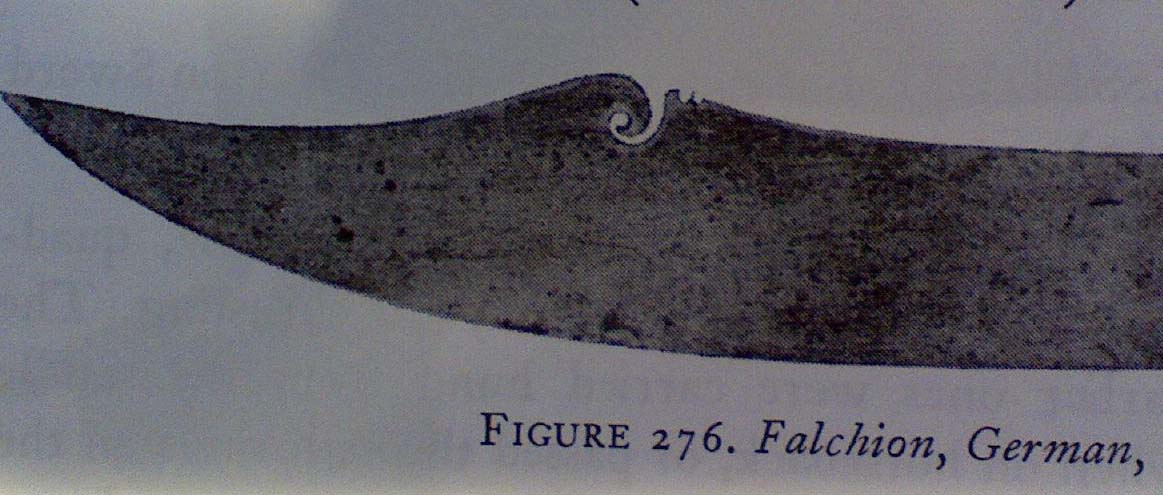

PostPosted: Wed 18 Jun, 2008 10:06 pm    Post subject:         Reply with quote
Here is a falchion from the Metropolitan Museum with some very nice features:
I really like the curl and the small adjacent serration...

PostPosted: Thu 19 Jun, 2008 4:57 am    Post subject:         Reply with quote
What's the dating of that falchion? I believe it's likely later than the Thorpe, which means that extra blade stuff may be more appropriate for a later period than for the Thorpe's.

PostPosted: Thu 19 Jun, 2008 8:30 am    Post subject:         Reply with quote
13th century Wink
Okay, okay, its 15th century, but it is so nice...

PostPosted: Thu 19 Jun, 2008 4:31 pm    Post subject:         Reply with quote
Chad
The pic of that falchion is from Stone's "A Glossary of the construction...."
The full description:
"Figure 276. Falchion, German, 15th century. Metropolitan Museum."
Does anyone know if this Falchion is still on display at the Met?
If so anyone got some good pics of it and maybe some more information about it?

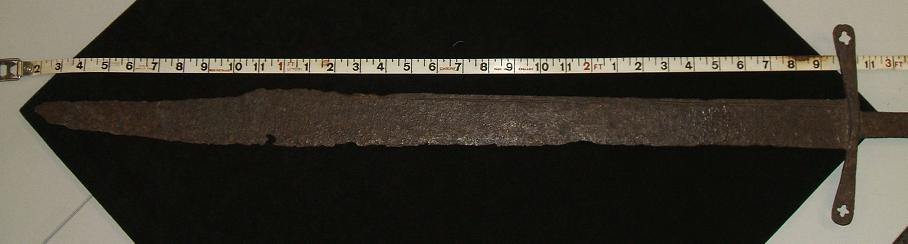

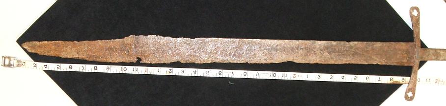

Danny, I'm afraid I'm not Chris, but here are a couple of pics that Alan took for me and I have forwarded on to Chris.
They show both sides, illustrating the long fuller on one side and the short ricasso fuller on the other, both with inward turning fuller terminations.
Hope these help,
Dan
 Attachment: 41.48 KB, Downloaded: 510 times
Side with short ricasso fuller [ Download ]
 Attachment: 34.12 KB, Downloaded: 436 times
Side with long fuller [ Download ]
