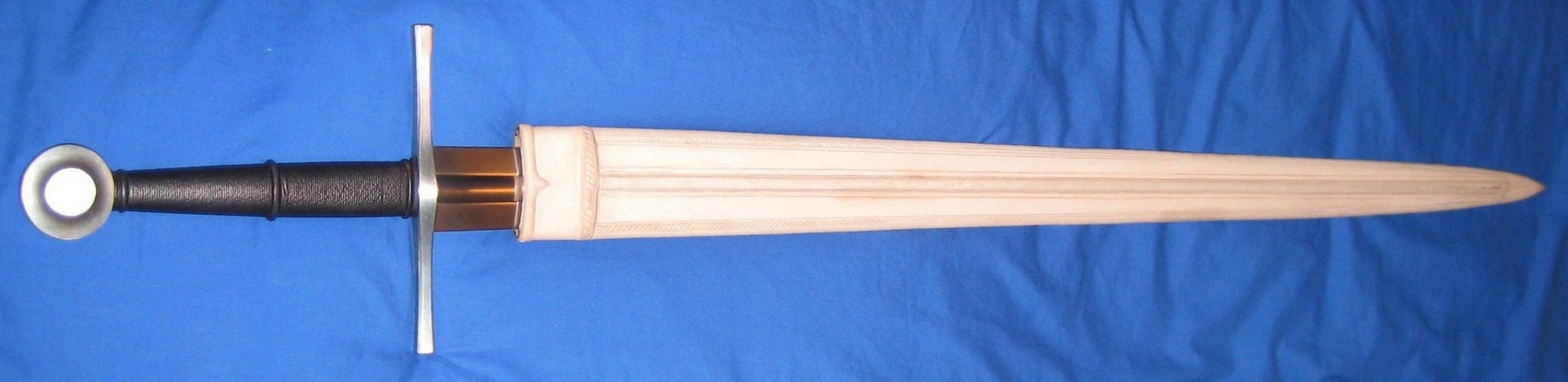

Julien M
PostPosted: Sat 01 Nov, 2008 4:48 am    Post subject: Finished woodcore!         Reply with quote
I finished the woodcore this morning. As planned I used milliput to fill the narrow gaps created by the thinning of the core. It worked great, since the areas I have treated with milliput seems to be now even more solid than the rest of the core. I had forgotten how tough that stuff was once dry, even a thin layer is rock hard. If I ever have to repair cracks in a grip or scabbard I will look no further and use milliput again. (see pic below to have an idea of how milliput looks like once applied and sanded).
Anyway the woodcore is now as thin as it can be, but yet strong and It fits the sword like a glove. I spared no efforts on this and I am relieved its over. I'll just work on the final bevel of the edges and sanding the milliput so that it's completely integrated to the core....while I 'm waiting for the leather and tolls I ordered to be delivered.
As said in my post above don't hesitate to give me your thoughts regarding the design of a XIV century longsword scabbard.
Godspeed
J

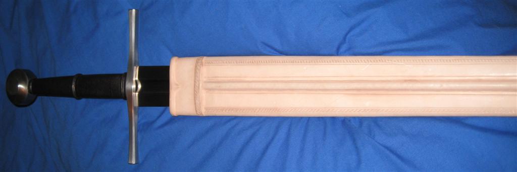

Julien M
PostPosted: Sun 23 Nov, 2008 1:24 am    Post subject:         Reply with quote
I have been moving forward on my scabbard project lately, completing raisers and starting to mold the wet leather on the shealt core yesterday.
I have used thick cotton cord for the prominent central ridge, nylon cord for the one at the scabbard mouth, and milliput for the details and perpendicular ridge. On the back side of it, I have glued a long strap of leather in the middle.
Regarding the molding of the leather, I have made several passes on it while the leather was drying, using my fingers, a wood spatula (clay sculpting tool) as well as a custom tool (a modified fork as you can see on the picture Happy ) to press down the central ridge. Veg tan leather is an interesting material to work with, as I didn't know it would retain shapes so easily.
I have applied glue but I'm not convinced that it will make a difference in the end, as the wetting of the leather, though superficial, tends to dilute it. It is not an issue since the leather keeps the all thing together very well.
Next step is cutting the leather to it's final shape and punching holes to sew the back, then tracing lines and details on the surface.
I'm pretty happy with the way it is turning out so far, but the next steps might be tricky (mistakes in cutting the leather to exact size can happen I'm sure, especially were the two sides meet at the back and also great care will be needed to trace those line with a swivel knife, as this is not a flat surface). By the way, what would you use to trace those lines before actually cutting the leather, as a pen will surely leave marks on the surface?
I might do that later on this week.
J

A couple of pics of the WIP:
Leather has been cut to size, molded around the core, currently tracing lines on the front. I now have a pretty good idea of what the finished scabbard will look like.

Hi fellows,
I finally completed the scabbard for my Albion Crecy (I still have to clean it and dye it, but all the tooling is done).
Stitching the back was no pleasure cruise, and I didn't expect this to take so long (I did an average job on cutting evenly where both edges meet at the back, so I had to correct some parts as I went along...same for the pre punched holes, which I was too casual with and had to redo them while stitching, one after the other).
I also made a copy of the lower part of the scabbard, using resin plaster (took five minutes at best: I wrapped the tip of the scabbard tightly with tin foil, pressed it down, took the core out and put it vertically in a vase, then poured the liquid plaster in). I needed to replicate it so that Lazlo (fellow forumite and Londoner) could take it home during Christmas and work on a metal shape for me, without having to bother with carrying the all thing around.
All in all, I am very pleased with the result, and I can't wait to see it dyed and fitted with the proper suspensions. The only thing that could bother me is that I did deviate slightly here and there when cutting all those lines, and once you have to make another pass over, you cut again and the result is not as clean as it could have been...but doing it when the leather is already applied on the core is not easy, as it is not flat. Next time if there should be one Happy , I'll take the leather off and will do it flat on the table. Also, I agree that using glue is not essential, as the leather; if thick enough, will hold itself on its own.
Pics are below and comments are most welcome!
Julien
