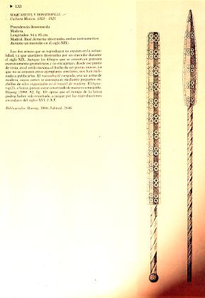

PostPosted: Tue 03 Apr, 2007 5:07 am    Post subject:         Reply with quote
Here are some pictures I found from a reconstruction, although the blades are a little crude compared to the original. The site also shows a set of aztec weapons with a macquahuitl and a halberd like spear. They seem to be the last original examples and show really great workmanship. Another, but only slightly larger picture can be found when you search for 'macquahuitl' at google.
So take a look at this site: [color=darkred]www.allempires.com/Forum/forum_posts.asp?TID=1955&PN=1[/color]

PostPosted: Tue 03 Apr, 2007 5:18 am    Post subject:         Reply with quote
 Attachment: 51.32 KB
 Attachment: 16.49 KB
