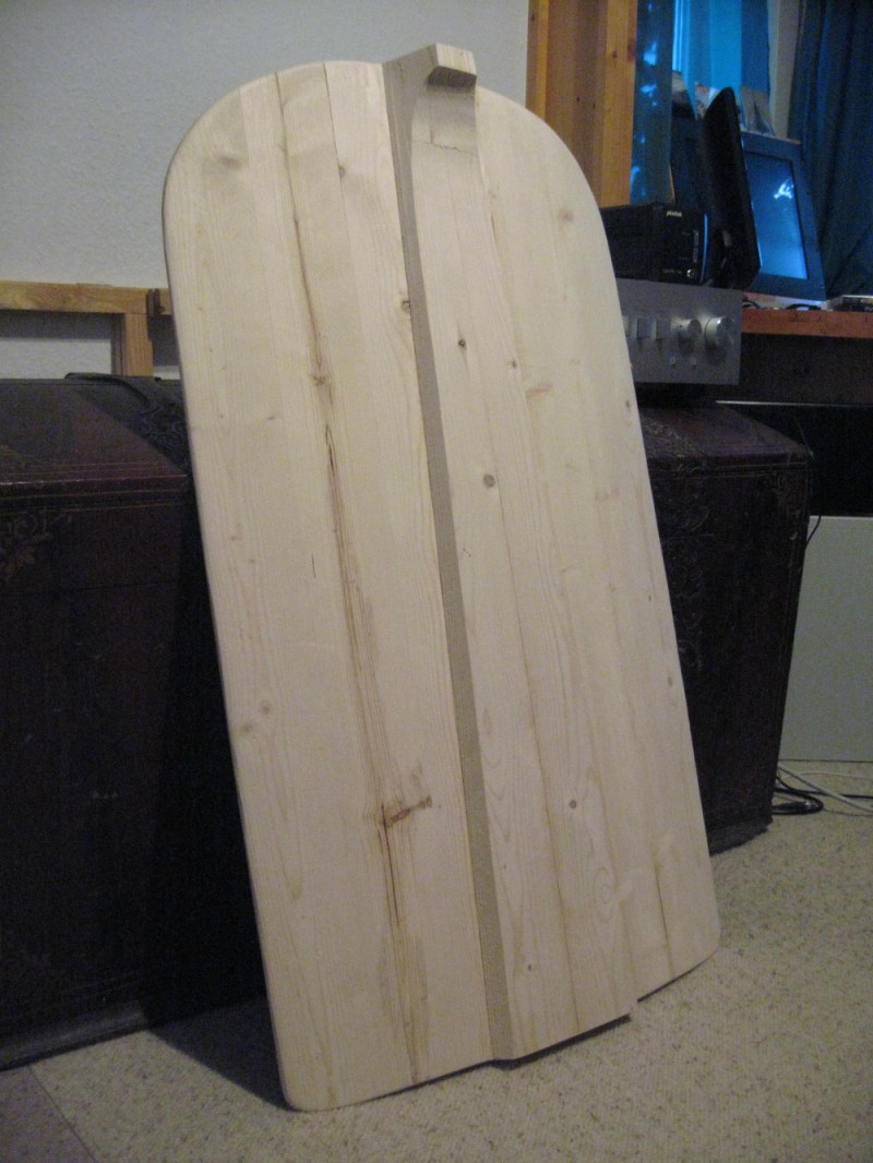

first I would like to thank you for this wonderful collection of pavises and information. This thread has been highly educational to me! I'm currently building my own pavise, with the aim of being quite close to historical accuracy. The wooden corpus is already finished (see attached image), and now I'm looking into the issue of covering it with canvas.
In my search for information I haven't yet found a detailed account of the covering technique. Is it supposed to be just a single layer of linen canvas, or more? Also, I'm wondering if a single sheet of canvas was used or multiple adjoining strips. I guess at least the "beak" must be covered separately to avoid wrinkles in the surface.
The process of covering is also unclear to me. Is it neccessary to tightly stretch the fabric over the surface (for stability), or would it suffice to loosely cover it? In the former case, I would need to somehow fix the canvas to the wood, maybe with small nails, to keep it tightly strung while gluing. It would be interesting to see if historical evidence supports either technique.
It would be great if some of you who built a replica pavise could share your experiences. I'll also make a web page documenting the building process and post the link here later.
Attachment: 149 KB, Downloaded: 230 times

Hello Karsten!
Me and a friend made two simple pavises for our cannon crew last spring. They are about 5' tall and very simple with a flat surface. Not as tricky to cover as yours but I hope I can share some valuable information.
We used hideglue which we melted in an ordinary kitchen pot mixed with water. If you paint a layer on teh wood before you put the canvas on it's stickier but dries quite fast. We tried that method but also to water the gluemix down a bit and applying the glu/watermix on top of the canvas (which was now lying on the wood) and found this to be easier. I htink it might be easiest if the cloth is a bit damp. Use lots and lots of the glue so it soaks through the cloth and into the wood. Done outside in the sunshine it dried really fast for us. The canvas was not folded around the edges on this first layer and we cut the excess off after it had dried. We then applied a second layer of cloth with the same method and this time we folded the cloth and nailed them down along the sides after trimming the edges a bit.
