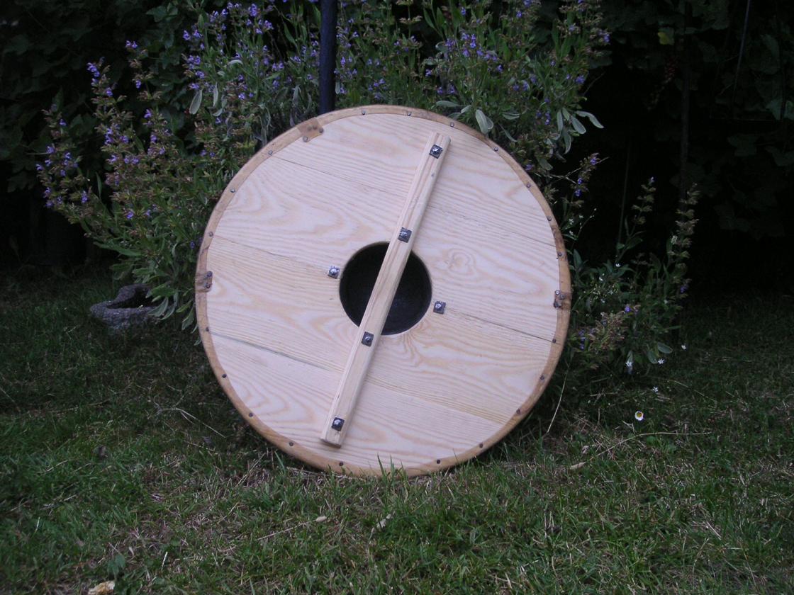

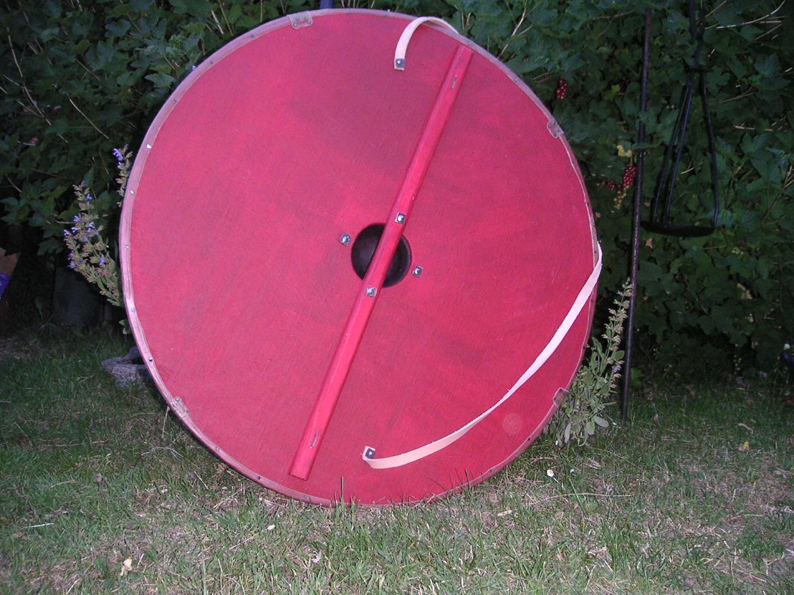

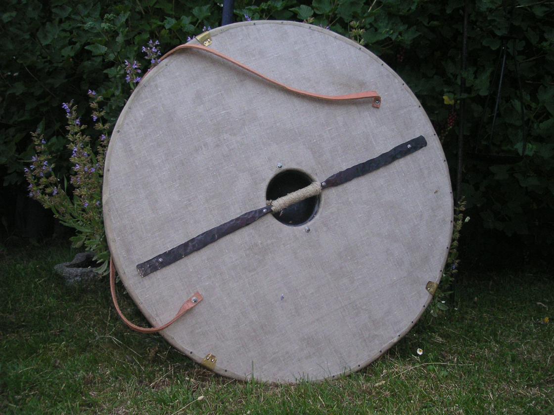

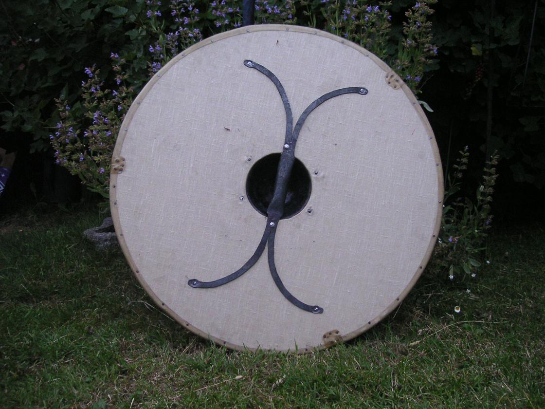

Here are some grips. Some made of wood and some in iron.
 Attachment: 141.88 KB, Downloaded: 83 times
 Attachment: 139.21 KB, Downloaded: 82 times
 Attachment: 158.34 KB, Downloaded: 87 times
 Attachment: 170.48 KB, Downloaded: 89 times

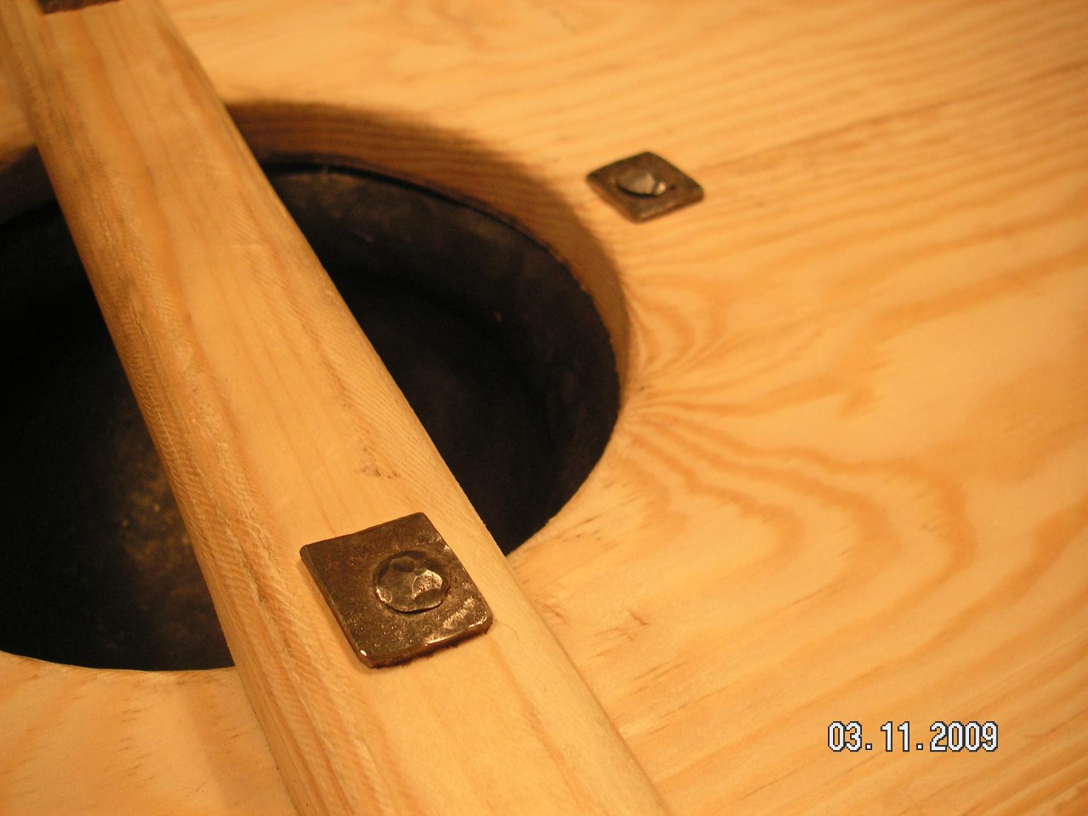

PostPosted: Tue 03 Nov, 2009 10:44 am    Post subject: Reply with quote
I use iron rivets and or nails.
If you use rivets it looks nicer with handmade rivets and handmade washers.
The same with nails. Make sure you use long nails that can be bent on the backside to secure them.
I photographed the rivet.
And I found a good painting on the net wich will show you the basics.
 Attachment: 125.41 KB, Downloaded: 49 times
