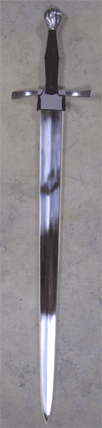

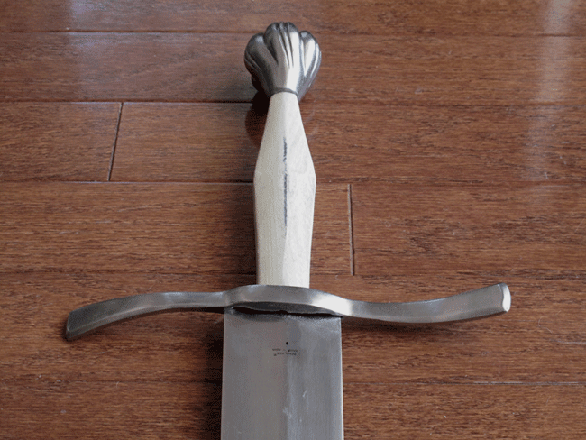

I think this project is finally about to take off. I've had to rule out XVIIIc but I still have a few different choices in cross and pommel. When my last pommel idea arrives this week, I'll make my final decision about at least one of these projects. At the moment, I'm leaning toward south Austrian ca. 1520--hand-and-a-half, recurved ribbon cross (Oakeshott Style 12) and spherical (Type R) pommel, very long tapered grip with tubular chappe, blued furniture. In short--certain (not all) elements of the swords shown below plus a few others combined:

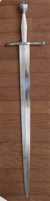

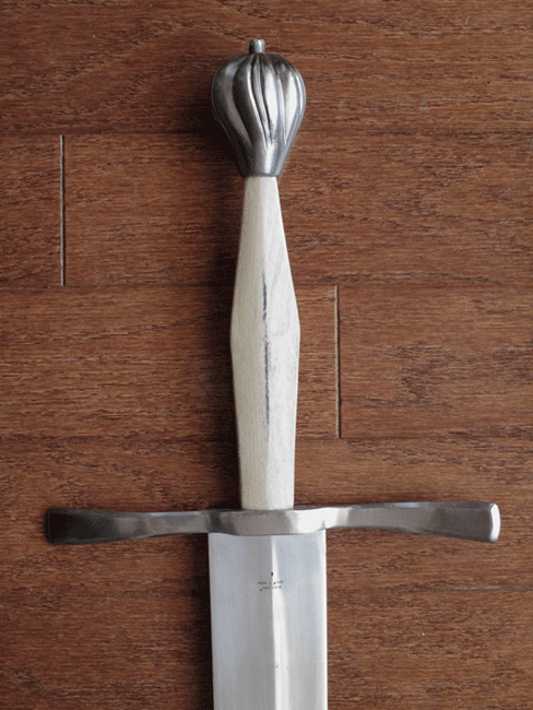

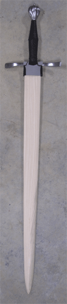

Progress! I tried out the writhen pommel with a recurved ribbon cross and immediately knew that this would be the first project. This combination appears to have been common in the period. At this stage I've roughed out the grip and further refined the pommel (MUCH narrower at its base, as was typically the case, historically). If the grip looks slightly undersized at this stage, keep in mind that it will be covered with cord and leather. I have a small amount of refining to do on the core to get things symmetrical and crisp. I know from an earlier experiment that facets are unforgiving. It's hard to judge the bare core but asymmetry and misalignment shows clearly once the piece is wrapped. The cord binding will mitigate some of that, though.

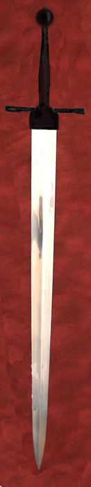

Just noticed that this sword is today's Deal of the Day at MRL again. $132!

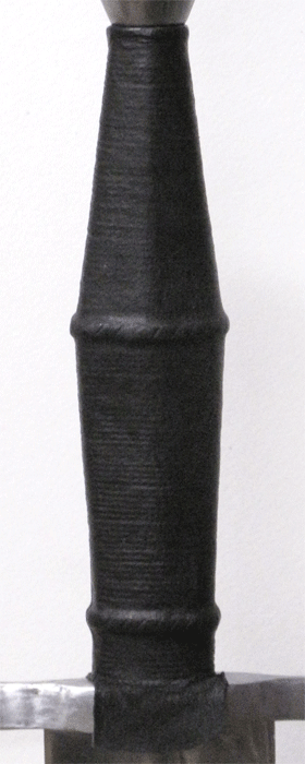

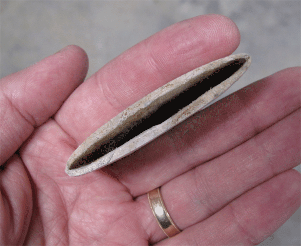

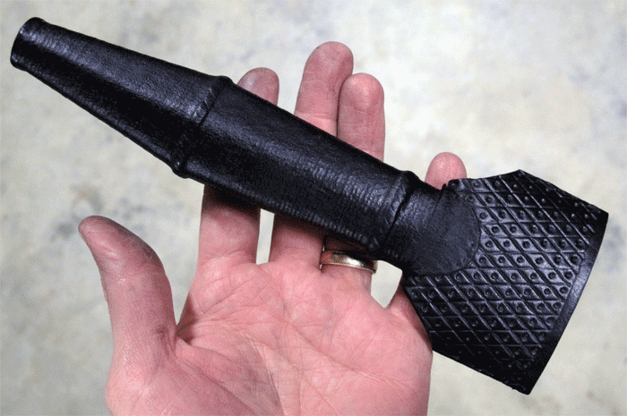

I finished the main part of the grip this weekend. The shapeless flaps at the base of the grip will be trimmed, rounded and sewn to the chappe. I have to make the scabbard first, though, so the chappe will fit properly.
