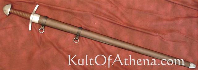

| Tom King wrote: | | i haven't looked at the hanwei catalog recently and my browser wasnt loading images. The peening on the pommel looks the same though so my comments on workmanship and quality of the hilt are still relevant. |
Well the people at hanwei might disagree with you since they took the trouble to hire Tinker P to improve their previous european lineup (that's the added value that is being discussed here). I see many differences between the sword below, if that's the one you are refering to, and the Tinker/hanwei, even if the peening technique looks similar
Julien
Attachment: 20.22 KB

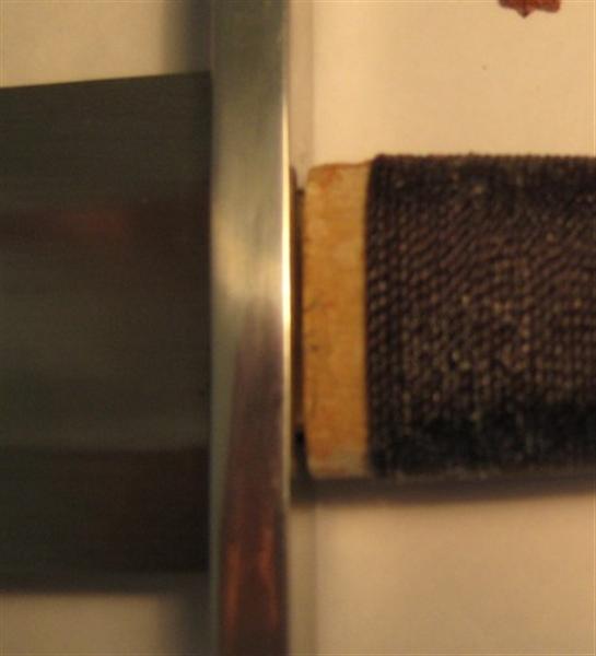

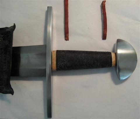

I lack time for projects lately, but I could not resist dissecting the Normand sword today.
I like what I found underneath very much. Wooden sandwich grip bound with thin cord, leather raisers, and quality leather on the top of it all.
| Dan Dickinson wrote: | | When I received the Viking, I was going to re-wrap the grip, so I removed the leather covering...immediately the cross began to rattle and could move at least an 8th of an inch up and down. The grip core also could slide around on the tang. Apparently Hanwei used a compression fit, but tucked the edges of the leather covering under the top and bottom of the grip. When the leather was removed, everything loosened up. |
Well that's also the case on the Norman Dan, as the pictures below shows. I won't dismount the sword entirely so I'm currently thinking about my options, the most probable one might be to force thin cord soaked with glue in the gap between the guard and grip (mine doesn't slide on the tang, the wood appears to be glued on it, so I will have to do that on both ends, near the guard and near the grip. I won't be able to wedge the guard though if I go that way...
Any thoughts on fixing this issue are welcome.
I was also wondering if I could safely sand down the pin so that it would be nearly invisible. I don't want to compromise the safety of the sword assembly.
Julien
Attachment: 18.84 KB
Attachment: 25.81 KB

Julien,
What if you where to remove the wooden slats carefully with a chisel and manufacture new ones that would fit better, and in turn wedge everything tightly in place. It almost seems like an extra 1 or 2mm of length added to the grip slats would do the trick. Good luck and keep us posted as to how you deal with this problem. Good day!

| Luke Zechman wrote: | | keep us posted as to how you deal with this problem. |
I chose another solution, much more appropriate I'm sure. I just used a hammer to push the pommel down. The grip gently slided against the guard, ensuring a thight assembly. Now the pin is raising 1.5 mm above the pommel, and I'll have to try my hands at hot peening...which is something I wanted to have a go at anyway. So I'll get a blowtorch and a hammer, and I will sand the top clean once it's done. Then I'll go for a new wrap, light brown, with raisers like the A Gaddhjalt. I have to work on the hilt finish before I move forward though. Then a veg tan scabbard...(knowing that the wood core and shape is provided, that's going to be a pleasant project).
Will post once this is done.

When you used the hammer, had you used it by hitting either side of the pommel intermittently to "wiggle" it down the tang? Or I suppose placing a small piece of pipe around the peen, and striking it would also work by applying a force evenly on either side without just pounding on the peen itself.
I plan to embark on a similar project using this same sword. This thread was actually the very thing that talked me into this sword in the first place, and I hope not to seem like a copycat, but it is just a great idea!!! I had been shopping carefully for months now for a good one handed sword of a European theme, and enjoy the wider blades with broad fullers of the early Medieval /Late Viking era time period. It was a toss up between this sword and Valiant's "Practical Arming Sword". After reading the positive review of this sword on this thread I was convinced. Not to mention this is right in my price range
Do you plan to recycle the wooden core that already came with the sword or are you going to carve out your own?

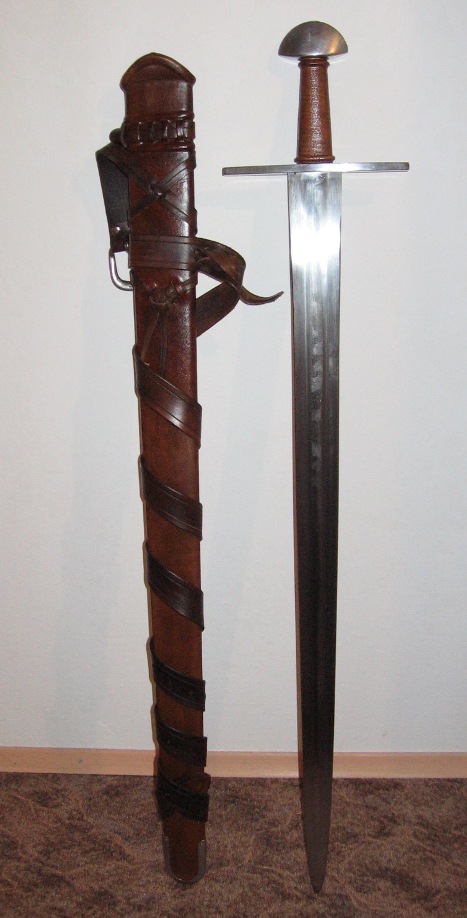

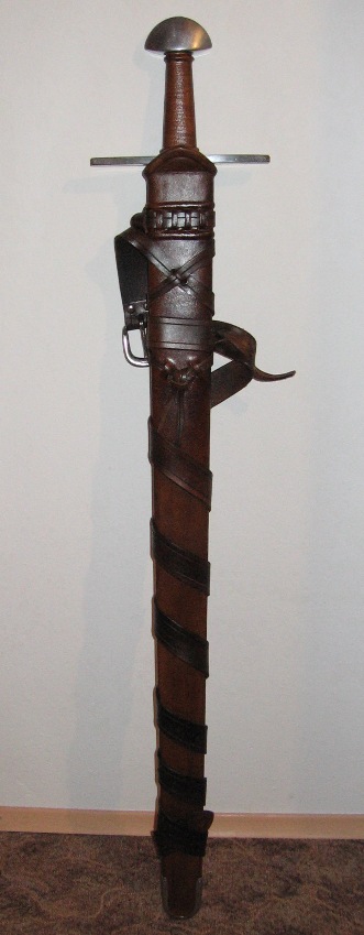

Posted: Sat 28 Nov, 2009 7:38 am Post subject: Customised Hanwei tinker Norman |
Hi,
for members who haven't seen this in the Makers and manufacturers talk subforum, this is a customised Norman sword (see attachments). The work was done by Valiant Armoury Custom sword shoppe. It is my first sword and I'm really impressed by it. It looks much more impressive and imposing in hand, than on the pictures. And the work, done by Valiant armoury team is also very good, especialy when considering the price point. I think it would be very hard to find a better Norman sword set than this one for this price.
http://www.myArmoury.com/talk/viewtopic.php?t=18049
Attachment: 65.98 KB
Attachment: 104.33 KB

i was wandering the forum and found this. i really like that custom scabbard a lot. i have handled 2 of these swords before at KOA and loved them. i like the input as it has helped me decide to put it on my wish list. just handling the sword was enough, but this has hammered it in for me. i have handled several swords including arms and armor and ollin. even though ollin was best in every area, this one just felt right in my hand.
