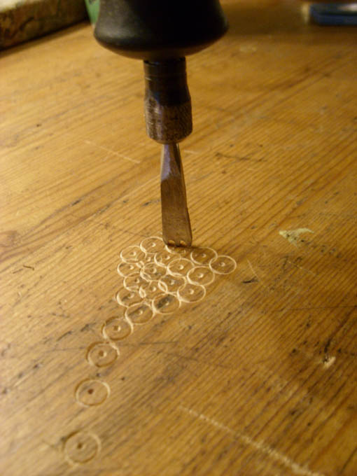

Yep! Here are some viking and medieval ones I made (comb-making is good against winter-depressions!!!! Try one yourself!!
Great stuff! A quick question...what sort of tool do you use to add those dot-and-concentric-ring patterns? Also, what sort of dye/filler do you use to blacken the pattern, yet not stain the rest of the piece?
Also, any tips on how to incise/engrave bone and antler? I'd like to try inlaying wire into bone, but I'm not sure the best way to incise the grooves without too much chipping? Would a standard graver set be good for this sort of thing?
Thanks,
Dustin

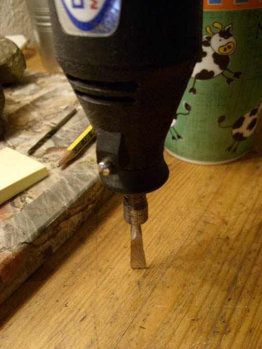

Hi Dustin,
the tool I use for the point-circles is shown below....there is a horizontal stick with a ribbon which runs over the vertical shaft, I havn´t photographed it because it´s lost, hope you can imagine.....with this you start spinning this primitive machine....
For the black incrustations I use the fine powder of antler which you get by working with this material, put it into a spoon and heat it with a candle - may look strange if a policeman would see this Happy - but then the powder gets very intesive black. Onto the hot spoon with the black powder I give a small piece of bee´s-wax, it sucks the powder and gets like gum...I apply it on the point-circle, melt it again with the heated spoon, and polish it into it. After it had cooled I simply polish the rests off. (this is the original-method, Archaeologists in Sleswig found bee´s wax and bone-char in those ornaments. Ther is a name: bone-black! That´s it. You can find a wikipedia-article on bone-char, bone-black, ivory-black!
It´s "the deepest available black"!
You can use any tool, you can use for woodworking and metalworking. But I wonder if hammering a wire into it will not damaging it....

this works, too... Happy

Thats funny how simillar tool we use, i have the drill with spindle whorl and also the bit for dremel :-)
Great info about the bone black too! thanks for that!

i have a collection of ring dot drill bits too, and for my Dremel!!! i use charcoal and beeswax in my grooves and also rust (iron) verdigree (Copper) and all sorts of other colours ,but black does generally do the best, its nice hearing from other boneworkers! do you have any techniques for doing drills with more than one ring? i've always thought more than one ring and you have one point one side and the other(excluding the centre bit) further out than the other, sound right to you?
Happy funny, how this thread is exploding....it is slowly getting a thread about iron-age techniques in general...
I used a smaller bit and a wider bit, first made the smaller circle, than put the wider one over the ornament and drilled again...

Thanks so much for the info on dot-circle tool & bone-black!
I wonder about that too. However, I know wire inlay in bone is possible & was done historically (there's an example in the book, Medieval Knives & Scabbards of tin wire inlay in a bone knife handle ).
thanks for your info, i'll certainly gie it a try! i do agree, this possibly could become a different topic alltogether, never realised there were so many interested in bonework hidden in the shadows!
