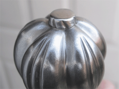

Looks really good. I like the faceted grip. came together very well. can you show us the peen block you finally opted for as I am going to get back to working on mine soon and I am trying to figure out what I want to do on the pommel end as well. tr
I'll get a shot of the block/nut and post early next week. If you have one of these, you know that the peen is filed to blend with the top of the pommel. I took my peen inspiration from a German two-hand sword with a similar pommel. That sword has a short conical nut with crude roping (not blended with the fluting), so I cut the wings off of a wing nut, filed the design and peened over that. First, though, I used the Dremel cylindrical stone grinding bit to create a level seat for the nut. I just held the Dremel vertically and pressed the bit down over the pommel hole. Simple. Peening was very difficult, even with a hot tang. I think Windlass tangs tend to be very hard, so keep that in mind and leave as little tang to work with as needed. My conical nut got kind of squashed in the process but it still looks reasonable. I filed and sanded the peen so the seam is all but invisible.

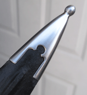

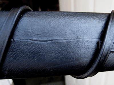

A close shot of the peen block would be nice, a close up of one guard quillon two, the scabbard shape also interest me, as well as the sewing at the back of the scabbard (if there is any).

I think this covers the image requests.
As you can see from my scabbard seam, Julien, my "software" lags behind my "hardware" in this case. The first scabbard I made was much neater. I think I rushed the job here, trimming the leather before it was fully dry. This is one of the major disadvantages of the chamois. It's quite stretchy, and if the leather is still damp enough to stretch during the trimming it creates a wandering line and some rough places. It's fine when completely dry. The part of the seam shown here is an average section. There are some smaller and rougher places near the tip as well as some places where the seam is all but invisible. I'm not sure what I did wrong here. Looks like the leather is buckled or folded under. You need this light to see it clearly or I'd have fixed it. This is all on the back of what to me is primarily a display/safety feature of the project, so I'm not too put out by the problems. Still, I'd like to become a better scabbard maker.
I'm still struggling with peening, but that's largely due to the hardness of the Windlass tangs. We'll see if the Tinker-Hanwei tangs are softer.
The chape is adapted from the Windlass "Saxon Hilt Sword" scabbard. I shortened it and cut the gothic design. Up close, in the right light, you can see the brass(?) used to braze on the finial.

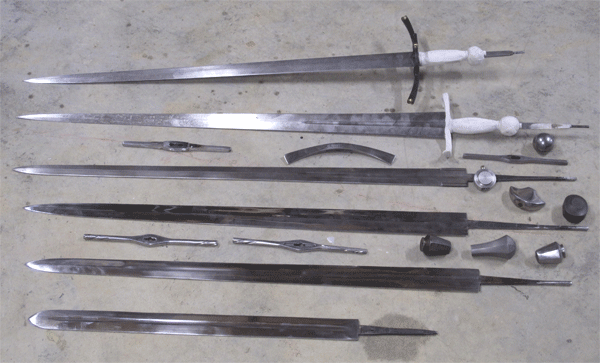

And, last, I thought you DIY folks would be interested in seeing the contents of my toy box. There are a few good possibilities here as well as some things I'm not sure how I'll use: A field sword a la Wallhausen (ca. 1617), an Italian sword a la Agrippa (1553,) a Swedish sword, maybe an Alexandria XVIIIc... Who knows? I'm still pondering the Swedish project, so I might go for one of the single-hand swords next.
