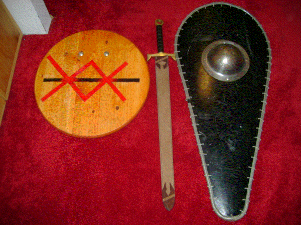

PostPosted: Fri 09 Apr, 2010 1:09 am    Post subject:         Reply with quote
these are the first two shields i have made. i am currently in the process of making my first heater. will be back with more pictures and updates.
 Attachment: 122.52 KB

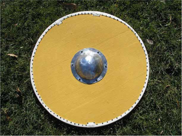

PostPosted: Sun 30 May, 2010 6:24 am    Post subject:         Reply with quote

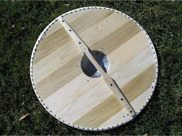

This is a shield that I put together last fall. It consists of glued poplar planks with a nominal thickness of 1/2". The grip is also poplar and was carved by me. It is attached with clinched iron nails. The face of the shield is covered with linen and painted with milk paint mixed to resemble orpiment as closely as possible without subjecting myself to the toxicity of that pigment. The face is tapered starting about six inches from the edge to about 2/3 the thickness of the shield at center, and the rim is rawhide attached with iron tacks. I am not fully satisfied with the boss, but it was the best that I could find at the time. Sadly, my carpaltunnel has brought my dishing days to and end. The diameter is approximately 27.5" and it weighs between 5 and 6 pounds.
 Attachment: 77.09 KB
shield face
 Attachment: 72.37 KB
shield back

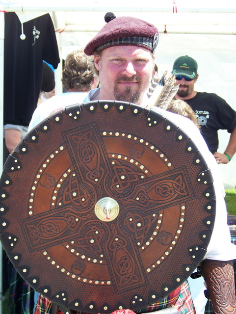

my targe

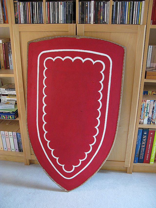

Hi,
I just recently completed my first infanftry-shield (60x100cm), which I want to share with you. It resembles roughly some examples seen in the Morgan Picture Bible (Maciejowski Bible / Crusader Bible). It's made of Meranti-Plywood, the rawhide is sewn to the wood. Well, I bought the frame but made all of the leatherwork an artwork by myself. The straps are riveted to the corpus by forged nails and selfmade metalpieces. The front is covered in canvas and painted in oxblood red and white acrylic paint. The artwork is also taken from the Morgan Picture Bible.
Greetings,
Thomas

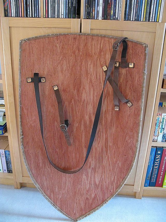

The leatherstraps are riveted to the wood. [ Download ]

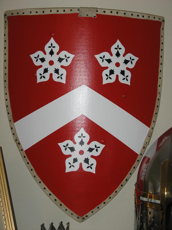

I chose these lines instead of a coat of arms, because my kit is made to resemble a footsoldier (1250), not a nobleman. [ Download ]
