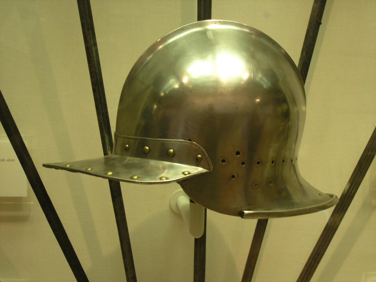

Getting this thread back on track, here is a later example of recycled armour, a burgonet from the time of the English Civil War, at the Royal Armouries U.K.

Wow. A burgo...sallet. Truth is really stranger than fiction.
