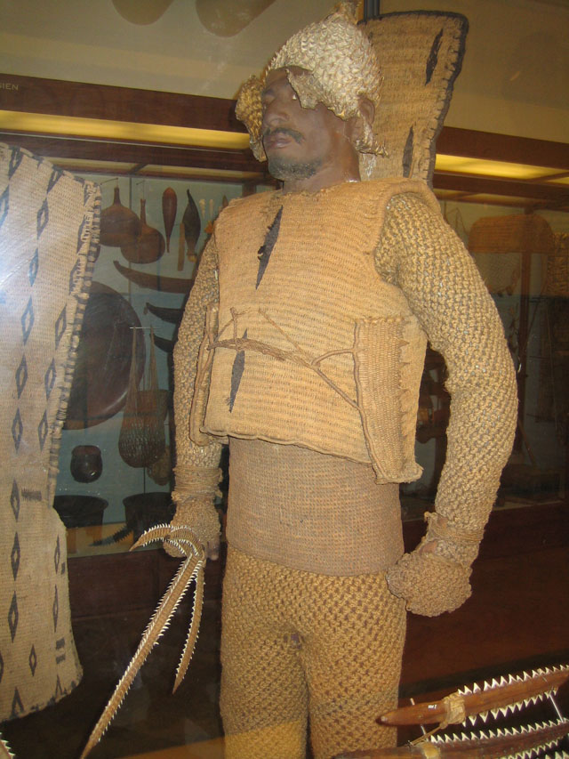

Here's a couple of photo's of armour from area's one wouldn't normally associate with armour
First is a coconut fibre armour from Kiribati, Oceania. One story I've heard ( posiibly fiction) is that the women of the tribes would accompany their men to the battle and stand in background throwing stones at enemy. Hence the large shield-like extensions above the shoulders - to avoid "friendly fire" from an irate spouse ?? Big Grin
Next one is an Unuit bone (whalebone??) armour collected in Alaska, 1830. Anyone notice the similarity to the ancient Chinese armour from the Terracotta Warriors tombs ?
Some North American armours have this shield also and the same myth is given as to why they are used. More likely is that the fighters regularly turn their backs during a skirmish and the shield is designed to protect their heads from the enemy.

Ralph, the bone armor is gorgeous!! Thanks for posting that. Hmm, might look cool with my Mycenaean boar tusk helmet! Nothing to polish, either, hmmm....
