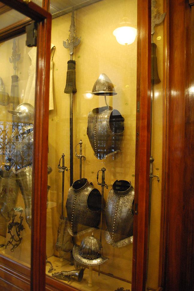

These are some pretty good evidence that the breastplates were meant to look like doublets. You don't normally need decorative buttons on a breastplate.

Those were pictures I took in the Wallace Collection in London. They have an excellent online collection tool.
The first one.
http://wallacelive.wallacecollection.org/eMus...detailView
This is their entry for the second one.
You will also find more there as this other picture of mine that didn't come out too well shows. Also all of the photos I have put up are only a quarter of the size of the actual ones I took so if you would like more details I can email them to you.
 Attachment: 131.36 KB, Downloaded: 42 times
PostPosted: Sun 29 Apr, 2012 6:46 pm    Post subject:         Reply with quote
The ones with front closures and decorative buttons are likely not field armour, but armour for show and/or light protection in street fights.
