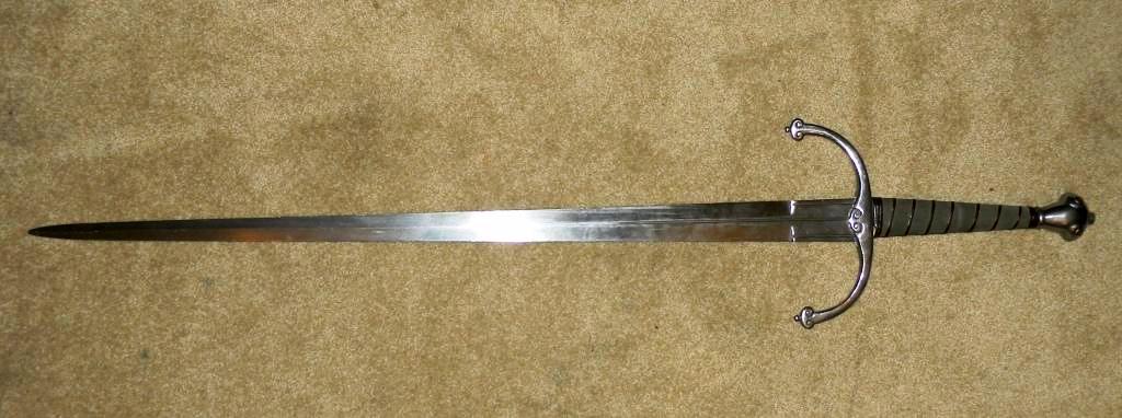

PostPosted: Sat 26 May, 2012 6:37 pm    Post subject:         Reply with quote
Museum Replicas used to sell a Del Tin version of this sword about 2 decades ago. They called it the Renaissance Battle Sword. It came in 2 lengths: one sword was 41 3/4 inches with a 32 1/4 inch blade, and the other was 44 3/8 inches, with a 34 7/8 inch blade. I got one of the shorter ones on ebay a few years ago. The description says the sword is a composite of hilt parts based on a 16th century Italian sword in the tower armouries, and blades by Del Tin. They were not trying to exactly replicate the historical weapon, as the blade was similar to that of the Windlass Long Sword, but they looked nice and had excellent balance.
Beware the Jabberwock my son,
The jaws that bite, the claws that catch!
Gary B. Ledford
Usergroups:
Donating Members
Location: Southern California
Posts: 38
PostPosted: Sun 27 May, 2012 12:37 am    Post subject:         Reply with quote
So here are a few pics I took tonight. Not a photographer, but then its not exactly a museum piece.
 Attachment: 74.43 KB, Downloaded: 74 times

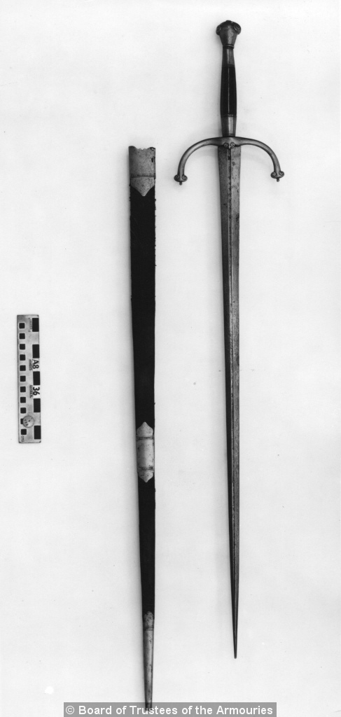

PostPosted: Tue 29 May, 2012 2:18 pm    Post subject:         Reply with quote
The RA example...with scabbard!
 Attachment: 97.96 KB, Downloaded: 103 times
Scott Woodruff
Usergroups: None
Likes: 8 pages
Posts: 578
PostPosted: Tue 29 May, 2012 3:11 pm    Post subject:         Reply with quote
Thank you Sean. I find it interesting that both examples with this hilt style have long fullers. The blade shape reminds me a lot of the Hanwei Tinker longsword blade, just with a longer, narrower fuller.
PostPosted: Tue 29 May, 2012 6:29 pm    Post subject:         Reply with quote
I thought of the HT as well, though I find that blade to be so light that I think I prefer it with a shortened tang and single hand mounting. I'm choosing a design for one of those now.
Gary B. Ledford
Usergroups:
Donating Members
Posts: 38
PostPosted: Wed 30 May, 2012 9:51 pm    Post subject:         Reply with quote
All to taste, Sean. Early in my wma studies, I used to feel that all the Tinkers were just a bit too light. A few more years of study, and I feel their bastard sword blunts lend themselves very nicely to fine Fiore longsword fencing- the PoB makes them recover and change direction very quickly. The HT longsword blade seems better for a Meyer longsword work, or perhaps as a Renaissance Italian spadone.
Next time I get a blunted Tinker longsword sword blade at a decent price, I may try to replicate the blade in Ryan's pictures. I've kinda fallen in love it, and I think my grinder-fu is good enough to pull off that ricasso. The fullers won't match, but amateur tinkers can't be choosers ;-)
