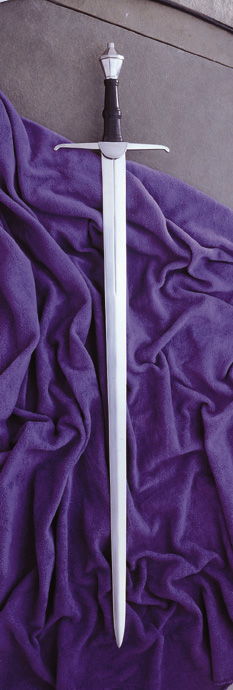

Does anybody here have any experience with this replica? It's an MRL/Windlass piece allegedly based on the Dublin Civic Sword of ca. 1400. Specs of replica are as follow: Overall- 42" * Blade- 34 1/2" long, 1 3/4" wide * Wt.- 2lbs. 10 oz.
I welcome your thoughts and observations. A tiny image of the DCS is included below the replica.

As a matter of fact, my fencing instructor got one for his wife (also an instructor at my club) just the other day. She brought it in and most of us spent about a minute swinging it about a bit. It handles very nicely, and the fittings (at least on the one she got) were nice and tight--absolutely no rattles. PoB as I recall was about 5" from the guard (ballpark guess), and CoP about 2/3 the way out (take this guesstimate with a couple grains of salt, as I didn't actually take a measurement, I just eyeballed it). The pommel on the piece I handled was well-executed, with no scuffs that I could see. I good piece, especially because I think it is on sale.

Yeah, I ask because this is on sale for around $129 ($110 after additional 15% discount). These sales are tempting, but there always seems to be a mix of good, bad and indifferent items. It's difficult to tell which is which without this kind of feedback. Thanks for the additional info! Now, if can track down some specs for the original....

I found a hilt-shot of the Dublin Civic Sword last night ("Swords and Hilt Weapons") but forgot to bring the image into work for scanning. I'll try to post the photo this weekend. For those who haven't seen the original, it's entire hilt, grip and rain flap included, is of gilded silver. The top of the original's pommel appears to be slightly domed. The weapon is shown in its scabbard, so I still have no idea about the blade. Old MRL catalogs note that the DCS is pictured in "The Dublin Civic Swords" so perhaps somebody with that book can describe to us the differences between the replica blade and the original. I hope to be able to view the orignal DCS next summer. If photography is allowed I'll snap it and post it in the albums. I'm increasingly tempted to get this replica and see if I could give it the DCS treatment--possibly clear lacquer over gold leaf? Gilded brasswork on the scabbard? Hmmm....

NOTE: I found a tiny image of the DCS and edited the orignal post to include the image. It's some help, but it's still difficult to tell what the blade looks like. It appears to have a fuller, then a diamond cross section.
