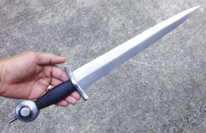

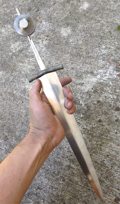

I'm considering a project of this type as a gift for an English friend using a large double-edged blade of diamond section, sloping cross of octagonal section and Type K pommel. The proportions seem okay to me but this is far afield from my usual interests and I just can't find much information. What do you think? Historically plausible for an English dagger in the period 1300-1400 or too much fantasy?

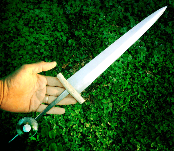

PostPosted: Wed 23 Apr, 2014 6:16 am    Post subject:         Reply with quote
Thanks, Danny!
There seems to be great variety in hilts and blades, so I'm going to proceed with my original idea for the dagger itself. I'm still undecided about a sheath/scabbard. I've seen some impressive lockets and chapes on effigy daggers, but I'd sooner have none at all than do that badly.
I've drilled and reduced the pommel and made an initial fitting. This gives me a much better idea of the project's viability.

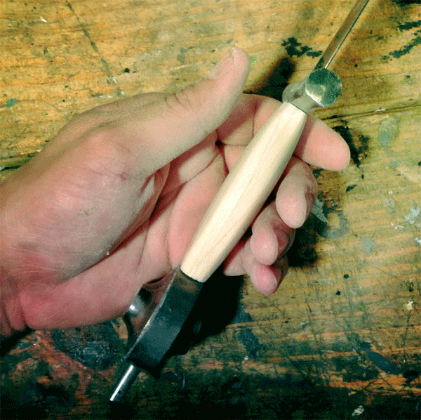

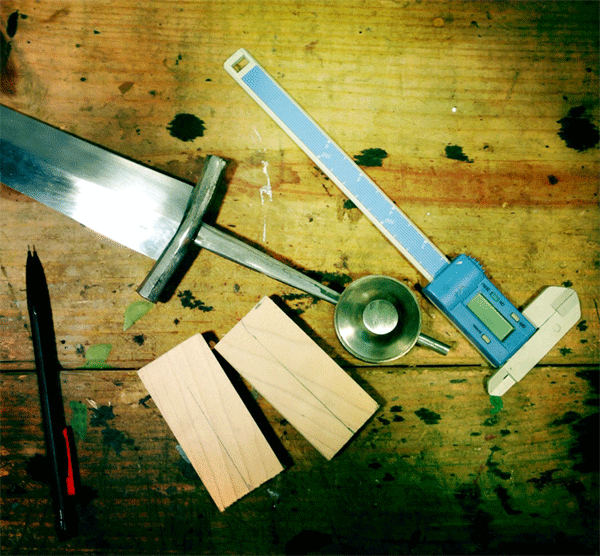

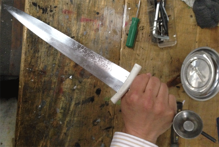

PostPosted: Mon 12 May, 2014 12:21 pm    Post subject:         Reply with quote
Progress on the pommel, quillons and grip. I also have a tentative design for the sheath, so I'm moving right along! Still some filework and polishing to do on the hilt.

PostPosted: Mon 12 May, 2014 2:51 pm    Post subject:         Reply with quote
Thanks! It's feeling better, too. Even with the overweight pommel there's enough blade length that when I slash with it I feel that it could do some damage. It feels as if there 's a weight that slides farther down the blade the faster I move it, then slides back up to the quillons at rest.

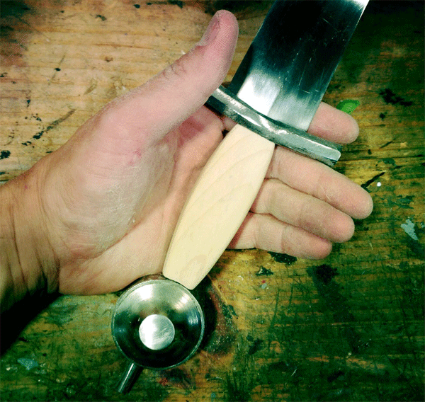

PostPosted: Tue 13 May, 2014 8:08 am    Post subject:         Reply with quote
Progress on the grip. For me, faceting is usually just a stage of development to keep things straight and symmetrical, with the edges gradually reduced to create an oval-to-round section. In this case, I'm liking the hexagonal section and might keep it as the final section.
I do about 99 percent of grip shaping with the Surform rasp you see beside the vise. It's the closest thing to a magic wand I have. The surface of the grip you see in the vise is rasp only. The mounted grip has had some refining with sandpaper. I might still need to reduce and refine in a few places, but this is pretty much what the core will look like, assuming I stick with the hexagonal section.

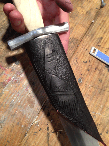

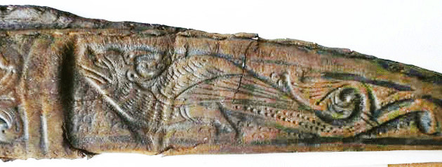

PostPosted: Wed 04 Jun, 2014 6:21 am    Post subject:         Reply with quote
I have to start thinking about the scababard. I'll probably stick to geometric stamping but felt that I should at least experiment with cutting and beasties. Tried some quick and very crude work inspired by a design in the MOL's Knives and Scabbards. I can see some potential, but I think I prefer the look of stamping. In any case, I think it would take longer to master the cutting techniques than I have to spare for this project.
I'm trying some oxblood dye as well. That might be all the flash I want, and I can always over-dye with black if I don't like it.

PostPosted: Mon 23 Jun, 2014 5:41 am    Post subject:         Reply with quote
That's a great one, Radovan! Thanks!
I hope to assemble the dagger this week so I can hit my July 1 goal for the whole project. I decided to go with plain black for for the grip because I really want to make a tooled sheath inspired by the design of the recent London find shown here. I think that's just about perfect for this dagger and the period it represents. Oxblood plus tooling just seems a bit much for my tastes. If I screw up the tooling I might rely on a decorative chape for the flash.

PostPosted: Tue 24 Jun, 2014 6:25 am    Post subject:         Reply with quote
The seam is slightly overlapped so that the fingers pull in the direction of the wrap instead of against it. The wrap is glued and tightly bound with cord until dry. Waxing, burnishing and polishing complete it. It'll need one more polishing before it's finished.
