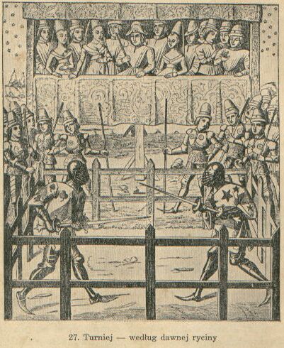

Michal Plezia
Location: Poland
Joined: 07 Oct 2005
Posts: 585
PostPosted: Sun 19 Feb, 2006 2:16 pm    Post subject:         Reply with quote
Two more pictures...
 Attachment: 70.55 KB
 Attachment: 95.67 KB

Fabrice Cognot
Location: Dijon
Joined: 29 Sep 2004
Posts: 354
PostPosted: Sun 19 Feb, 2006 2:50 pm    Post subject:         Reply with quote
Hi Michal
I'm quite sure the first picture was made after an illustration from that French/Burgundian treatise on wagers of battle I mentionned earlier, the one I couldn't find the reference of...
Fab
PhD in medieval archeology.
HEMAC member
De Taille et d'Estoc director
Michal Plezia
Location: Poland
Joined: 07 Oct 2005
Posts: 585
PostPosted: Mon 20 Feb, 2006 5:38 am    Post subject:         Reply with quote
The second one is very interesting because it shows that this kind of weapon was used also by mounted warriors-not only during foot combat.
