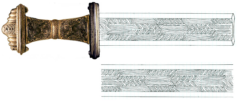

Sorry if I gave the idea that I believed pattern-welding was only decorative or even mostly decorative. In my post above I was trying to give some expert opinions which would be much more meaningful than my on feelings.
My own personal feelings on the matter (for whatever that may be worth compared to Tylecote's and Gilmore's work) is that in many cases, in their original state before over a thousand years of aging and corrosion, many if not most of these pattern-welded core blades did have a noticable increase in toughness and resilience. As I mention earlier, I think this is why it became a hallmark of relative superiority and was included as inlay and veneers in the twilight of medieval pattern welding.
What I really wanted to emphasize in the above post, is that, to me, it is more amazing that these dark age swordsmiths could forge such fine and thin layers of steel into the edge of the blades for the full length of a 30 inch blade than that they could forge weld a bundle of twisted billets together in the core. Also I wanted to suggests that even if we were to accept the most extreme view that pattern welding was only decorative then, in terms of superiority, we still must deal with the issue of these welded on edges and especially the layered sandwich type edges with high carbon steel cores. Who is going to say that this is only decorative? It is clear to me that this was obviously meant to be functional and the experts seem to agree on this point. So... If we were to ask if there was a natural superiority in function with these pattern welded prestige weapons the answer would be yes, even if the patterns were only "bling bling." Big Grin
Jeroen Zuiderwijk wrote:
...Well, the general idea I get is that the smiths tried to create a harder edge, and a tougher core. The latter can be done in various ways, one of which is by creating nice looking torsion damast. While the patterns may be decorative, and the same effect could have been achieved by other methods, that doesn't mean the patternwelding was only decorative.
Great point... And to add to it (and probably open another can of worms): The very fact that they are experimenting with so many "various ways" and patterns in the core would suggest that they are trying to increase some functional aspect. If someone countered that the variety was simply the ever increasing desire for the "new" in decoration then, in IMHO, they don't understand the ancient mind. The obsessive "quest for the new" is a modern condition. The ancients were much more conservative. They believed, and I say this in very general terms, that old was good (tested and proven) and new was bad (unproven and chancy)... just the opposite of the modern tendency. That would explain why decorative trends, as well as technological status quo existed for centuries or longer. For instance with pattern-welding designs, it may look as if they had tried every pattern that could be imagined. However there seems to be some patterns that have not been found as of yet but would have a really nice look. As a matter of fact it was on of these patterns I really liked when designing the reconstruction of the Fetter Lane sword. It involves billets side-by-side twisted in the same direction and offset on each side of the core. I will try to post an image.
It gives a very nice decorative effect but was so unperiod that Barta reversed the outer billets to be more in keeping with period patterns.
take care
ks

This link illustrates the method Peter described with quartz sand as flux. I was able to find it after searching for quartz as a welding flux. http://www.metmuseum.org/toah/ho/06/eue/hod_55.46.1.htm
This museum link describes a sword as made from "alternating rods of steel and iron." http://users.utu.fi/mikmoi/construction.htm
I suspect the museum description is misleading and that the rods would be better characterized as varying grades of iron. So far, I have not found evidence of steel in NorthWest European regions other than "bog" or low carbon wrought iron and mild carbon (0.7% or less) however it was produced. Some crucible steel was traded out of Syria to the Genoese in Italy, but evidence is not conclusive before the 12th century.
It is supposedly very difficult to weld plain low carbon steels or iron to higher carbon "alloy steel". Particularly so as you begin to introduce nickle, vanadium, chromium, and elements of stainless steels into the alternating layers to really make the contrast distinct. This is where specialized flux becomes necessary, and what modern pattern welders are doing to make the layers show up with beautiful contrast. I suspect that this is closer to what we see in some of the fantastic examples by Barta, who appears to have a sort of a blast furnace or bloomery forge for production of iron and steel. What seems to be characterized in the metallurgy of the Dark Ages non Eastern blades is "mildly carburized iron", ranging from 0.3% to 0.7% in better cases. This is still not alloy steel, but is impressive if carbon is being achieved through piling and simple hearth forge facilities. If all rods were actually low grade iron, they might be welded with a good forge using no flux at all. This would still have a beautiful look where the slag lines would reveal the look of the twisting and lamination of layers performed as part of the forging. I doubt you could get a spring temper from it though.
