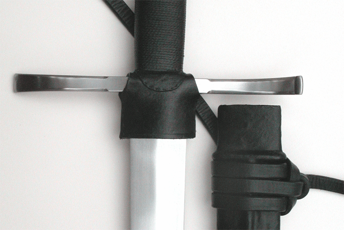

My first scabbard/supension (only a few months old as of this writing) is typically Austrian, ca. 1480-1525. I have a similar project underway now. It's worth noting that suspensions and scabbards were subject to regional tastes. You could pair an historical scabbard with an historical suspension and still come up with something a-historical if you're not careful. That's one of the many reasons I look at artwork of the period for ideas and justification.
With so many people making scabbards these days I'm surprised so few folks are also making chappes (a.k.a., "rain guards,") which art-historical evidence suggests were an integral part of the scabbard/suspension system of many or most late-medieval swords (in Northern Europe, at least). I've said elsewhere here that the properly-fit tubular chappe helps retain the sword in the scabbard, just as the construction of the scabbard itself and suspension do.
Even if these devices were primarily defensive, as some have argued, artwork and surviving examples reveal that the tubular style shown here was carefully fit to the scabbard mouth, which is tricky to manage, let me tell you. For the chappe to fit properly, you have to make the scabbard first, complete with the horizontal riser where the chappe will end. That's more than an aesthetic decision, though, because that riser also serves to prevent the suspension knot from moving up when only a single knot is used. So, in theory, you need an assembled sword in the scabbard so you can fine-tune the balance by the placement of that riser. But you can't secure the hilt until you make the chappe, which in at least some cases sits under or around the base of the grip and is stitched in place. And you can't include a chappe in the rough assembly because until you have the sword in the scabbard you won't know exactly where the riser should be, and if you don't know where the riser should be you have no idea how long the chappe needs to be anyway! I haven't measured to see how much difference one half-inch might make in the placement of the riser (historic tubular chappe lengths appear to vary by approx. .75") , but it should have some effect on the angle of the sword when worn.
I'm making scabbards, but I don't consider myself a proper scabbard maker. I find the work to be much more challenging and exacting than the basic sword cutlery I'm doing. I think I had to take apart my current project three times to refine the fit. If you've ever wondered about the $1,000+ price of custom historical scabbards, all I can say is, "try it".

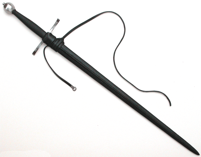

With some luck in the next 6 months I'll be taking delivery of a longsword that I'll be building a grip covering, chappe, scabbard and suspension for. I'm planning on doing a two-point suspension after the Trinity Altarpiece and and one of the Portinari paintings by Hugo van der Goes.
The clearest place to see these is on Albion's regent and viceroy scabbards. I like them for the ability to just unhook the sword from the belt, but I can't for the life of me find anyone who manufactures the buckles and fittings to do this and having done ones for my knight scabbard I'm not real keen on doing more. That sort of metalwork isn't really my thing.
