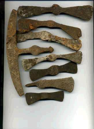

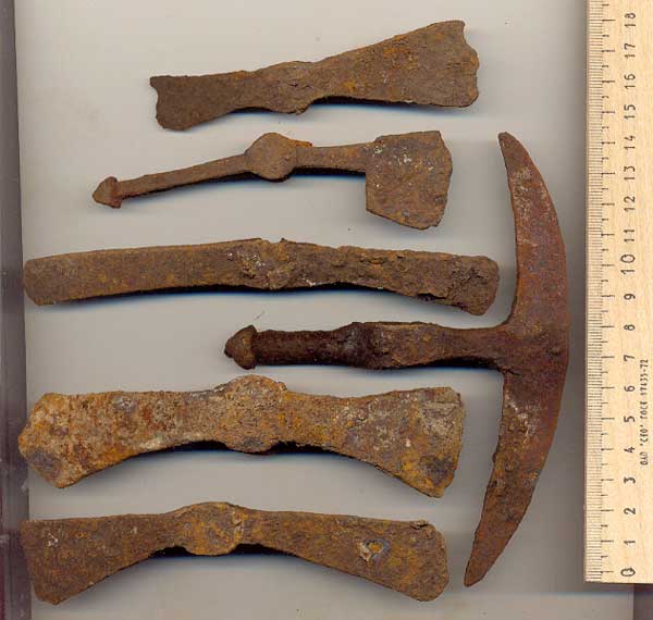

PostPosted: Wed 25 Jan, 2006 9:41 am    Post subject:         Reply with quote
Arrow
 Attachment: 19.61 KB
 Attachment: 37.8 KB

Nicola could you give us some information on these pics? They are very nice, but we need more to go on.

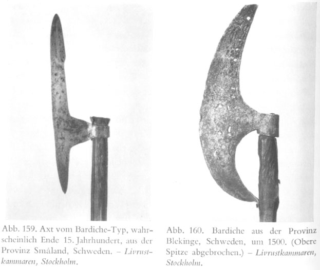

So I wake up out of a deep sleep in the middle of the night remembering I have seen another axe similar to the ones Wolfgang posted the link to and picture of. This of course raises the question what in the hell do I dream of in rem sleep but we will save that for the psychiatric analysis by the courts Happy
I of course now on a mission to figure out where I saw it. After much looking at books when I should be working I figure its gone and I won't find it anywhere.
Then yesterday I flip open Blankwaffen as I am talking on the phone and there it is staring me in the face. Can't believe I did not think of it right away when the discussion started.
Very similar with a straighter blade, though no back spike but I think one has to admit when looking at these examples that there would have been a decent range of variation in these and we now have 3 good examples.
