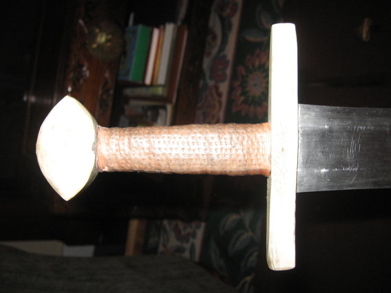

Just wondering how the medieval swordmaker would have described or called his pommel. Brazil nuts only come to the attention of western man after the 'discovery' of South America, and all our Brazil nut pommels predate that by quite a bit. So what were these pommels called back when they were making them ?
I heard such pommels are also called lentil shaped. Maybe ancients called it like that or had another everyday common shape similar to that to borrow its name to such pommels. Wink
Btw, I plan to take some better pictures of it, these were first pictures taken the evening I brought it home from tax office. Happy

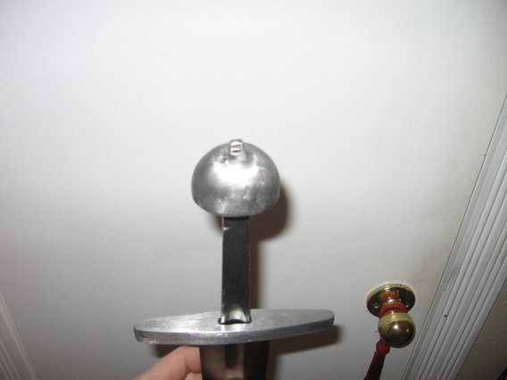

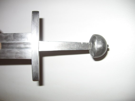

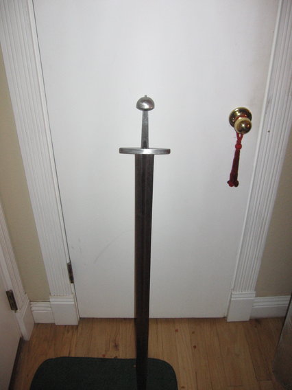

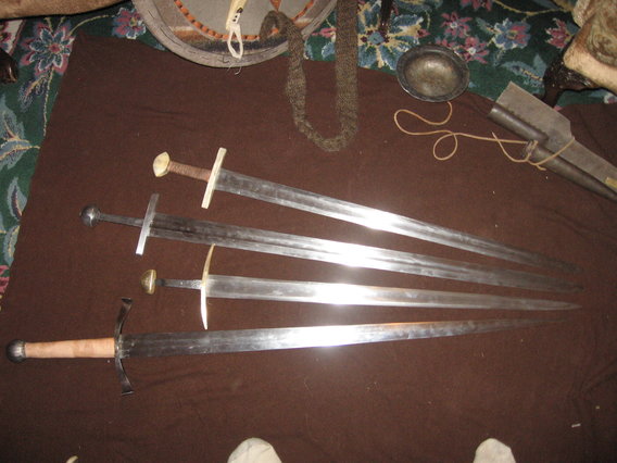

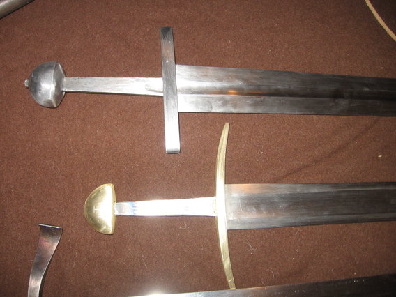

Here are a few really bad cell phone pics of some swords I am working on. The big single-hander has a blade from a Hanwei Tinker Great Sword of War that has been extensively reground, with some convex profile tapering past the fuller, a lot of distal taper in the last 25cm, much flatter edge bevel, straightened fuller and overall reduced width except at the flaring at the base. The hilt components were forged from mild steel and were inspired by several 12th century swords illustrated in Geibig's "Beiträge zur morphologischen Entwicklung des Schwertes im Mittelalter." The pommel is partially hollow. Blade length is just shy of 36", total length is 41.75", mass without grip is just under 3 lbs and cog is 6". The brass-hilted sword has a blade ground from a Hanwei Mercenary. Can't see it in these pics but there is a cross potent inlaid in tin on one side of the pommel. The other sword has cross of Cervus elaphus antler and pommel of Alces alces antler. The blade is ground from a Hanwei Tinker blunt.

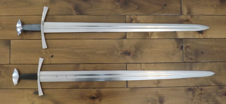

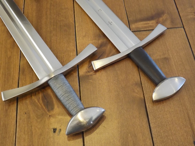

For the moment (until I sell my last Del Tin) I own both the Albion St. Maurice and the Del Tin 'Historical' version of St. Maurice (with a longer blade than the standard version). The Del Tin is not quite factory issue --I added a wire grip and did quite a bit of work on the blade-- but still I thought it would be cool to show them side by side.
The longer version of the Del Tin is still shorter by a bit more than an inch in the blade than the Albion, heavier by a couple of ounces (probably mainly in the pommel and cross), and has has a lower PoB (by 1.5" originally, 2" after my blade work) compared to the 9" PoB on the Albion. The Del Tin is actually somewhat easier to handle, but the Albion is clearly more accurate to the original in the length of fuller (its an Xa/XII whereas the Del Tin is a true Xa), the blade length and profile, blade inscriptions, and the lighter, more angular pommel. The Albion is obviously a more refined sword, but they both have their merits.
