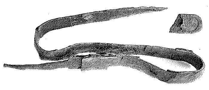

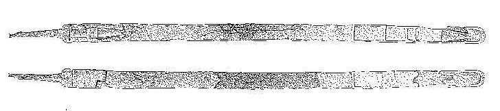

Some of the swords that are rusted into round-ended scabbards may very well exhibit sharp points.
This sword from the near the Belgian border illustrates this trend of round scabbard end/sharp point
 Attachment: 33.03 KB
illustration of sword and scabbard
 Attachment: 48.02 KB
sword as found in situ in the grave (ritually "killed")

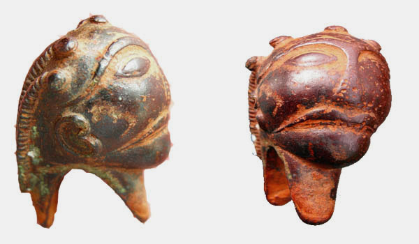

In 2003 whilst detecting on a large field in Gloucestershire I was fortunate to uncovered a large Bronze Age gold jewellery hoard,. This hoard contained 54 items of gold along with a bronze knife, which has been dated to between 1200-1400 BC.
It is now on display at the Corinium museum in Cirencester, and has since been called the Poulton Hoard after the area in which it was discovered..
But a more recent find is a bronze anthropomorphic sword pommel measuring 34mm x 22mm.
This object is quite spectacular as it shows the amazing workmanship and skill of Celtic craftsmen and is probably one of the best examples ever found in Britain.
The sword pommel from a La Tene III anthropoid sword hilt is in the form of a male head. The head has an elaborate hairstyle of five braids emanating from knobbed terminals at the forehead. The central braid is perforated near the top of the head for the end of the tang of the iron blade. The oval face has high arched eyebrows, lentoid eyes with eyelids indicated, a flat nose that joins the eyebrows, large ears and a wide moustache above a slit mouth. The bottom of the object has two triangular forked prongs projecting approximately 10mm from the head and forming a neck.
No other Celtic objects have turned up in the area so it had probably come loose and fallen off when in use.

Welcome Steve! And thanks for sharing your finds with us. I have to be honest: I find the sword pommel a lot more intriguing then the gold hoard Happy It's very interesting as casting, as sword-related find and most of all it gives a great view of an iron age person. He's got a very interesting hairstyle Happy N.b. I can't find the knife in the gold hoard. Do you have a close-up of the knife? (is it two edged, or single edged?)

Wow, an amazing pommel Steve, the hairstyle is quite something different, more reminiscent of our new age travellers.

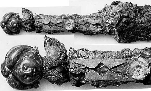

Hi Steve...
Welcome to the forum and thanks for sharing these finds with us!
Even in fragments Celtic swords can be amazing works of art. Big Grin
I have posted a picture of the grip of a Celtic Sword found at Bescheild Teir Germany. It also shows a cast pommel in the form of a head (although it seems to be more feminine.)
What is intriguing to me is that the pommel has the beautiful curves of Celtic forms. However, the grip is decorated with geometric forms more typical of earlier times.

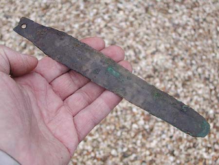

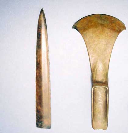

Thanks everyone for your comments, here is a picture of my Bronze Age knife which was found near to the gold hoard, and in the adjacent field, my friend unearthed a fantastic axe head and rapier blade.
 Attachment: 40.54 KB
 Attachment: 28.06 KB

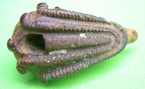

Hi Steve and all,
This is also my first post. Your pommel is excellent. I would guess that it is continental in origin, and, going way out on a limb, I would say from Armorica ca. 100-50 B.C. (The style is similar to heads on various Armorican coins, especially with regard to the hair)
I have attached pictures of another Celtic pommel that I bought from a dealer in Suffolk. No provenance, unfortunately, but given the similarity to the pommel from Norfolk, I would guess Iceni. ca. 50 B.C. - 50 A.D. H. 25mm -- W. 12mm D. 19 mm.
On both sides is a shallow concave channel where the "arms" would have fit. A hole is bored into the head above the left channel, presumably to fit a securing peg from the "arm". The base has a 6 mm deep hole. There is a 2mm deep concave channel that runs from side to side cut into the base and a 1mm deep concave channel that runs at a slightly off-set right angle to it. The overall appearance is of the head of a Philips screw with a hole at the centre.
I suppose that the mechanical arrangement was to prevent the accidental loss of the pommel by making sure that it would not move in its mount.
John

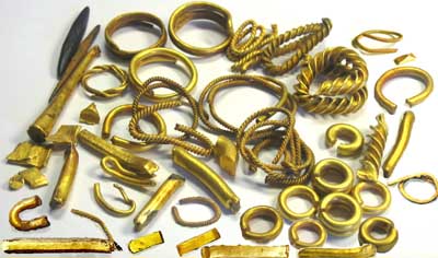

PostPosted: Sat 08 Dec, 2007 9:34 pm    Post subject: Silver torcs/British Iron Age         Reply with quote
Hi all! I posted the link to the La Tene sword but I thought I would trow this out for any advice/info. I own a pair of silver British torcs discovered at a dig in 1976 at St. Albans outside of London. It was in a large collection until liquidated last year and I bought two torcs from over twenty that were from the same large buried jar. Any ideas on the style or history of them?
Here are the photo links.
Thanks any and everybody!
Spencer Mills

The features of this pommel remind me of African sculpture, especially the features and hairstyle.

PostPosted: Sun 09 Dec, 2007 4:52 am    Post subject: Re: Silver torcs/British Iron Age         Reply with quote
Twisted bronze torques are common at the end of the bronze age/early iron age (see some examples here: http://1501bc.com/page/Geheim_van_de_Kelten/05260641.jpg). The spiral endings I've not seen before though, at least not in western torques.

Hi there! I am hoping someone can help me with the identity of this La Tene III sword owned by a friend of mine in Switzerland? Here is the link to the photos of it. She is a real beauty!
Thanks to anyone who can offer an idea.
Spencer Mills
http://www.quaero-et-adamo.com/english/latene_period_3_detail.htm
It looks a whole heck of alot like one of the blades Mr Bell posted above, other than the spatulate point....
Thanks for sharing that, I agree with Jeroen, that is the best preserved sword I've seen from that era. It just needs a new handle and a sharpening, and it would be battle ready.
The handle Mr Spencer posted (Celtic Sword found at Bescheild Teir Germany) is one of the best preserved handles I've seen.
Thank you, gentlemen, for this facinating and educational thread.
