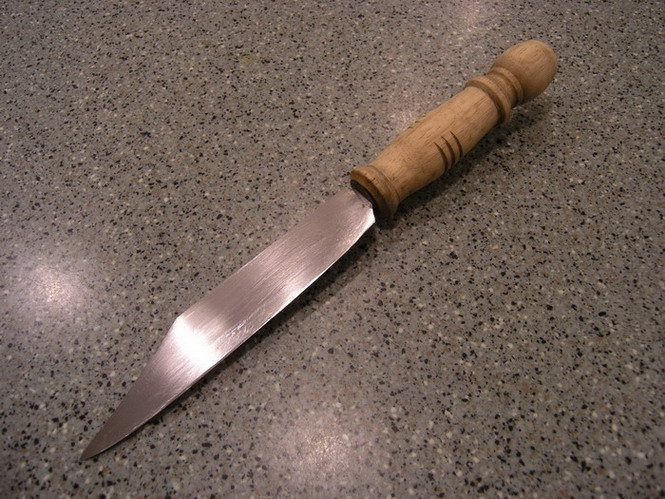

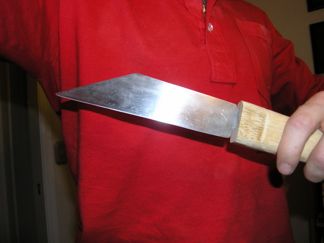

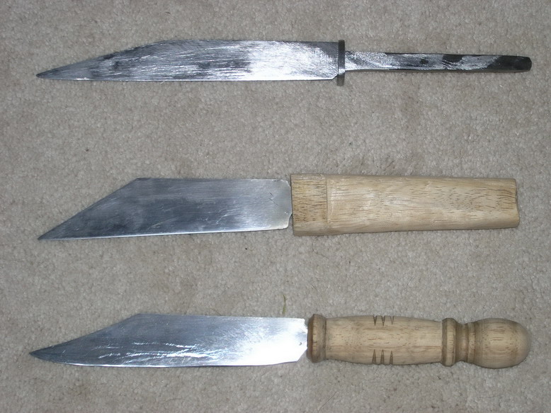

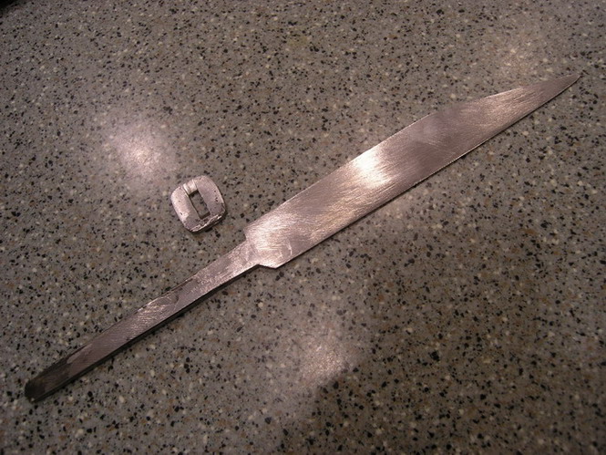

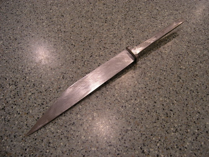

Posted: Thu 27 Dec, 2007 4:19 pm Post subject: my first blades |
Here's a few seax-like blades i've been working on. They are handforged/heat-treated from 9260. They are all hand-finished using files and sand-paper (well, they weren't quite "finished" yet). The handle material is from a rocking chair someone was throwing away on my street that i rescued...i have no idea what sort of wood it is. None of them are finished...all in various stages of progress. Still working on carving the handles, as well.
What do you folks think? Any suggestions on how to change the shape(s) to be more historically accurate? Just looking for suggestions for my next batch of blades I forge...I know the construction isn't that accurate (mono-steel), but for now that's what I'm going to stick with until i get good enough at forge welding to do more accurate constructions such as iron/mild-steel body and high carbon blade, and/or mild steel / high carbon laminates.
Dustin.
Attachment: 141.68 KB
Attachment: 144.13 KB
Attachment: 147.08 KB
Attachment: 144.27 KB
Attachment: 69.31 KB
Attachment: 144.22 KB
Jeroen Zuiderwijk
Posted: Thu 27 Dec, 2007 5:11 pm Post subject: Re: my first blades |
| Dustin R. Reagan wrote: | | What do you folks think? Any suggestions on how to change the shape(s) to be more historically accurate? Just looking for suggestions for my next batch of blades I forge...I know the construction isn't that accurate (mono-steel), but for now that's what I'm going to stick with until i get good enough at forge welding to do more accurate constructions such as iron/mild-steel body and high carbon blade, and/or mild steel / high carbon laminates. |
Looking pretty good Concerning the blades, the middle one is a bit too straight. Most saxes have slighly curved edges, and also the tip frequently has a slight curve (like the lower one). For accuracy, ditch the metal bolster. I've so far not seen a single broken back style sax with metal bolsters/pommels. For the hilt, I'd recommend a simple oval cross-section, flush with the edge and back of the blade, and fairly long. And I recommend looking for some really nice pieces of wood (ash for simple or fruit woods like cherry, apple for a more fancy hilt), they'll make them look so much better

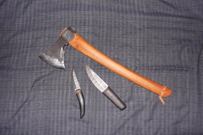

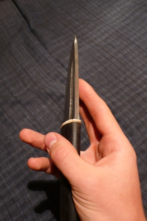

Posted: Sat 26 Jan, 2008 9:17 am Post subject: |
Hello Everyone!
These are three objects I made already 2 years ago, but it was not possible for me to get my hands on a proper hammer and anvil again.
At the time I had finished school in Germany and worked for 2 months at Gransfors&Bruks AB in Sweden and quite enjoyed my time.
The head smith over there, Lars Enander, showed me how to make axes that were already used in that region during the viking age. I was quite surprised to see the very axes I made all the time in the Svenska Historiska Museet in Stockholm a bit later, only the pieces there were about 1100 years old. I made this axe and some others with an additional cutting edge from high-carbon steel welded into the body of the axe-head.
The two damast-knives are the embodyment of my dreams I had at the time. I would never had dreamed that I would manage to do this. The guys over there took me asside after work and were really fond of somebody they could give some knowledge on. So first they thaugt me the very simplest of forging techinics, went over to welding and finally damast. I was in heaven.
The bigger knive was inspired from seaxes, has a small plate from deer-antlers and a hilt from moor-oak.
The smaller one is more inspired from later ages and has a black cowhorn hilt, fixed with hemp-strings.
At the moment I am studying in Munich, but I would love to proceed in forging.
greetings to you lot,
Jan

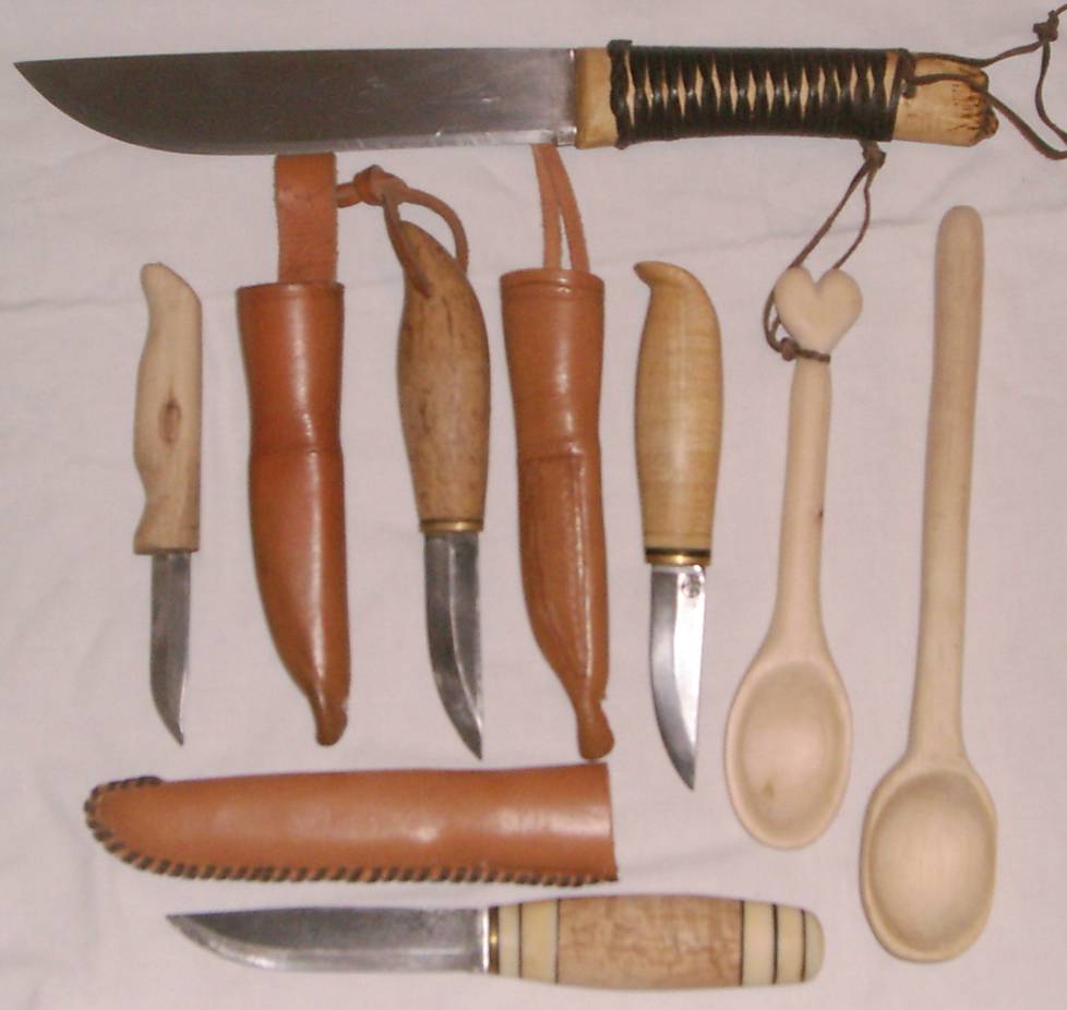

Stephan Hall

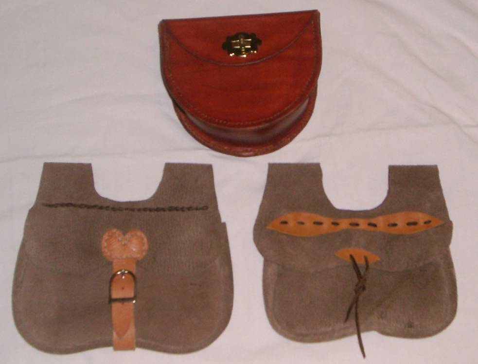

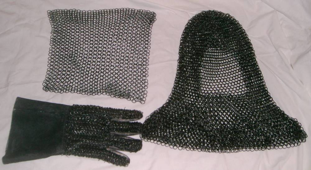

Posted: Fri 25 Apr, 2008 4:14 am Post subject: stuff you made yourself |
After getting an email from Tamás Tölgyes a friend of Adam Bodoric where he told me adam created more stuff than his grotesque warhammer ,I came to the idea to open a topic where Amateurs could show us what they have created, for their own pleasure o as a present but NOT FOR SALE!! So there is my stuff enjoy !!!![/b]
Attachment: 92.55 KB
My butted chainmail stuff [ Download ]
Attachment: 49.43 KB
Some leather purses, unfortunatly leather on the two lower ones is not period. [ Download ]
Attachment: 68.65 KB
some spoons and knive grips ... [ Download ]
