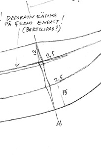

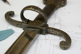

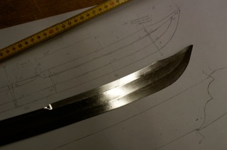

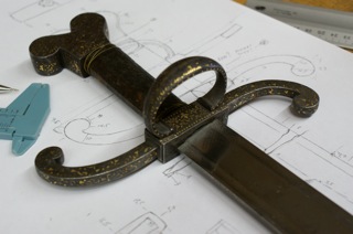

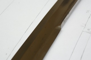

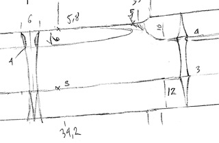

I attach some images of the Malchus and details of my tracing of the blade. To get an idea of the scale, you may note that the maximum thickness of the blade at the ridges of the edge bevels is 2.5 mm. You may note the form of the cross section of the edge and how it is sharpened. What you see is not the result of wear and tear. This is a pristine blade that may as well have been made a couple of years ago, not half a millennia. It was made to be exactly like this.
This well illustrates my dilemma. I see this extremely fine sword and I am deeply impressed both by the quality of its making and its design. Yet I know it is a difficult sword to make today. Not just technically as the skill level needed to grind a bade like this is high, but also in aspects of marketing and customer support. It is not a sword I would develop to be produced by Albion. The first time someone would take this sword to some small tree we would get reports of catastrophic failure since the edge probably would sustain some kind of damage if it twisted in the cut while caught in hard wood.
If someone would cut the head of a pig and accidentally hit the teeth of the animal, there would notches in the edge. The story about the softness and fragility of Albion made swords would live on for years.
Looking at historical swords I can only conclude that edge failure was not an uncommon result of sword fighting. Sometime swords had very fine and very sharp edges somewhat on the expense of some of their resiliency. Some swordsmen obviously knew how to make good use of such weapons and wanted to have blades just like that.
I know that by writing this, being the designer of the historically based swords that Albion makes, I am running the risk of perpetuating the idea that Albion makes swords that are not as strong, sturdy and resilient as the swords of other makers.
There is not much I can do about that, but hope my reply is appreciated as an honest attempt to bring some further basis for understanding swords and the nature of their sharpness by showing the result of some original research.
The swords I design for Albion have the kind of edges that original swords of the same type has. My hope is that customers appreciate the opportunity to examine such swords first hand to learn about the functional reality of the european sword.
The damage sustained on the Soldat in this thread can most probably be hammered out with a polished hammer without no great problem. *But* I think that Dustin should contact Albion with his concerns. Please do that Dustin, and let us know the outcome.
 Attachment: 23.57 KB
Hilt of the Malchus.
 Attachment: 13.69 KB
Back of the blade right at the transition to the back edge.
 Attachment: 23.43 KB
Showing thickness of blade at the base.
 Attachment: 17.53 KB
Complex cross section with central fuller and hollow ground edge bevels.
 Attachment: 17.16 KB
Drawing of cross section at point. Thickness of ridge behind edge is 2.5 mm. Thickness of edge drawn to actual scale.
 Attachment: 18.48 KB
Transition between back edge and false edge. Note the acuteness of the edges.
