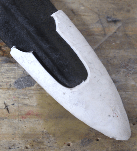

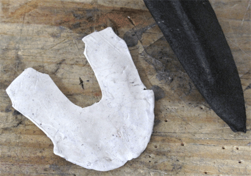

PostPosted: Mon 29 Jun, 2009 8:10 am    Post subject:         Reply with quote
The sword is finished but I want to finish the scabbard before raising the curtain on the project. I need to make a chape and a buckle. The buckle is easy. The chape is a challenge. I've experimented with a clay model (see photos below) but I'm not sure what gauge steel to use. I have 16, which seems too thick, and 22, which seems to thin. That argues for 18 or 20, I guess. Any thoughts on the gauge of historical chapes? For those interested, note that the photos below are in the correct order--I rolled out a thin sheet of clay, pressed that onto the scabbard tip, trimmed the clay to shape then cut it down the back and unfolded it. This form will be traced onto light foam sheet to create a pattern. I'm not sure I'll keep the design as shown. I'll probably exaggerate the cutout a bit to make it more gothic. As always, I welcome your comments and questions.

PostPosted: Tue 30 Jun, 2009 8:12 am    Post subject:         Reply with quote
did you think of trying to make your chape with paterns like on some gothic armors (sorry for the english)
here is what im trying to say by paterns on gothic armors: http://www.medievaltymes.com/courtyard/images...armour.jpg
PostPosted: Tue 30 Jun, 2009 10:31 am    Post subject:         Reply with quote
I do want a gothic look for this chape, which, to me, means deep curves and cutouts. The linden/heart motif was one option for the cutout. The trefoil/clover was another. I'll most likely just elaborate on the simple design I have here, deepening the curves and maybe rounding the cutout a bit, as seen on the knife scabbard chape below. My sword is not meant to be a high-status weapon, so I don't want to do anything too elaborate with the chape.
