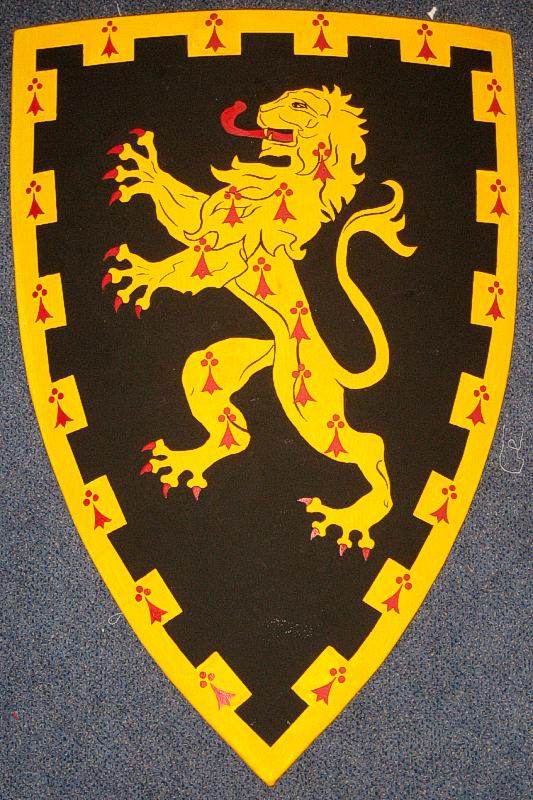

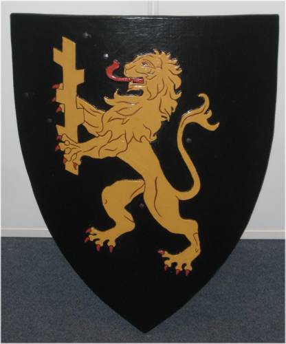

Hi!
My latest two shields - both have a 2x4mm birch ply core, a rawhide cover on the front and 3 layers of linen glued on with hide glue on the back. The one without the border has a raised charge made from tooled leather glued on and secured with tacks.
Christian
 Attachment: 20.5 KB
 Attachment: 96.14 KB

Christian, how did you pattern out your lion? it's very nice. I am looking to do one too and am not a very good artest

Chuck,
sorry for a most likely rather disappointing answer - the lion was provided to me by a good friend - who is now fighting with the second shield.
Christian

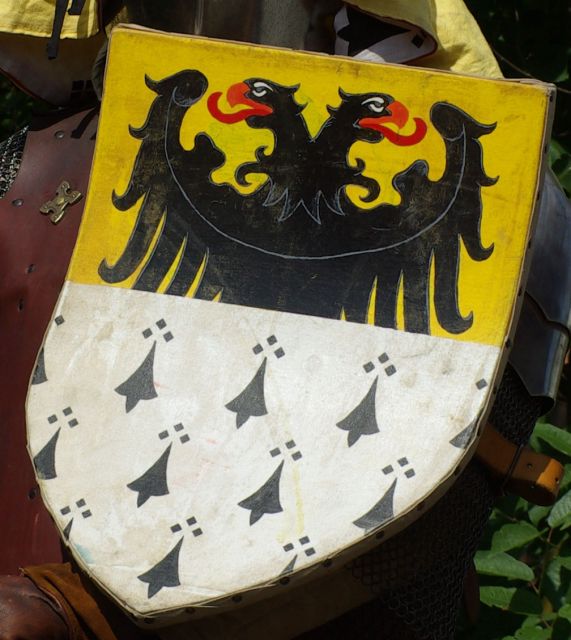

My first post and my shields.
I make handmade my shield and my girlfriends Agnes paints it. We use only medieval materials (lime-tree, linen etc. ) and techniques.
I would like to ask about your opinions.
Pavise. Breslau second half 15th Century. Orginal was lost about 1900.
jousting shield, compilation, inscription from Churburg (Ulrich IV von Matsch armour)
PS
I apologize for my English. Languages are not my strong side, i'm only archaeologist Razz

PostPosted: Wed 24 Jun, 2009 8:02 pm    Post subject:         Reply with quote
Arek Przybylok wrote:
PS
Don't worry about your English: a) it's fine, b) those shields are Fantastic.
Thanks for sharing,
Steven

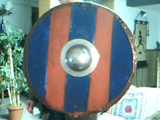

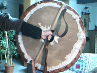

Good looking gear here, and on that note I present my Mark1, V.1. centre grip shield! Cool
It's made from scrap that came from the tip-shop, only things that aren't is the plywood and the boss, those are from the internets.
It's rim is dog chew toy that's been given one or two coat of brownish boot polish, then tacked in. With the tacks peened/bent.
Painted with cheap arse paint. And the material cover is 3 layers of cotton bed sheet, glued in with kids glue.
Handle is a piece of dowl, the guige is a belt.
The boss is about 2mm thick (held on with nails [that go through the handle] in the Gotstag{?} Ship style. Bent over Razz ), and the plywood is aboot 10mm.
All up, it's rather light (maybe 3-4kg?) and now I know what not to do with my next shield.
P.S. So long as it doesn't get wet, it's all good, otherwise it kinda begins to dissolve. Laughing Out Loud

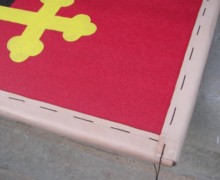

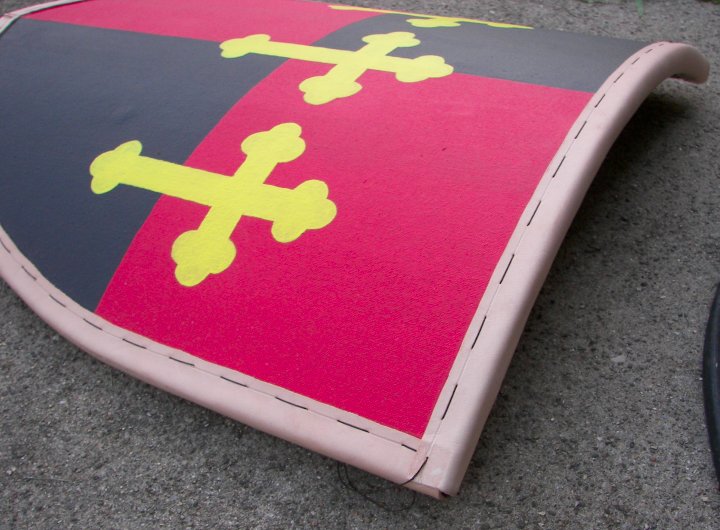

Actually, that is just two 1/4" plywood pieces. If you notice there are 6 plys, 3 plys for each piece. I will admit that for some reason this plywood was actually a bit thicker then normal and out of specs. It measured almost 5/16" of an inch, but the sheet was marked as 1/4". Most 1/4" plywood (pine or fir) will usally measure just a tad under 1/4".
I have included a couple of shots of the shield I am making with the blank. I am sewing on leather around the edges. I will temporarily sew the leather on (while wet), then then let it dry and form into shape (it is dry in the photos) I will then remove the leather, dye and finish it and then sew it back on. I will finish off the three "corners" with some additonal leather.
Ron Reuter
 Attachment: 66.43 KB
 Attachment: 77.55 KB

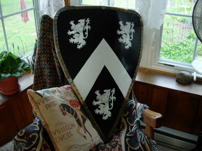

Jeff A. Arbogast
Joined: 16 Oct 2008
Posts: 180
PostPosted: Wed 16 Sep, 2009 2:39 pm    Post subject:         Reply with quote
The Black Knight's shield-courtesy of The Mercenary's Tailor.

Wow, that looks really nice Jeff! I keep saying I am going to buy a shield from The Mercenary's Tailor and something else comes up. It looks like I will have to move them up on my list of things to buy after a couple of other projects get finished. Did you provide the heraldric design you wanted on the shield or did Allen and the gang create it from scratch?
Scott
Jeff A. Arbogast
Joined: 16 Oct 2008
Posts: 180
PostPosted: Wed 16 Sep, 2009 4:20 pm    Post subject:         Reply with quote
Hi Scott,
Yes, I provided the design for them to copy-actually, it is based on the Raines coat of arms, supposedly derived from "Rennes" over time as the Bretons (in particular a certain Baron Hugh de Rennes of Brittany, an alleged direct ancestor of mine) who came over with Duke William were morphed into Englishmen over time after the conquest, and their names morphed as well. Actually, the chevron and lions are supposed to be silver, but for historical accuracies sake they are painted white, since metallic paints did not exist back then. So silver was always painted as white, and gold was painted as yellow. They did a real nice job I think, as the rampant lion designs I provided were pretty elaborate. I really like the historically accurate backside as well. Very thorough work all in all, and reasonably priced too.
