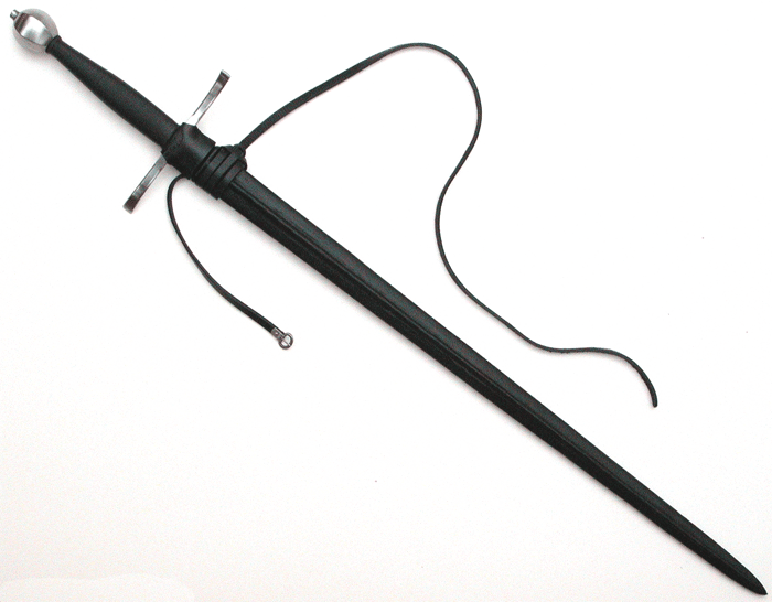

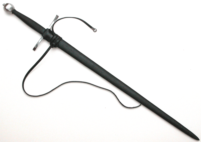

PostPosted: Fri 03 Jul, 2009 6:35 am    Post subject:         Reply with quote
Yep, I'll have lots of photos to share very soon. As for suspension, I'm using a narrow belt with the basic knot often used in this period. You'll often see swords of this length suspended by a single knot in a very narrow belt at the top of the scabbard. This is shown worn very loosely around the waist, with the right side of the belt resting at the natural waistline and the weapon low on the left hip. It's very simple and surprisingly comfortable.

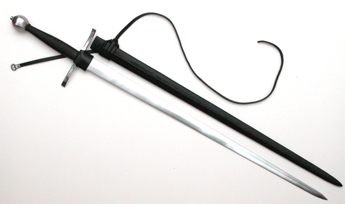

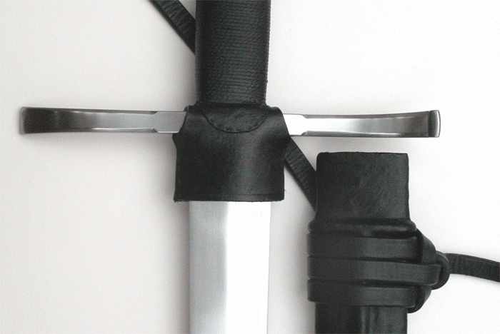

PostPosted: Wed 08 Jul, 2009 8:09 am    Post subject:         Reply with quote

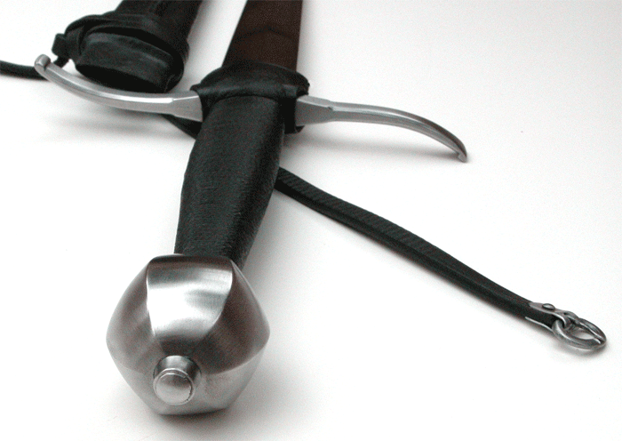

Well...I'll call this finished although I'm still struggling with the chape. The sword is 2 pounds 4 oz. Sword, scabbard and belt together are 2 pounds 10 oz.
Here are a few quick shots and a couple of images of similar suspensions. (See better shot of hilt on the next page).

Artis Aboltins
PostPosted: Wed 08 Jul, 2009 8:37 am    Post subject:         Reply with quote
Excelent work, Sean! The sword looks even better than I expected from the progress pics.
Bill Grandy
Location: Northern VA,USA
Joined: 25 Aug 2003
Reading list: 43 books
Posts: 4,194
PostPosted: Wed 08 Jul, 2009 8:43 am    Post subject:         Reply with quote
Sean, you never cease to amaze. I can't believe how well you transformed that sword. Wonderful work!
HistoricalHandcrafts.com
PostPosted: Wed 08 Jul, 2009 9:04 am    Post subject:         Reply with quote
Thanks! I share your surprise at the way this turned out. Laughing Out Loud

Julien M
Location: Philadelphia
Joined: 14 Sep 2005
Posts: 1,092
PostPosted: Wed 08 Jul, 2009 10:46 am    Post subject:         Reply with quote
Holy crap Sean!
You raised the customisation bar higher with that project no doubt. Starting from period art is also on my to do list.
Very elegant and clean work all around, and the fact that you worked on budget material makes the all thing even more interesting to me. I'm especially impressed by the grip and cross work, very clean lines...and I was sure your first scabbard would turn very well (all in all, a simple scabbard isn't that hard to achieve).
Are you going to keep the rain guard as plain? It seems to beg for a stamp or light carving of some sort.
How does it handle, has the point of balance moved forward a bit? (there is more wood on the pommel side, but the guard now being much further down the blade...).
Anyway, congratulations!
Julien
