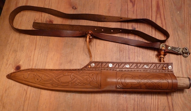

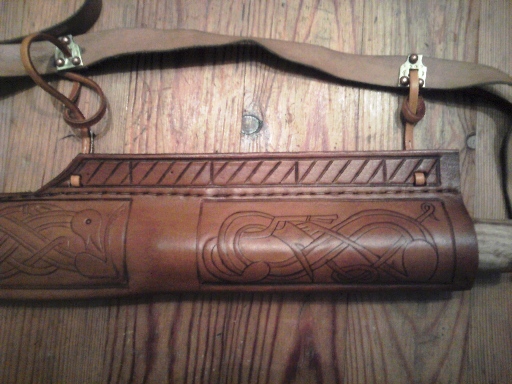

Some of my more recent projects.
Norman style belted Gaddhjalt
The Z-loop holding the scabbard can be seen on Sancho IV:s burial sword from late 1200s, but the earliest record is from an image in Ivar the Boneless life biography (art is from 11th century, but depicing mid 8th century when he lived). Several similar attachment methods can also be seen in the Bayeux tapestry. The belt is a typical Norman fork tounge style. Feels like a western revolver holster riding yout hip when strapped on, a perfect part of your body.
3 pieces make the belt, Z-piece, belt with strap holes and belt with fork tounge. They're stitched together with a peculiar seam seen on the Sancho IV sword.
Scabbard is pine core, oval hollowed and lined with lambs pelt with a firm but light grip. The draw is quick but the blade won't fall out if you hold it upside down. The core is covered with calf leather stitched end to end and water shrunk and casein glue laminatinated to the core for extra durability.
The blade is a sharp full tanged Hanwei Tinker line Viking replacement blade fitted with my own hand made Gaddhjalt fittings.

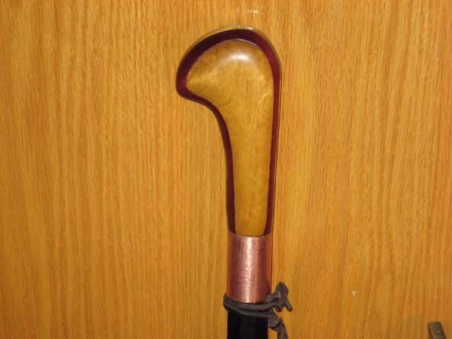

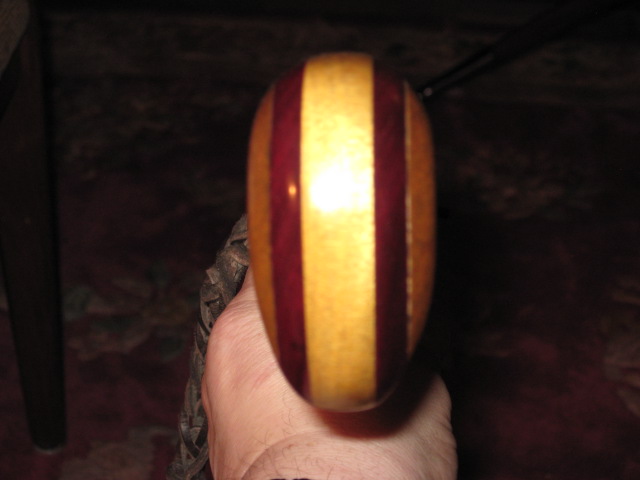

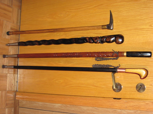

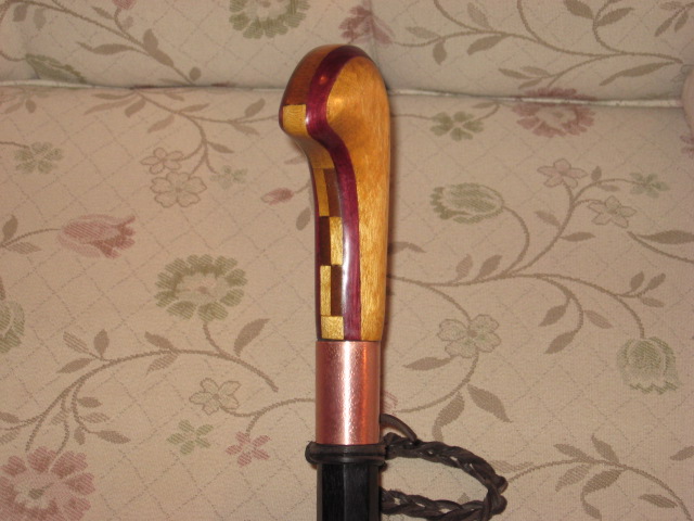

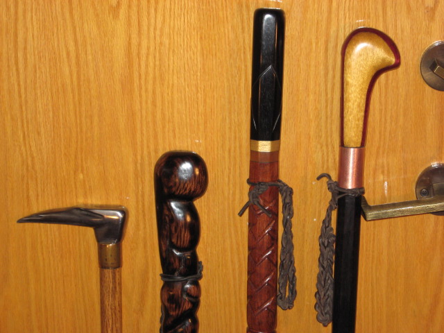

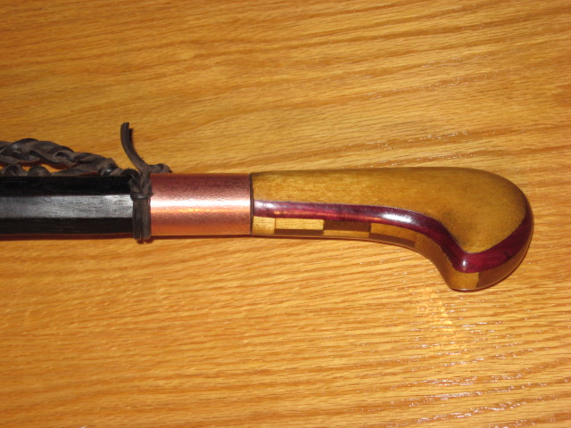

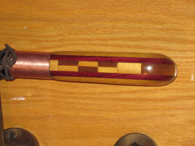

On the " Other " DIY project kind: Some of my walking sticks with more emphasis on the most recent one.
From left to right:
A) Prospector's pic repurposed and sculpted into an Eagle's head, made in 1975.
B) White Oak carved stick with a burned with a propane torch finish originally made in 1980 (ish ) but recently refinished to a higher polish and the addition of a steel butt.
C) Recently made Jatoba stick with an African Ebony head and Pau Amerello ( Yellowheart ) spacers.
D) My most recent stick with a Macassar Ebony shaft and a laminated head made of Paul Amerello and Purpleheart.
The Pau Amerello is almost fluorescent yellow when highly polished on the side grain and darker on the end grain.
Pau Amerello pieces with the grain running lengthways and sideways in a checkerboard pattern between two slabs of Purpleheart and with two external slabs of Pau Amerello.
Copper collar joining the head to the shaft + an 8" long steel pin 1/4" in diameter.
Steel butt epoxied and pinned in place.
 Attachment: 101.54 KB
Top to bottom A) B) C) D).

Close up of stick/cane heads.
 Attachment: 96.34 KB
D) Side.
 Attachment: 94.09 KB
D) Back.

 Attachment: 59.04 KB
D) Top, sorry out of focus.

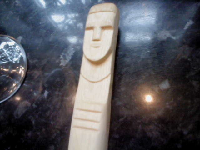

Not EXACTLY the pinnacle of human artistic achievement, but here's a cocktail muddler inspired by the sculptures from Nydam bog. No proto-germanic booze cabinet should be without!
Took an afternoon to make using a rather bad knife.
I finished it with walnut oil, but I would prefer something a little darker.

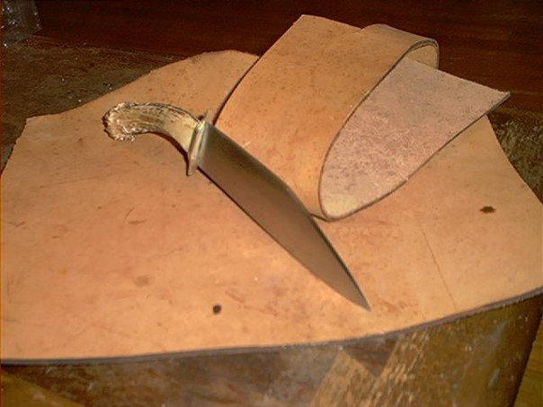

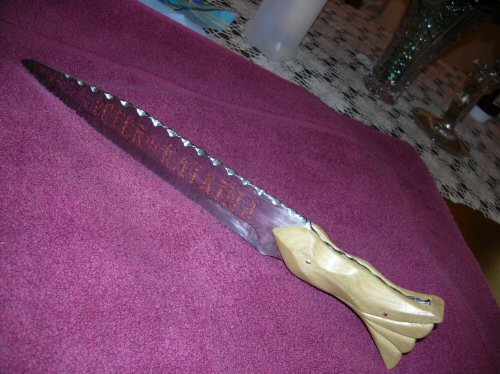

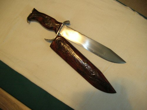

i can't believe i never used this post to show a little bit of the work i'm proud of.
i make knives mostly for myself. i try to use historical designs with just what works out for myself so my work isn't 100% historical. i haven't been working on any knives lately most of my friend like my wood carving and trinket making more, so i'm not making as many knives as i would like.
 Attachment: 83.75 KB
this is a knive project i called "the savage" i wanted it to look like a turn of the centruy american bowie knife, but it turned into this beastly thing.
 Attachment: 105.97 KB

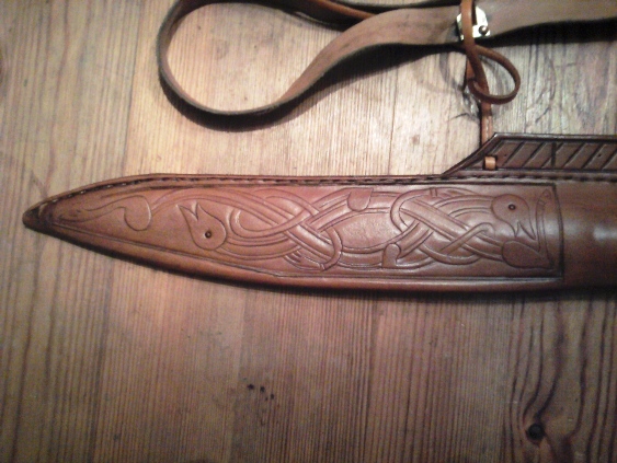

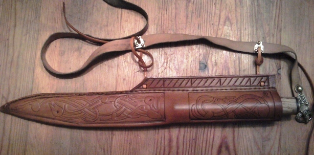

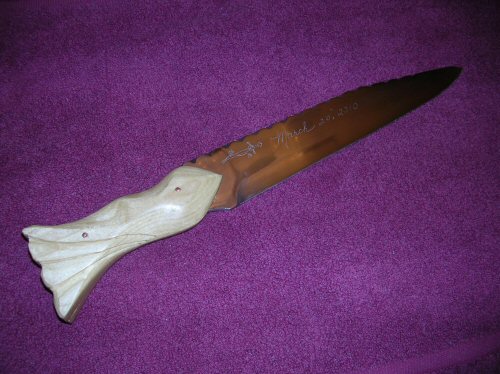

this is my favorite, it's a knife i made for a few friends of mine as a wedding gift. the blade is inlayed with brass for the names and copper. much thanks to Ben Potter who through email corrispondance helped me with the inlay process
 Attachment: 105.4 KB
this is just the back side of the knife other than the engraving work it's not too special. the bride loved the idea that i sculpted the grip in the fasion of a dress. another accent which i didn't photograph too well is the ridge pattern on the spine o

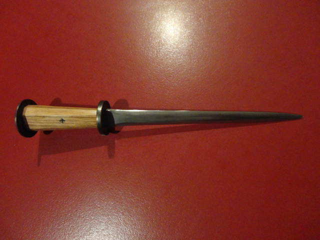

Basic Rondel Dagger made from Darkwood Armory's dagger kit. This is the first time I have tried to make a blade so it was a learning project, I couldn't put much detail to it for lack of tools so I figured it could be a munitions grade weapon or the likes. I took to it with an angle grinder for shape, then heavy to fine files followed by course to fine wet/dry sandpaper.
The blade has an oval shape to where it tapers from about the last 2 inches into the point. I did think about making the whole thing narrower in thickness though as a rondel I thought it needs that strength in the blade to punch through!
It has a fine edge though I have not yet put a sharp edge to it as I'm still learning that as well.
The rondels them selves have been blued slightly by gas flame, though this I was experimenting to see how it would be the grip is octagonal of 4 inches and is of oak, tightly fitted to the tang with very fine leather to help as spacers.
The entire piece is 14" in length with near on 9.5" blade. The octagonal grip proberly would look better on maybe a dagger with hex or star shaped rondels but it is what it is.
For someone who has not the tools or place to get the metal required Darkwood Armory's kits are good, and when I have some spare coin I'll proberly grab another couple as I enjoyed the project and could do better now that I have an idea on what to do..
cheers Jim.

Here's something I finished last night. The seax itself is nothing special, (just my old EN45 blade ground down to a 6th century pattern and rehilted with ash, horn none and brass) but I wanted to make a sheath for it that used an archaeologically provenanceable suspension method. The remarkably well preserved 6th century Groningen sheath has two double slits in it that show that it was suspended from thongs, so I combined that with the sort of metal belt reinforcements plates with holes in that you see in some burials of the same period (these are from Dover Buckland grave 56). The width of the slots on the two different finds was pretty the same.
The decorative work is all from the Staffordshire Hoard.
Whether by accident or design, the balance point of the sheath with the seax in is bang on the lower strap.
Overall, pleased. I'm going to use a couple of beads on the thonging at the upper end to cinch it shut under the metal fitting. That way it's adjustable and the whole thing can be easily taken off the belt.

And here's the same sheath with a couple of finishing touches added. A pair of amber beads provide the closure/adjustment mechanism at the top end and some embossed copper rivets on the sheath itself.
