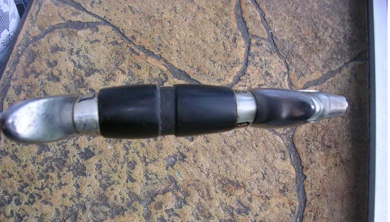

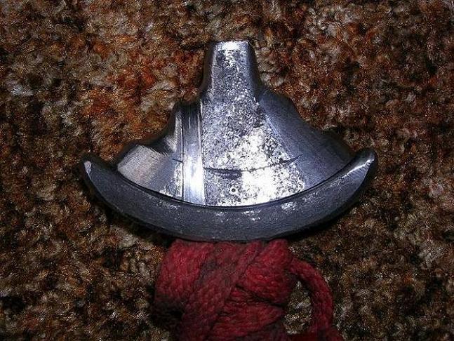

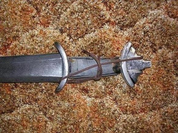

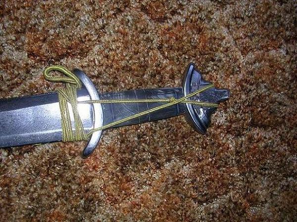

Seeing as you were such a help, I've attached a few pictures of the work so far.......for your scrutiny.
This is the first time I've really took any pics as the work has progressed,.....normally think of that afterwards!
The grip is horn. I'm not sure if these pics are going to come out in reverse order, Sorry if they do!
Attachment: 97.69 KB
Attachment: 97.35 KB
Attachment: 97.41 KB
Attachment: 98.44 KB
Attachment: 90.98 KB

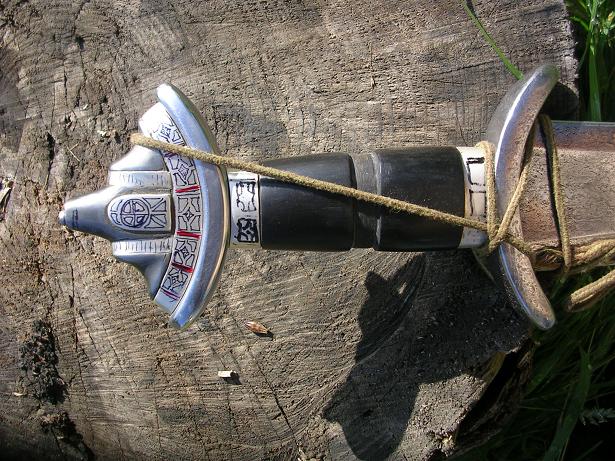

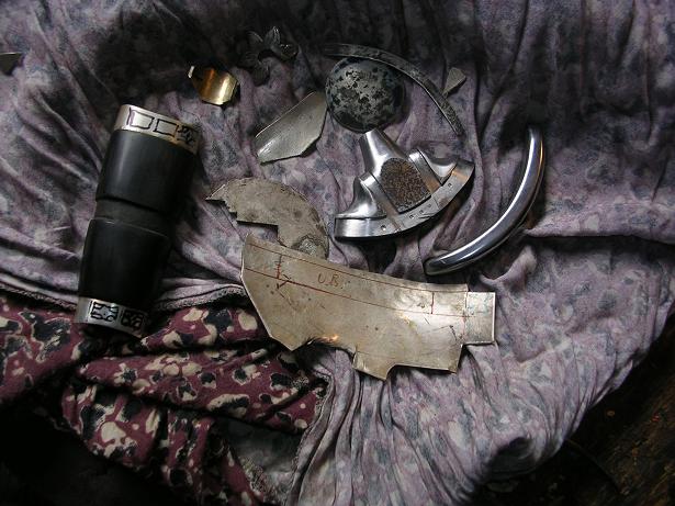

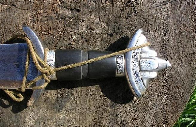

The last pics were taken back about February. here are a few more, sort of an update.
The blade is one I had by Vladimir Cervenka, 74.4 cm long w/out tang.
pics of the various bits, then with some silver attached, the with most of the silver attached, apaprt from one band on the grip, and the small band on the pommel top where it'll all be peened together.
It won't be an axact copy by any means, as I hadn't enough silver for 5 bands on the grip!!
R.
Attachment: 54 KB
Attachment: 63.37 KB
Attachment: 46.87 KB
Attachment: 49.51 KB
Attachment: 48.76 KB

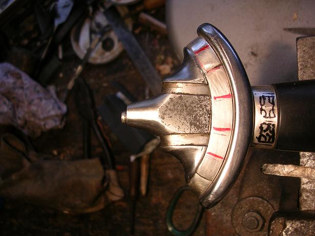

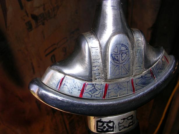

Here are the newest pics.
The pattern is just drawn on with a sharpie to see what it'll look like when I get the engraving done.
Many thanks,
Richard.
Attachment: 84.6 KB
Attachment: 99.03 KB
Attachment: 98.88 KB
Attachment: 55.93 KB

Tim Lison
Posted: Tue 18 Aug, 2009 8:56 pm Post subject: |
Richard-
This is looking really nice! However, I'm not sure how historically accurate the marker drawings on the pommel are Seriously, it looks great. The horn of the grip is very nice! Can't wait to see it done!

Sharpies have been around longer than most folks think!

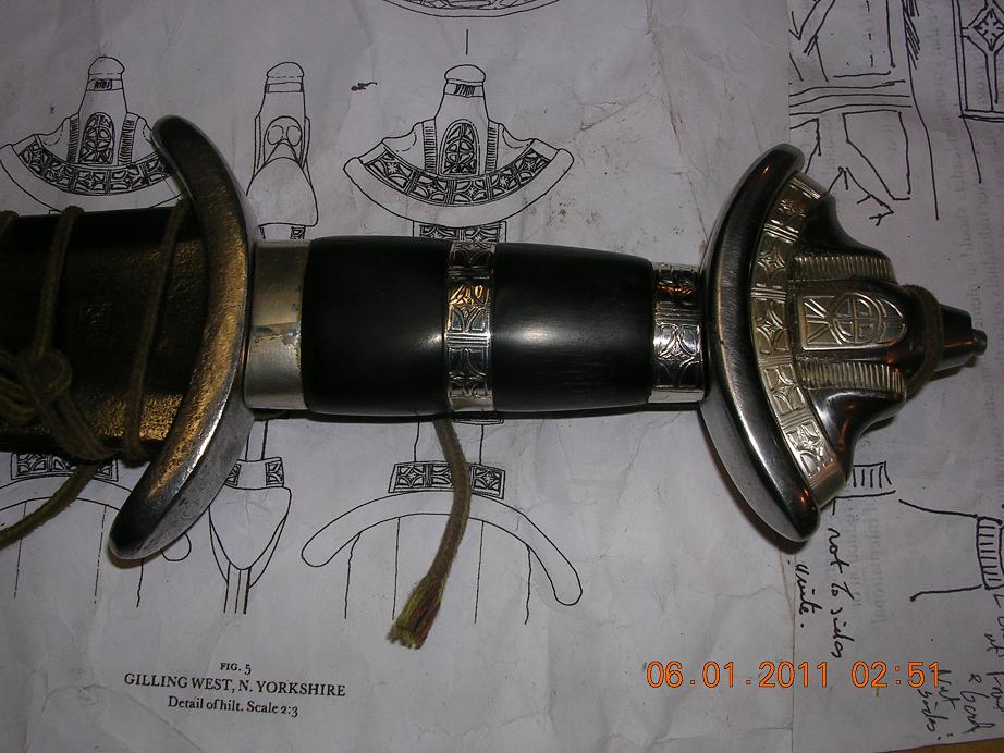

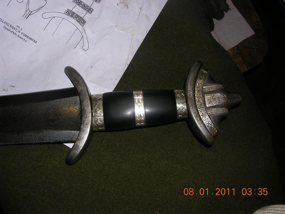

Richard Hare
Location: Alberta, canada Joined: 15 Mar 2008
Posts: 135
Posted: Tue 11 Jan, 2011 11:21 pm Post subject: |

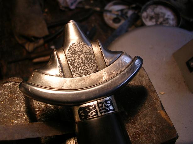

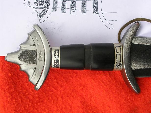

Seeing as we are ressurecting threads( Very interesting ones too!) on Viking age grips, I thought I'd update you on the Gilling West sword I'm making a hilt for.
I'm just making this for fun, it's not my work. (Farmer really..)
It seems it's a couple of years since I was at this project, but a few days ago I got back at it!
The pics are work in progress, and now I have her all rivited together, and it just needs the final silver band below the peened tang.
The blade is one of Vladimir Cervenka's.
Here are the pics;
Attachment: 101.25 KB
Attachment: 94.37 KB
Attachment: 101.29 KB
Attachment: 72.26 KB
Attachment: 107.96 KB

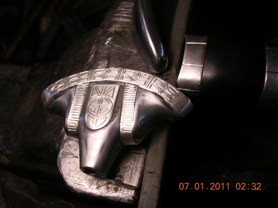

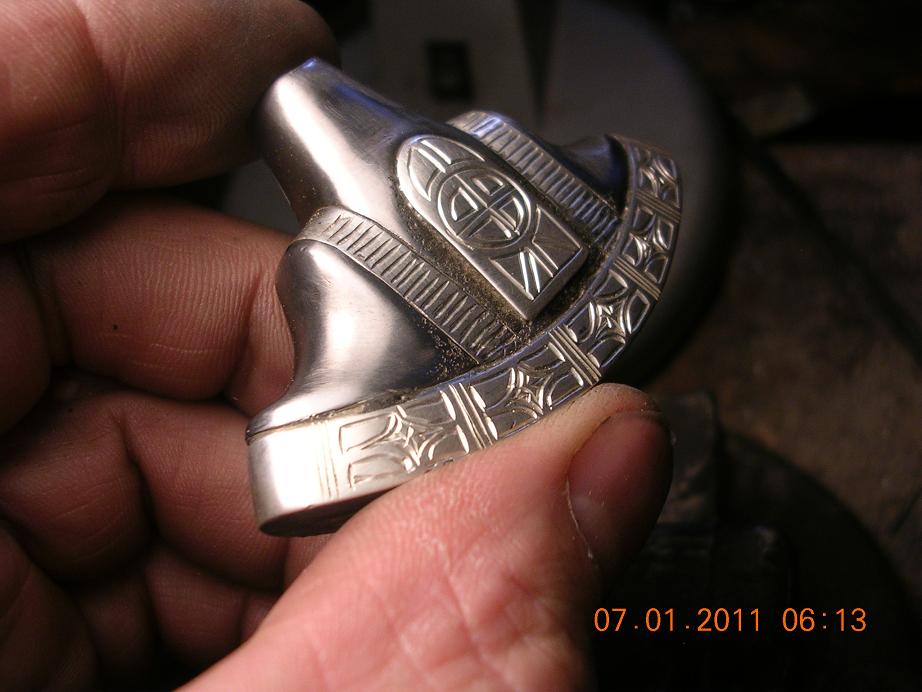

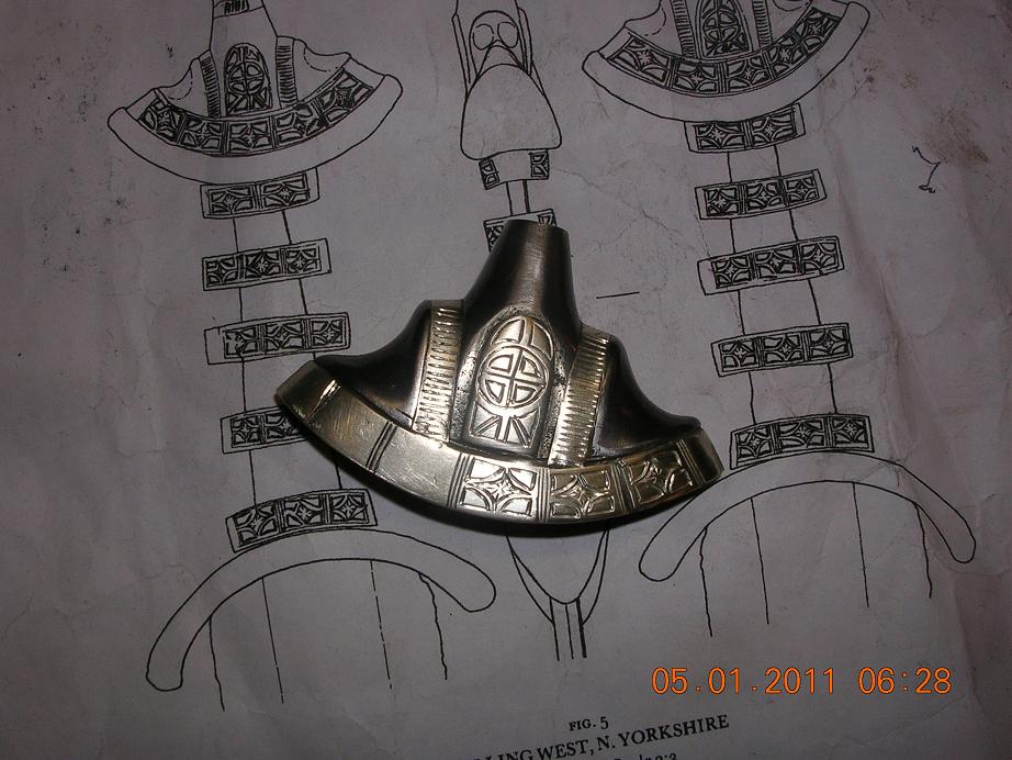

Richard Hare
Posts: 135
Posted: Tue 11 Jan, 2011 11:36 pm Post subject: |
Here are the few pics, engraving finish'd, and tang riveted, and now needs only the silver band below tang button.
All best,
Richard.
Attachment: 71.44 KB
Attachment: 109.83 KB
Attachment: 86.49 KB
Attachment: 86.19 KB
