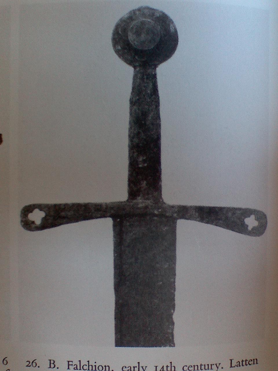

"The replica's pommel is unadorned steel rather than engraved brass, but its length and width closely match the original."
How do we know? Was this from the museum curator? I've never seen a color picture. Do they mention what is engraved?? The Conyers Falcion has a black hawk on one side and three of something else on the other.... Any idea what is engraved on the pommel? Is only the pommel brass? What about the quillons and rest of the hilt?
I have to say, I like the Vassals shape of the quillons better than the original Happy Gonna be hard to stick to the original rounded egdes... I don;t know... I'll have to discuss it with CF.... I would love to do an engraved brass Pommel... anythign is better than plain and boring, especially if the original is engraved... Brass is all the better too!
Chris Artman

Here are some pictures. One of them seems to be of the original Thorpe Falcion, the other is the Conyers Falchion. I would love to have an engraving like the Conyers on the Thorpe... I don;t see any engraving on the picture I have put here which is from "The Sword in the Age of Chivalry"

Well, I have never seen a color photograph of the hilt to confirm, but have only ever heard of the pommel being brass. I also have never seen a photo of the engraving....but an old drawing in the book Vanishing England, by P. H. Ditchfield shows at least part of the decoration...I don't know what's on the other side.

I don't see any engraving on the picture I have put here which is from "The Sword in the Age of Chivalry" which is the picture in the link below:

I agree that the Oakeshott photo doesn't seem to show any decoration....but the photo does seem to show much spotting on the pommel which could easily obscure any decoration. Also, it may just be my eyes seeing what i want to see, but if you look extremely closely, I believe you can see some of the decoration on the outside ring of the pommel that matches the drawing....and perhaps the tail of the beast on the center boss. That combined with the fact that the curator says there are beasts seems good enough for me....though like you I would really love to see a clear color photo.

Hmmmm... so that leaves room for interpretation. May as well do a bronze pommel with some engraving for sure....
All of that info was from the curator. Note this quote as well: "He said the pommel is brass with engraved images of animals and monsters."

Chris, I later went back to my copy of SAOC....and could see the beast quite clearly this time. I'll see if I can get a good scan of it later.

Hey Dan, any luck? I have sword in the age of chivalry, but I don't see any detail in that photo. It is a decent photo, but I see nothing on the pommel.
Which picture did you see the best more clearly? I'd love to buy the book if need be....

Chris, I'd definitely follow Sean's advice...as a good quality color pic is your best option.
However, this is what I was able to come up with.
The beast was still harder to see in my scan than it was just looking at the pic in the book.....so i took the liberty of inverting the colors to show it a little more clearly.
The second pic is my attempt to outline in red the parts of the beast that i can see most clearly.
