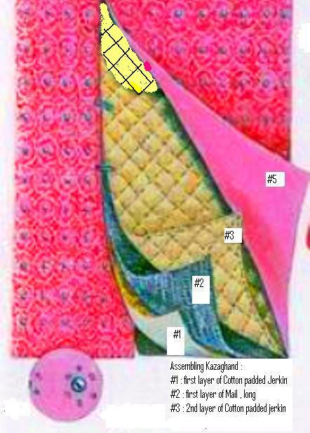

Who knows somebody who could make me a Kazaghand armoured shirt in a mid-to-late 14th C. kaftan cut?
It looks quite difficult, but I'm sure somebody here will know someone who can do it. Take a look, this stuff is awesome. I've read that earlier versions saved Saladin's life from assassination attempts a couple times. He apparently wore one at all times.
I'd really appreciate a referral to someone who can recreate this for me.
Thanks in advance you guys!
 Attachment: 47.27 KB

Had similar thoughts myself. I don't know anybody who makes one. But anybody who makes a suitable gambeson and does rivetted mail might be able to do it. Anybody who does good gambesons and is willing to work with mail might be able to build one, given a suitable kaftan as outer shell.
I was considering DIY, either starting with a gambeson like this one, or maybe a padded Uzbek chapan, or if I decided to go unpadded, or self-pad, maybe the right kind of Chinese robe (some knee-length candidates might be found on ebay by searching for "Shaolin robe" or similar).
Mail would either be from a large shirt cut and sewn on or from a large sheet of rivetted mail (or maybe lightweight stainless mail from Ringmesh or similar?). Stainless or galvanised, to reduce rusting if I sweat a lot into it.
DIY might be possible for about $500 or so at a minimum, plus time. Need to see the possibility of time coming up before it's worthwhile getting serious about it. Or, if you find a good maker, let me know.

I would vote for sheets of ringmesh for this project. It's welded, so it wouldn't catch the fabric, stainless so you could wash the garment, it's lighter than historic mail, but at least as protective, and you wouldn't see it anyway.

I like that ring mesh idea. Awesome. Thanks Matthew! I can see this being heavy. I intended it for under-armour as well...
Well, Timo... I have a "Persian Fitted Kaftan" pattern if you want one, mate. I also have examples of Mamluk Dynasty silk patterns if that's useful. It may be you're not after a Mamluk or Ayyubid one, though.
I'll definitely tell you if I find a good maker. I was thinking Steel Mastery, because they make all the necessary component parts and seem to have access to pretty much any fabric there is. I'll keep you posted!
