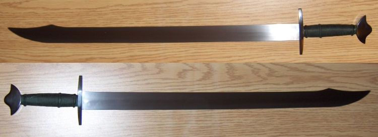

My Custom Archangel Falchion

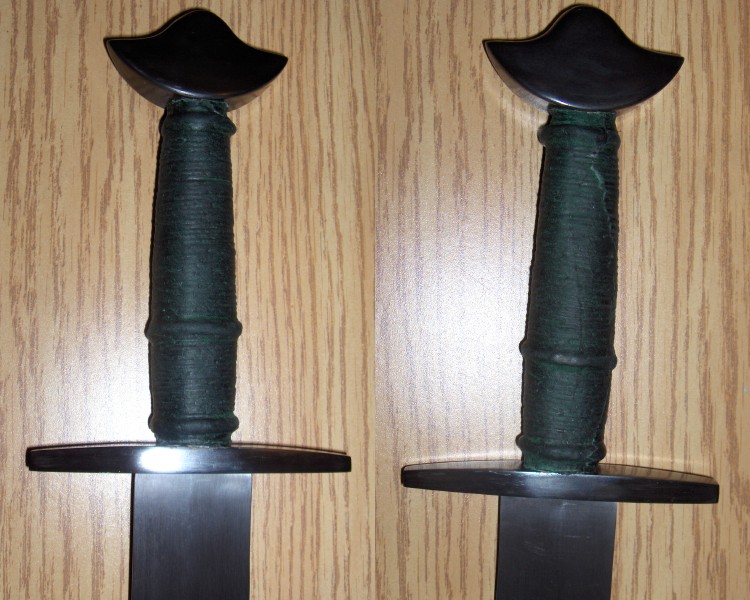

Closeup of the hilt - the guard is either a type 3 or a modified (shortened) type 1. The pommel is cocked-hat style. Both are blackened, which I think goes nicely with the dark forest green grip.

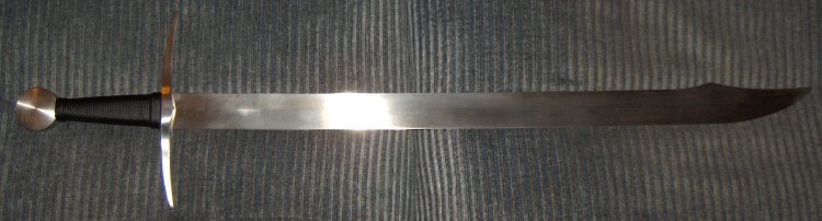

For reference, this is the sword with its original hilt furniture.
