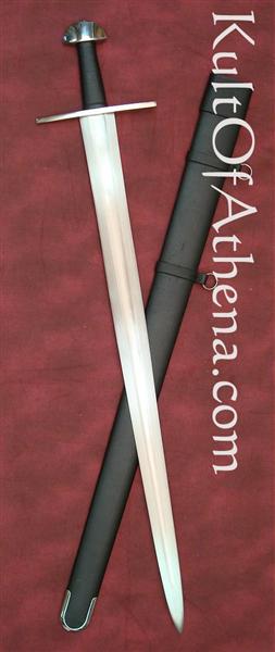

PostPosted: Sat 29 Aug, 2009 2:51 pm    Post subject: Hanwei Tinker Norman Sword         Reply with quote
This one looks like a great package for the price. Even the scabbard seems to exhibit a level of finish far beyond MRL stuff. I'm usually interested in later period swords, but that one might well be the exception.
If anyone has purchased one or is in the process to, I'd be interested in hearing your opinions on it.
Please post pictures!

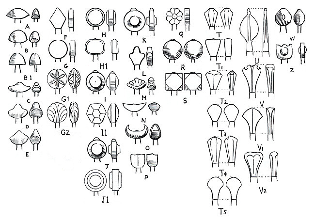

I'm a big fan of this sword type but something seems off to me in these photos, like the blade and the furniture don't match. It looks like the blade has a dull finish whereas the guard and pommel have a mirror finish. Is this right or is it just the photos?
Also, is the bottom of the pommel flat like a tea cozy pommel or partially rounded like the typical Brazil nut?
Anyone out there seen it in person yet?

Looking at the Cas Iberia web site, the sword looks like it has a curved bottom like a Brazil nut.
I'm tempted to say you are right, the hilt may have a higher polish than the blade. It would seem to me that would be an easy fix though. This is a sword I am really interested in. Brazil nuts have long been a favorite of mine, unfortunately it is rare to see a quality one in my price range.

I saw the factory prototype at the Blade show in Atlanta in June. The finish on that sword was a tad brighter on the furniture than the blade, but not glaringly so. The pommel was most definitely rounded in a brazil nut shape. The prototype felt pretty nice and lively in the hand. From what I have read in reviews about the swords on the market now some things may have changed. The prototype had been ground to a remarkably sharp zero edge from tip to guard. Tinker told me the guys in the factory had sharpened it along the same general profile as the hanwei katanas. The edge did not seem quite right to me, and it sounds like they are still fiddling with it. Overall it seemed very nice for the price tag,

I'd say it was a type B, rather than the classic Brazil Nut type A (or the tea cosy type B1)
 Attachment: 97.08 KB
Oakeshott Pommel Typology

Thanks guys, here's another picture that shows the pommel a little more clearly:
http://www.reliks.com/merchant.ihtml?pid=4465
I want to get some more Brazil Nut swords but I don't think I will know if this is the right one until its in my hand.

Curiosity got the better of me - I ordered one and it arrived today.
First impressions:
Historical Accuracy: overall a good rendition of a rather plain and general type X with a B pommel and a spike hilt guard. Its a bit on the small size for a post-Viking sword, but one can pull out historical examples with very similar dimensions. It does not have the classic blade profile of an X, which would be pretty much parallel for the first 2/3 and then gently tapering to a spatulate tip. This blade profile actually has a slight bulge in the middle followed by a sudden transition to a more narrow, linearly tapering second half. Kind of looks like it started X and then changed its mind to XII halfway through. However, if one looks at the variations in historical examples one can see that they are not all 'classic', so one cannot say this is wrong*. But see my notes on the finish below.
Handling: As the specs would predict, this is a very sweet handling little sword. The distal taper is much more developed than one normally sees in swords in this range, resulting in excellent balance and mass distribution without the need for heavy hilt components (which are in fact relatively light)- it is a real 'floater', especially compared to other swords of this type. It accelerates and stops with ease - very easy to control. The grip is just the right size and shape for this sword and provides excellent traction. The pommel is rather flat and slides easily along the palm for hammer-handshake grip transitions. If you don't like handshake, you can pretty much stick with hammer except at the most extended blade positions the pommel edge will hit the wrist. In summary, great, great handling.
Blade: the edge geometry is also superior for a sword in this range. The edge appears to be integral with the blade - no secondary bevel. So even if it is not super sharp from the factory, it should still cut like a demon (haven't tried yet). The manufacturer claims that the blade is harmonically balanced, and from what I can tell in dry handling this is true.
Scabbard: quite above average as well -decent leather over wood- and the swords fits nicely into it.
Fit: everything seems tight. I like that the blade fits snugly into the guard, in contrast to Windlass products.
Finish:
- The fullers are not perfectly even but pretty good
- The hilt components are refined in a very plain and simple way
- I just don't like the blade finish on Hanwei products. It has a very obvious machined look that screams out industrial age.
- Moreover, it clashes with the mirror finish on the hilt furniture. I guess both of these could be evened out to be more or less shiny with fine sandpaper (see Patrick Kelly's article)
- looks like the person who did the peening missed a few times and dented the pommel, no big deal**
So, it is not perfect. For that, one needs to pay at least another $500. In an alternative universe where all swords cost the same, I would rather have the slightly wider and more uniform blade of the Albion Reeve***, and I actually prefer swords with more blade presence, especially those from this historical period. However, I am not aware of another sword of this type, in this price range, that can deliver this level of functional quality and potential for performance. In fact, even if you have a Reeve I would still reccommend this Norman sword for guilt-free test cutting etc. Moreover, if the blunt version handles like this one it would be a great pick for someone who wants a sword with an early medieval look that can be used for fencing.
I would say that these Tinker-Hanwei and Fletcher/Trim-Valiant collaborations are really re-defining the middle level of the market in terms of combining reasonable historical accuracy and performance at a production scale. Hopefully Windlass catches on to this trend as well, I would like to see more of this happening.
-JD
PS - if there are any requests, I can take some pictures tomorrow (I'm off work this week).****
Editorial updates:
*I think I was expecting a blade profile more like their Tinker/Hanwei 9th century Viking sword, but assuming the profile on this Norman sword was designed intentionally by the Artist, one can't blame him for wanting to do something different.
**Looking again, the peen job was not sloppy. They simply did not polish it down afterwards, at least not as much as done on some swords. However, there are a few scratches on the guard that I missed the first time.
***Or, to be fair, the Tinker/Hanwei Viking sword, which only costs a bit more. But more cutting power on the blade always has a cost in terms of handling, so one can't have it both ways.
****pictures have been added below.

This "shiny furniture" and "satin blade" seems to be a hallmark of the Tinker/Hanwei line.
