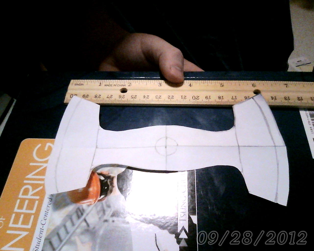

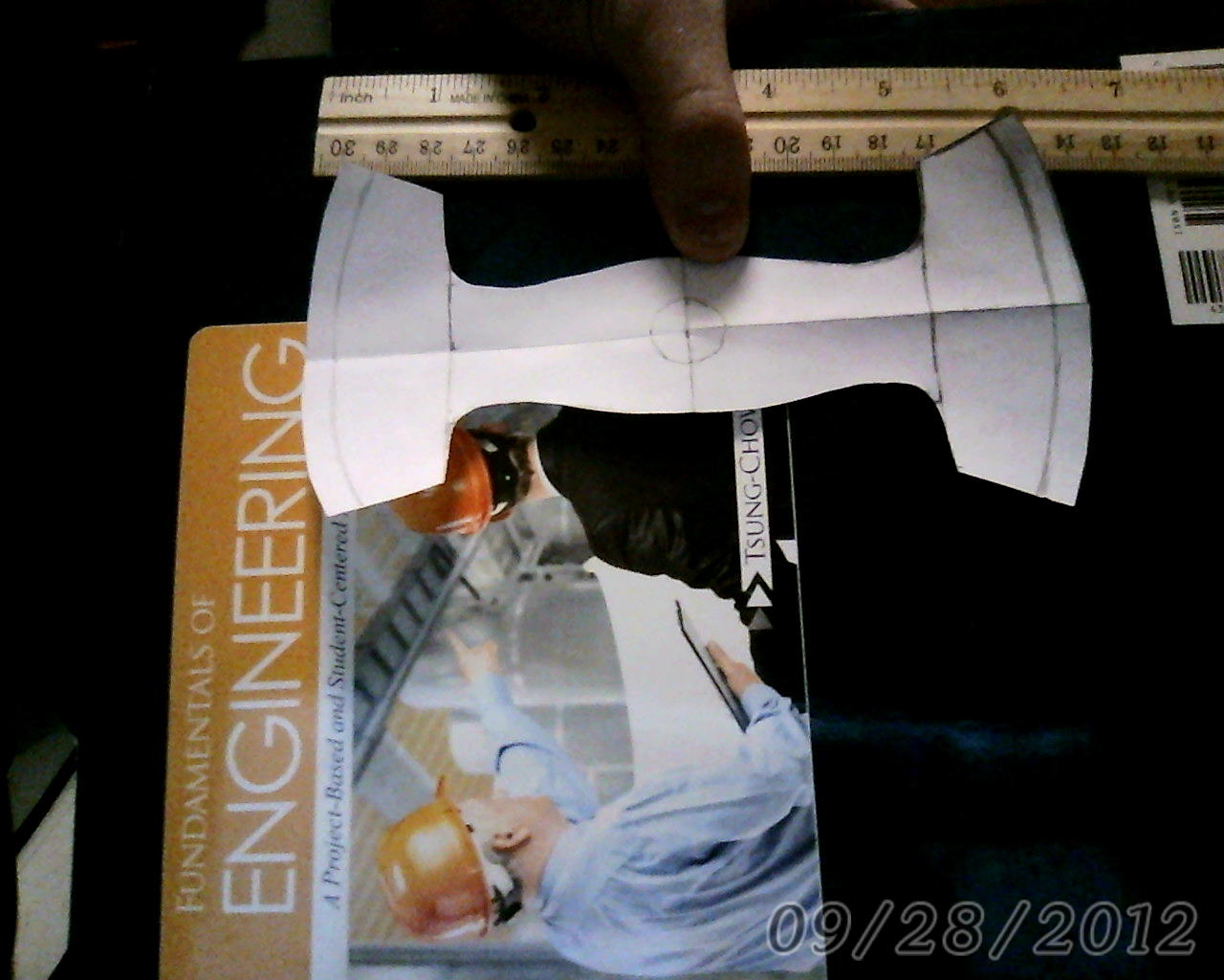

A photo of the basic design I'm thinking of for the baselard hilt
 Attachment: 127.88 KB
 Attachment: 125.76 KB

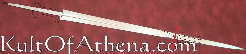

I'm thinking of cutting down a HT longsword blade into a 20"-22" wideish bladed shortsword and turning the clipped tip into a 8ish inch bladed companion dagger. the perfect set for inter pikeblock fighting after the press.
 Attachment: 79.71 KB
9 million hours in photoshop
wondering about using a waterjet printer to cut the blade without detempering it
