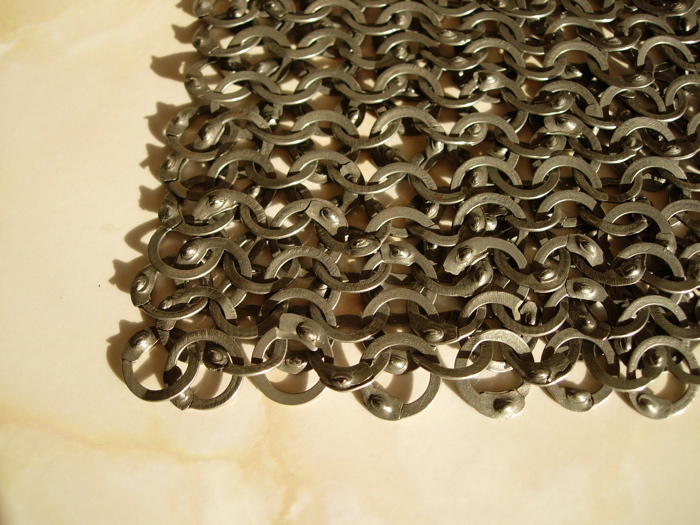

Here is a mail sample a vendor sent me. I am just curious what everyone thinks about it. It is flat-ringed wedge-riveted mail from India and it is pretty reasonably priced. The vendor says himself that it may not be the very finest available, but for the price (around $1300.00 for the coat, split front and rear, and tapering long sleeves) he doesn't think that anyone can complain. It looks pretty good to me without having to take out a second mortgage (if I even could).

I don't have a similar mail to compare, but for me the price is a bit too high: the armour is clearly handmade, but without great skill. Some links are off center, they will probably came loose or break...
Someone has a similar armour priced?

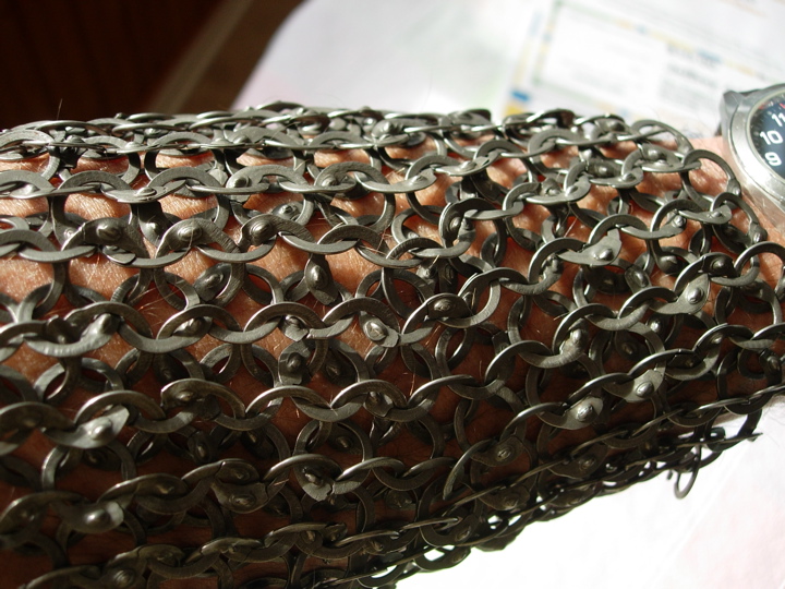

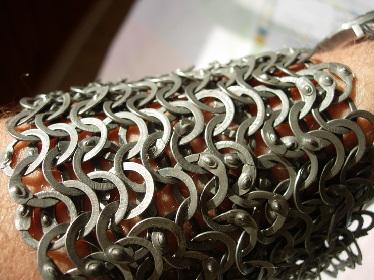

The ID to OD ratio is off. I am of the understanding that maille doesn't let you see that much table through it when well made.

Huh, I wouldn't have thought that. It looks plenty dense to me. But I mostly see Roman mail, and there may be a difference (since Romans mostly used alternating rows of solid punched rings and round-wire riveted rings). And it could just be that advancing age makes lighter, fluffier, airier mail that WEIGHS LESS very attractive to me!
Have to agree that $1300 still sounds a tad high. We've been getting sleeveless Roman mailshirts with shoulder doublings for $425 to $800 (the latter being 6mm inner diameter rings). But since this is all riveted, that might make it more expensive.
Good luck!

Here are another couple of pics with the mail draped over my forearm. As far as I can tell by measuring, the I.D> appears to be 5/16" and the O.D. appears to be 1/2." The supplier said that the weight of the hauberk is about 24 pounds. Long over-the-shoulder coif w/ small face opening adds to it though.

The quality is the same from all the above suppliers. So just buy the cheapest. It is fine if you want something that looks a bit like historical mail. The links are too light and the riveting too dodgy to handle combat unless you are capable of making your own repairs. Ask for galvanised mail. You may as well save yourself the trouble of keeping it clean.

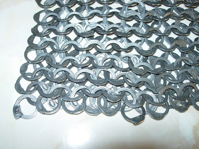

The cheapest I know of for flat-riveted mail is https://ssl.perfora.net/www.finditarmory.com/sess/utn154af73ad2551fa/shopdata/index.shopscript
$280 for half sleeve, $340 for full sleeve. From what I have seen the quality of the Indian made mail is pretty much all the same.
What I like about find-it-armory's is that from the pictures it seems to show some moderate tailoring.

Butted mail is heavier and can absorb more impact. With light mail virtually all of the blow is transferred through to the wearer. Underpadding is a lot more important.

Have to agree with Dan on the quality of the maille sample in the images, some rough edges on that.
