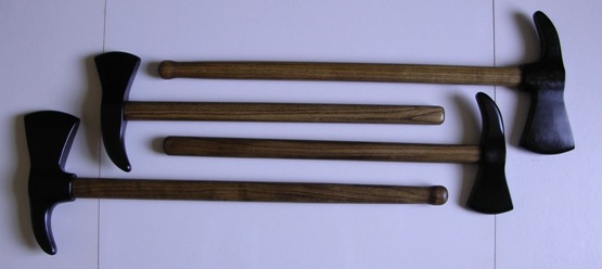

For ash axe hafts, I just buy a load of cricket stumps. Straight grained English ash, 28" long, 1 1/4" min. diameter. I can pick up half a dozen for just over £20 (less if I scour the junk shops). I use them to make hafts for the tomahawk and boarding axe simulators I make for the WMA guys.
Julian

Julian Reynolds wrote:
JG Elmslie, can I make a suggestion?
Julian
that is,as they say, dead cunning. I'll remember that for small sections of ash - thankyou.
I rather like the simulators you're doing there. Are those cast in RTV silicone, or the likes?
Regarding buying such hafts of course, there's just one little technical flaw...
I'm scottish. where can you find this "cricket" thing you talk about? Happy

Silicone is for wimps - they're made from hardwood (iroko, beech, whatever I have lots of at the time) sprayed black.
They're tough, effective, look authentic/traditional at 20 paces and hurt a lot less than a re-enactment metal blunt. I use them for 18th Century WMA/reenactment because you aren't wearing any sort of armour or protection (no plate or shields, for instance) at this time in history and therefore a metal blunt would just cause massive damage if it accidentally connected with sufficient force.....

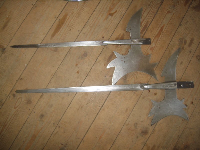

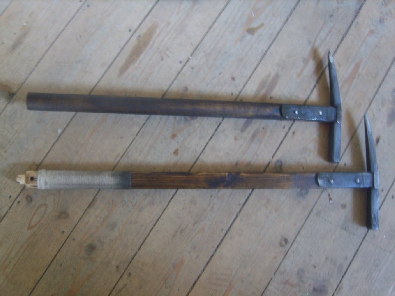

Slater's hammers work well too, I modified a couple a few years back although these days I'd rather forge and temper a head from mild steel. I like the idea of using cricket stumps as hafts but would love to find longer ash poles to use as hanlberd hafts, currently I use Homebase 35mm (1&3/8'') poles in softwood; thet look OK when oiled, but ash would be better, I just lack the time to cut and shape seven feet of hardwood myself!
 Attachment: 49.31 KB
 Attachment: 44.52 KB
 Attachment: 79.32 KB
 Attachment: 64.33 KB
