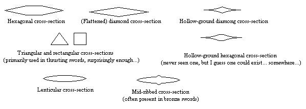

The term "hollow ground" refers to a blade cross-section (usually flattened diamond) with concave flats. The Albion Regent (http://www.albionarmorers.com/swords/albion/n...xviiia.htm) is a good example of a hollow-ground sword.
There is an illustration of a hollow-ground cross-section (among others) in the attachment. It seems to be somewhat flawed, though; most hollow-ground blades I've seen have been flat right at the edge, instead of concave. (Ugh, now that was a great explanation... Sorry, but my absolutely perfect English kinda got in the way. *g* Hopefully someone can explain that better...)
