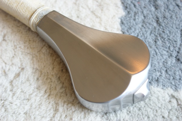

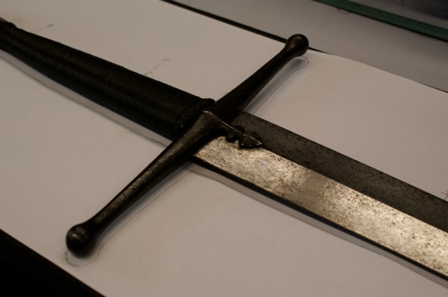

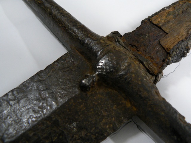

Both Alexandria and Principe are long gripped swords: they are long sword type swords. Both share the same blade, but have different tang lengths. Hilt components for the Alexandria is very much like the majority of the swords from this group of swords from the arsenal in Alexandria. The Alexandria will have a grip length of some 17.5 cm (about 7"). That is a good hand and half length. It may look shorter in the sketch since the blade is unusually broad. The pommel will be about 6 cm wide ( 2.4"). If you have strong wrists you can probably swing this sword with one hand, but it is large and pretty hefty even if the balance is lively, so it will perform best with two handed use (much like most other hand and half swords).
The Principe is basically a two hander, if nothing else because its long grip: about 21 cm (8.3"). The blade is pretty short compared to those very large two handed swords, but it belongs to this class of compact and powerful sword of war with long grips and moderately long blades. You may be able to use it single handed if need be (from the saddle?), but it will invite two hands for "natural" use.
Marko, I hear what you say about offering a smaller type XIIa blade that could be mounted as a long single hander as well. It is something I´d like to do for the NG line: a shorter hand and half sized XIIa. A smaller cousin to the Baron.
Christian, showing greater detail in concept sketches is a dilemma. If I draw larger images that goes more into detail I am bound to make waiting customers disappointed. These are concept sketches. They are intended to show preliminary ideas for the design. There will probably be some adjustments when I start working in full scale and 3d. Usually this does not involve dramatic changes, but some variation is inevitable. With the concept sketch I show proportions and type of components.
I attach below some photos of similar hilt parts. Perhaps these will give you an idea of what I intend for the Principe. The pommel is from a sword I made for Solingen last year that is of the same type I intend to make for the Principe.
One of the guards is form a sword in the Castillion group and the other is a rather famous two hander from the Wallace Collection. Both these guards will inpact the design of the guard for the Principe. The components for the Principe will not look exactly like these, but will be of the same type. The pommel will be more voluminous (more round instead of flat) and probably have more deeply hollowed front faces. Final shape and proportion of the pommel is decided as I establish the balance of the sword. The guard will be a combination of the two original guards.
Hope this helps to get a clearer idea of the idea for this design! (and perhaps show how I often work?)
