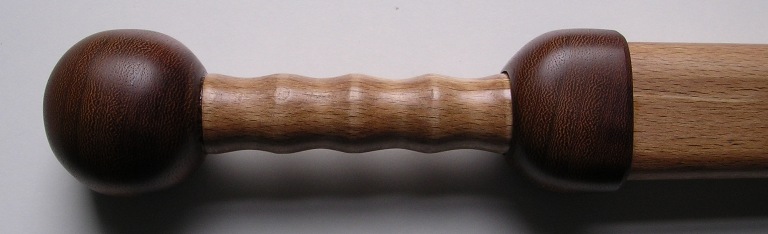

Here's a Rudis I made couple of months or so ago. Blade/grip etc. is one piece of beech, fittings are iroko. I finished this in several coats of danish oil (the first one cut with turps to let it really soak in). It's my first time at making one of these, call it an experiment....

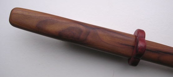

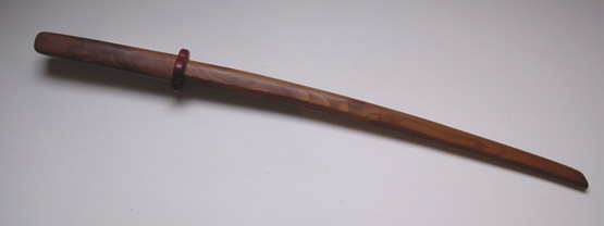

Another experiment - a year or so ago, I thought I would have a go at making a bokken, from a nicely figured piece of antique mahogany (not intending to use it - I don't do oriental martial arts - just for something pretty to pick up and play with...and a test of my woodworking!). I didn't own one to copy from, so I did it entirely by eye from pics on the internet. The tsuba is a quatrefoil in african red padauk. I had the chance later in the year to compare it with a real one, and it was almost identical in size, curvature and balance - luck guesses all 'round!

@ Julian, great work love the grip detail.

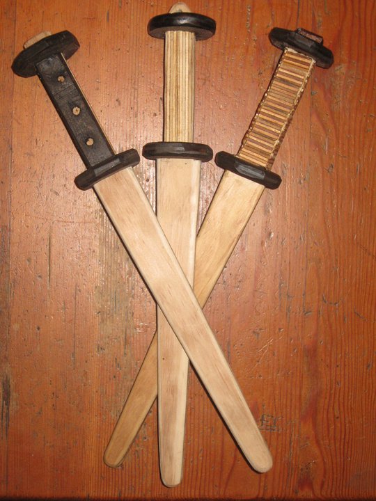

I designed these in such a way so as that they can be mass-produced, still have some custom options, and cost around $9.00 a pop.
They are (that is, I can make more dependant on demand) made for the group/s I'm in. If you break one (which would require you to snap it over ones knee as hard as you can) they're easily replaceable.
 Attachment: 85.97 KB
5-ply, 43cm long overall, 10-11cm grip, three part modular design, stained and given a coat of boiled linseed for colour.
