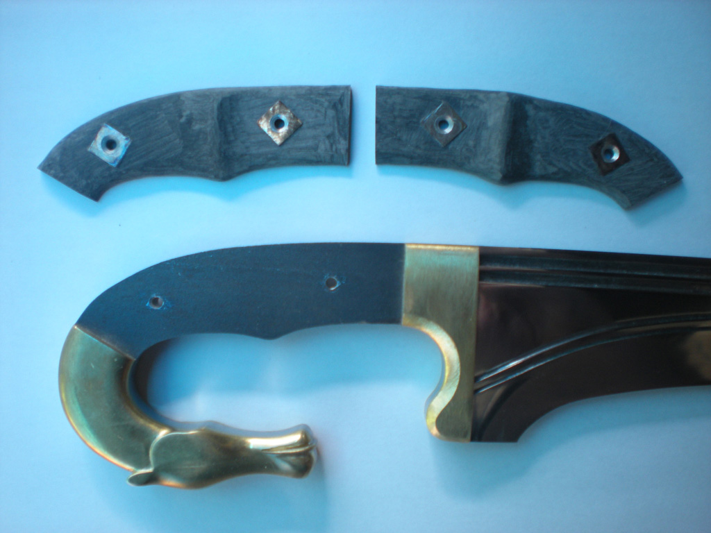

Hi guys.

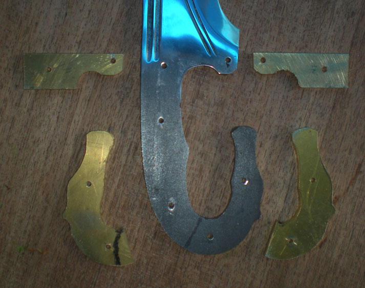

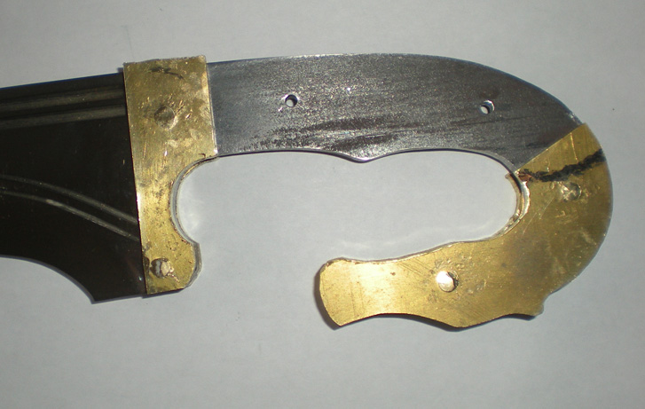

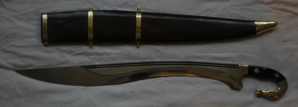

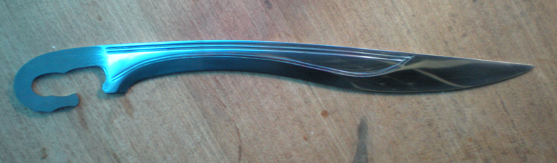

I thought i would post these pics showing some of the construction stages of a Falcata i made for a customer. I was going to post them a while back but i have been a bit busy of late working on a vendel Helmet. Anyway, hope they are of interest to someone Happy
 Attachment: 168.85 KB
Stage 1. blade done
 Attachment: 106.7 KB
Stage 2. Parts cut
 Attachment: 96.57 KB
Stage 3. Parts riveted with Brass rods
 Attachment: 49.87 KB
Completed sword [ Download ]
 Attachment: 168.47 KB
Stage 4. All rivets and parts cleaned up. Grip parts ready [ Download ]
 Attachment: 247.52 KB
Stage 5. All detail cut in and cleaned up [ Download ]
 Attachment: 92.99 KB
All done [ Download ]

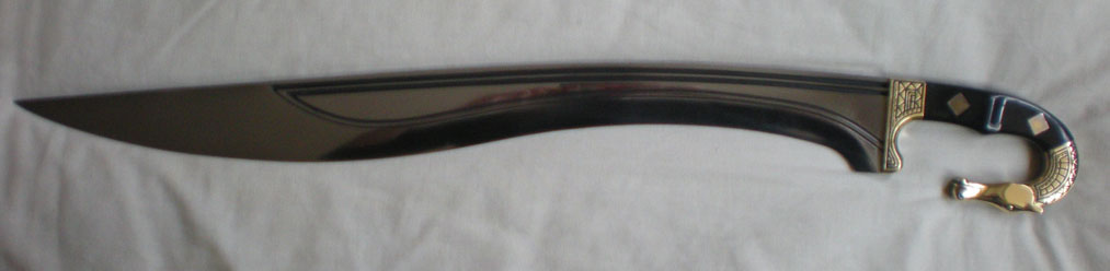

my one question, how long is the blade and how heavy is it, ok thats two but meh...

the blade is 521 mm measured along the back of the blade from the brass grip plate, and it weighs just over 1kg

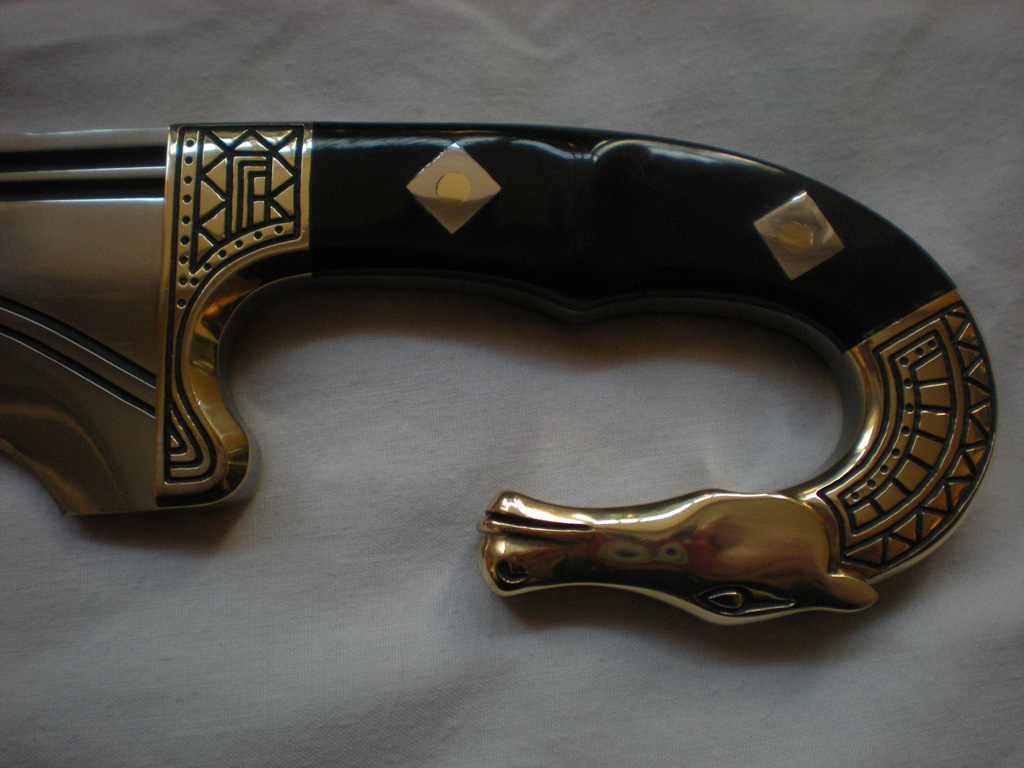

Really beautiful sculptural work on the horse head Paul. It suits the blade and the whole thing has a nice flow. I like the dark incised lines against the bright brass. Can you tell us more about your brass shaping process? Do you use hand files? Power tools? Did you happen to take and progress shots of the sculpting? Very impressive and very lovely.
Paul Holwell
Location: East Yorkshire, England
Joined: 13 Jun 2011
Posts: 24
PostPosted: Sun 25 Sep, 2011 8:20 am    Post subject:         Reply with quote
Hi Guys.
Thanks Nathan, I hope to share a lot more as i produce more work.
Hi Phil.
Hi jesse.
To answer your questions, sorry to say that i don't have any pics of the shaping process. I will try to describe best i can.
First i mark out the detail for the main features (mouth, eyes, nose and head to neck line) Then i use a small barrel sander in my multi tool to round out the neck to match up with the grip, not going too close to the head to neck line. This i would use a very small rotary cutter to get close to the line and then clean it up with a micro file. For the head i would use the sander again to form the shape and cut the detail in with a number of different cuters. For small sanding and shaping i find the diamond coated bits very good (esp round the eyes)
When i have marked out the patterns i want for the line work, i use a round tip cutter of around 2mm dia which i have ground down to a saucer shape so it looks like a small sprocket. I find this gives a vary sharp, light line. Then i open the lines up a little with a fine tip diamond coated tip, or if i want a very small sharp line, i use a micro file with a ground tip in the shape of a tight V. Pushing this down the lines can give a good clean sharp effect.
When done, i sand out the scratches with fine wet or dry, finish off with solvol autosol chrome polish with fine wire wool. Then use a very dark grey matt enamel in the details and clean of exess with stiff card when dry.
Hope This Helps.

You drilled the rivet holes post heat treat? Is the tang that soft or did you use a carbide drill?
Paul Holwell
Joined: 13 Jun 2011
Posts: 24
PostPosted: Mon 03 Oct, 2011 3:51 pm    Post subject:         Reply with quote
Hi Tod,
Yep, The tang was hard to get through, I used up a few carbide bits on those holes. Best to keep the diameters small Happy
