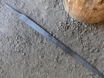

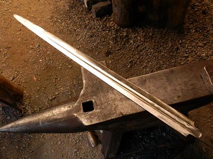

2 days since I commissioned this sword, and here's what Jeff just sent me. Is this a magic trick?
 Attachment: 50.27 KB
 Attachment: 47.45 KB
Luka Borscak
Location: Croatia
Joined: 11 Jun 2007
Posts: 2,307
PostPosted: Mon 07 Nov, 2011 4:30 pm    Post subject:         Reply with quote
??? Unbelievable! Eek! In a great way, of course. Happy
J.D. Crawford
Location: Toronto
Joined: 25 Dec 2006
Posts: 1,906
PostPosted: Tue 08 Nov, 2011 4:39 am    Post subject:         Reply with quote
You said it Luka. I gather there's still a lot of work to be done on the blade, and I don't think its been tempered, but still I'm amazed how quickly this is taking shape. And that's a handsom looking blade so far. Apparently Jeff has to get back to his day job as a blacksmith for a few days now, but at this rate I don't expect we'll have to wait long for more progress shots. If anyone has further information on the original sword, please pass it along soon before Jeff is finished. Happy
Tim Lison
Location: Chicago, Illinois
Joined: 04 Aug 2004
Posts: 1,606
PostPosted: Tue 08 Nov, 2011 8:48 am    Post subject:         Reply with quote
Man that was quick! The blade looks nice. I think he did a great job at capturing the look of the original. Very interested in seeing more progress on this one!
J.D. Crawford
Location: Toronto
Joined: 25 Dec 2006
Posts: 1,906
PostPosted: Thu 10 Nov, 2011 10:26 am    Post subject:         Reply with quote
I missed this one the other day - here's the blade at an earlier stage of development.
 Attachment: 59.82 KB
