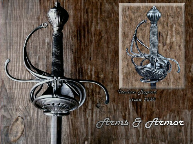

I generally agree with what most people have said here already. Though, as Patrick mentioned, I would like to point out that there are MANY non-movie based swords that not only rival, but surpass anything I've ever seen in any movie. But part of that has to do with how discerning you are. The UC LOTR sword, in my opinion, are gorgeous designs on a base level. But they lack in many of the subtle detailings that higher end swords have, such as the fine shaping of the guards, and so on. These are elements that I used to ignore until I got much more involved with sword collecting.
An example:
http://www.myArmoury.com/review_aa_ni.html
vs. this:
http://www.knifecenter.com/knifecenter/marto/quijote.html
The second example has lots of decoration on it, and there was a time long ago where I may have preferred it. But after a certain point, you grow to realize just how intricate and complicated the guard of the first one is. The bars, which appear plain to a casual glance, are well formed, with subtle swelling at just the right places, and took much more care to create than the cheaper second sword. Would I have appreciated this when I was first starting out? Probably not. But it's something that I really do appreciate now.
Another thing, though, is the feel of the sword in the hand, which is a tremendous factor to me. I don't know what the second sword feels like, but odds are they didn't put much care into making it handle like an antique sword should handle. When I buy a sword, it has to be a sword that could be dropped into a time hole and found by our ancestors, who wouldn't think anything was out of the ordinary about it. (Well, maybe I'd want them to say, "Hey, that's pretty nice!", but you get my point. Happy ) As a martial practitioner, I need that aspect to practice correctly. As a collector, I demand that aspect to know that I'm collecting a sword that is also a work of art, rather than an art piece that looks like a sword. Just my thoughts on the matter.

And by the way, while the function of the sword will always hold more in my heart than the aesthetic look, that doesn't mean I can't appreciate artistry in steel when I see it. Arms and Armor made this beauty for me (photoshopped picture courtesy of Stephen Fisher):
