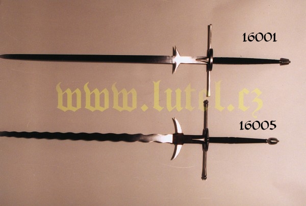

 Attachment: 71.19 KB
Lutel models 16001 and 16005

The 16005 strikes me as their most attractive large sword, with the detail in the handle, the ball-ends on the cross and the down-turned lugs (or flukes, is it?). Looking around the web I can't find much hands-on information about their two-handed swords at all, save for the smaller one, 16009. I've mailed Lutel-handicrafts in order to get a final word on shipping cost and if it still falls inside my range of resources I will order the 16005. Provided that it arrives in good order I'll be sure to give you a little review with detailed number specifications and stuff. Happy

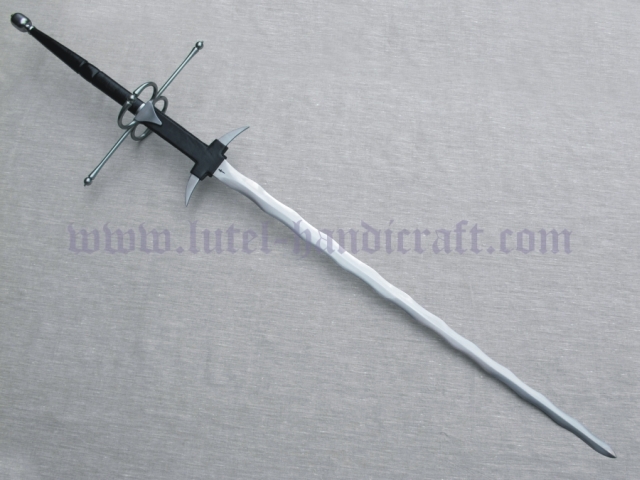

Alright, so I finally received the sword earlier today. I haven't had much time to look over it yet, but it appears to be quite well made, and it is an incredibly striking piece!
Here are some quick numbers for you to process. I've attached the catalogue image of the sword as reference. You'll have to excuse my metric measurements, although I'm sure it won't be a problem for you to convert them if you need to. Also, I'll describe the measurements from the viewpoint that the pommel is the bottom of the sword and the tip is the top of the sword.
Dimensions
Blade length from end of ricasso/just above flukes to tip: ~108cm
Hilt + pommel length: 45cm
Ricasso length (counting the entire leather-bound section): 25cm
Overall length: ~178cm
Cross width: 45cm
Side rings diameter perpendicular to the handle: 6cm
Side rings diameter at widest place (they're oval, you see): 11cm
Widthspan of flukes: 24cm
Blade width: 4.5cm just after ricasso and flukes, gently tapering to 2.5cm just before the point
Data
Weight: 3.5kg
Center of balance/gravity: ~16cm from the cross, just below the flukes on the ricasso
Center of percussion: ~58cm from the ricasso, which makes it about 73cm from the cross and 50cm from the tip
The blade exhibits an appropriate degree of flexibility (coming from one who's never held a sword close to this size before..) and it doesn't feel flimsy or wobbly at all. I ordered it unsharpened since I plan to use it in light drills with training partners, and it arrived with blunt edges and rounded-enough points.
I am quite happy with my purchase so far, although I will be pressed for time to find out anything in-depth about it at this point. Tomorrow I might get the chance to bring this beauty outside the cramped confines of my apartment. I'm looking forward to that. Cool
 Attachment: 179.17 KB

now that's a chopper, and you went with the flamberge styled blade fancy. Big Grin
i'm trying to think of the conversion of kg to lb. i can't reference anything in kg to give me an idea of it's weight. but i know the distribution of mass in these swords allows them to be really quick for their size. i'll still be looking forward to how you find the sword preforms next to what you've handled before.
Mad now i want one! actually i've been searching all over the net for a two hander but still didn't find one that was unique enough for myself. instead i'm working on plans for a custom/reproduction fechtschwert sword that seems to fit in the two hander category. once i get off this blasted night shift i hope to get the plans rolling again.
