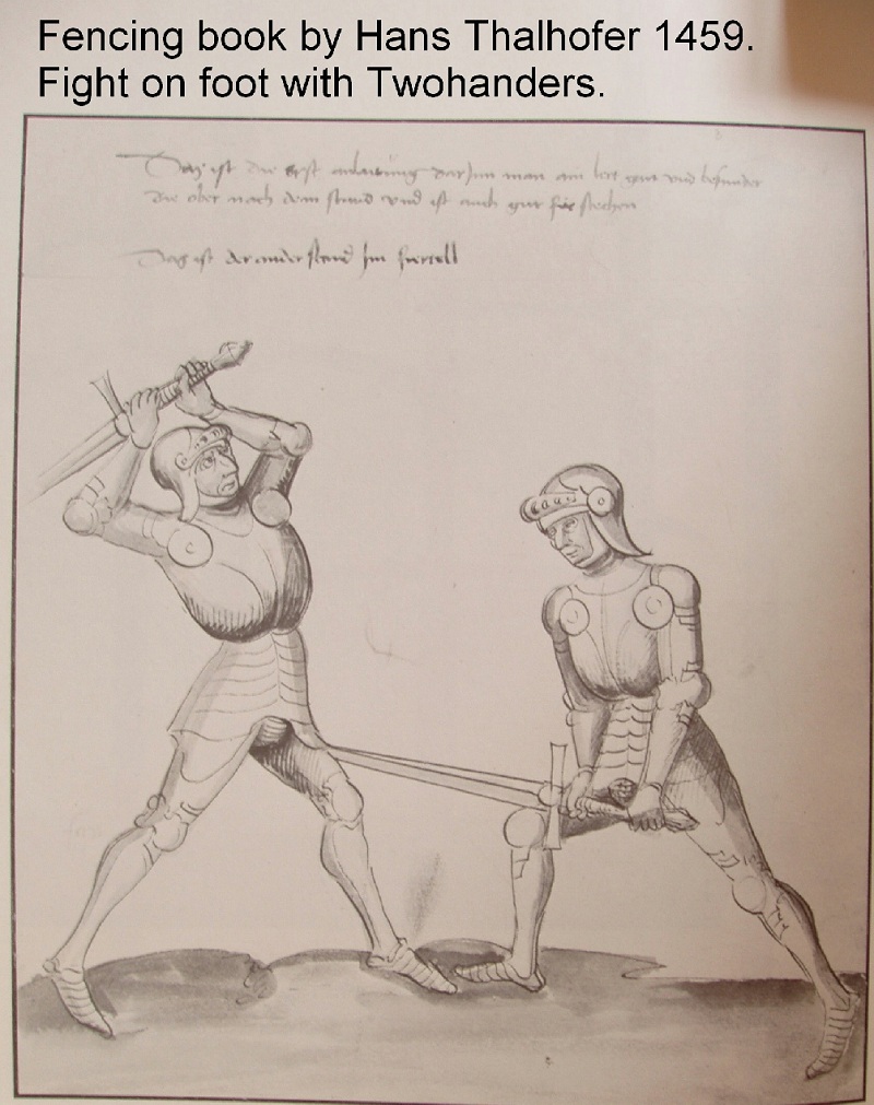

Hello!
In the Castillon find there were - if I remember correctly - 3 bigger swords. One of them weighs more than 2 kg and has quite a large blade and a long grip. I attached a photo of it. I also attached the description of the sword which names it "two-handed sword".
There's also the sword Arms and Armor based their english two-handed sword on. It weighs almost 3 kg and is quite large as well. Very similar to the sword mentioned above.
The terminology of swords has never been clear to me, what do you call a longsword, a bastard sword or a two handed sword etc.
However this sword looks to me just like some swords in Talhoffer's fencing book, which makes it a longsword in my mind. It definitely doesn't look like the montantes and doppelhanders of the 16th century.
So basically my question is, what was the function of these swords? What are they?
Now I have two theories, but i'm quite new to the world of swords so I could be very wrong.
1. They were longswords used by large men. For example, I'm quite tall, 195 cm and have big hands. Albion's Talhoffer feels small to me, there's almost no space between my hands when I hold the grip. I also feel i could handle more weight and I'd be more effective with a longer blade.
2. It was used similarly to a zweihander, pollaxe or halberd, and a secondary, smaller sword was carried on the belt.
So can someone clear up my confusion please? Happy
Thanks!

I don't have any data to back you up, but my opinion is the same as yours: these were for use by larger men. I'm only 188 cm tall, but I still feel like the Albion Talhoffer is a bit short and light for me, and I would prefer something larger.

Cool, I did not realize that that sword was so large. It is indeed like a larger version of the Talhoffer. I have had a similar experience to yours, most longswords seem a bit too small for me. I recently read an article whose author offered the opinion that WMA practitioners should use longer longswords because that makes the techniques "clearer". With the smaller swords (90cm blade) larger people can more easily disengage from the bind and are less likely to work from the bind as the manuscripts show. He offered a lot of evidence from period longsword manuscripts that longswords would be quite large in proportion to their users. I will try to remember where I saw that article and post a link if I find it. I would definitely call the sword you showed a longsword rather than a two-handed sword, but that is really just an opinion. There is evidence that swords even this large were worn on the belt, so the original user of this sword would not necessarily wear a smaller sword on his belt, but no doubt this sword could have been a saddle sword.

To throw in some more confusion, here are some images from Kal's manual.
First, a longsword in one hand, unarmored and on foot:
Second, a longsword in one hand, armored and on horse:
http://wiktenauer.com/images/d/d8/CGM_1507_12v.jpg
Third, a longsword in two hands, armored and on foot:
http://wiktenauer.com/images/f/f0/CGM_1507_25v.jpg
Fourth, a longsword in two hands, unarmored and on foot:
http://wiktenauer.com/images/4/49/CGM_1507_59r.jpg
Swords on the first 2 pictures look very similar, but swords on the other 2 are distinctly different. On the 3rd picture pommels have spikes and on the fourth there are schilts. Note that these are not federschwerts since their points are acute. One can't make any conclusions regarding size or proportions of these swords because Kal shows very different sizes and proportions on different plates, I suspect he simply didn't care about them, but the general types seem to stay constant. I think that there were "longswords" designed for both 1 and 2-handed use as well as "longswords" designed mostly for 2-handed use, sometimes to the point where using such sword 1-handed is impossible except for some occasional strikes and deflections when the other hand is busy for example holding opponent's arms. And for unarmored training and duels mostly the latter ones were used. A mounted man at arms would expect to use his sword mainly one-handed while on horse so he would choose a sword more suitable for 1-handed handling.
One funny thing that I just noticed when previewing this post is that "rainguards" are different on plates showing armored and unarmored combat. On "armored" plates these are tubular, while on "unarmored" plates rainguards are simple semicircles on both sides of the blade. These seems to be so for all other plates as well, at least for the ones I checked.
